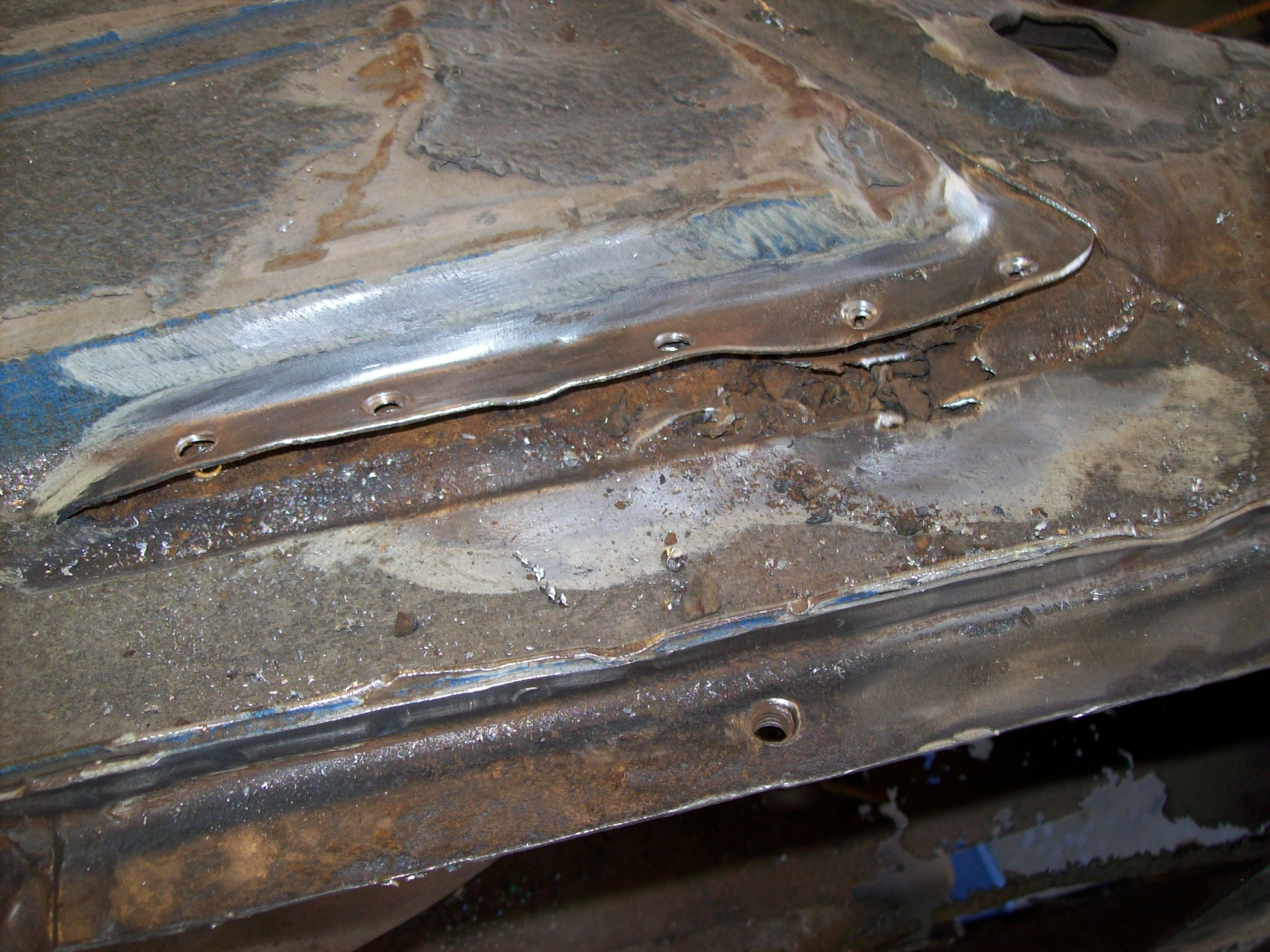

New to the board. Most of my work and experience is over on Pelican with 911 longhoods. I stalked a local PCA guy who was going to eventually sell his 914-6. No pressure, just every few months I let him know I hadn't forgotten. Finally got a chance to see the car in person three weeks ago. Passenger rocker issues as well as surface bubbling in a number of places. Car had been extensively autocrossed at PCA parades for years...very successfully. Owner had pulled the original 2.0 and replaced with a 2.7 RS spec engine with carbs. He bought another mid-engined car (boxster) and ignored the 6. I bought the car (w/ 2.7) and original engine. Got the 2.7 running well enough to drive the car...and decided to dive into the resto. I am familiar with rust, and plan to do it correctly. I have a rotisserie with 911 mounts, but shouldn't be a big deal to make mounts for the 6. Made a couple calls to Resto Design to check on parts...and away I go. I have a 71 911 softie that has been at paint too long...so while I wait for it to come home, thought I would see what my sandblasters schedule was. Turns out he can do the car in two weeks. So, I have a deadline. So...I guess this is my resto thread on my new Adriatic Blue 6...
I took a few hours Friday afternoon,a couple yesterday, and a few more today. Almost ready for the blaster
yuck...passenger side. Drivers side looks ok. Before you question...yes I do have some hell-hole issues.
More later...

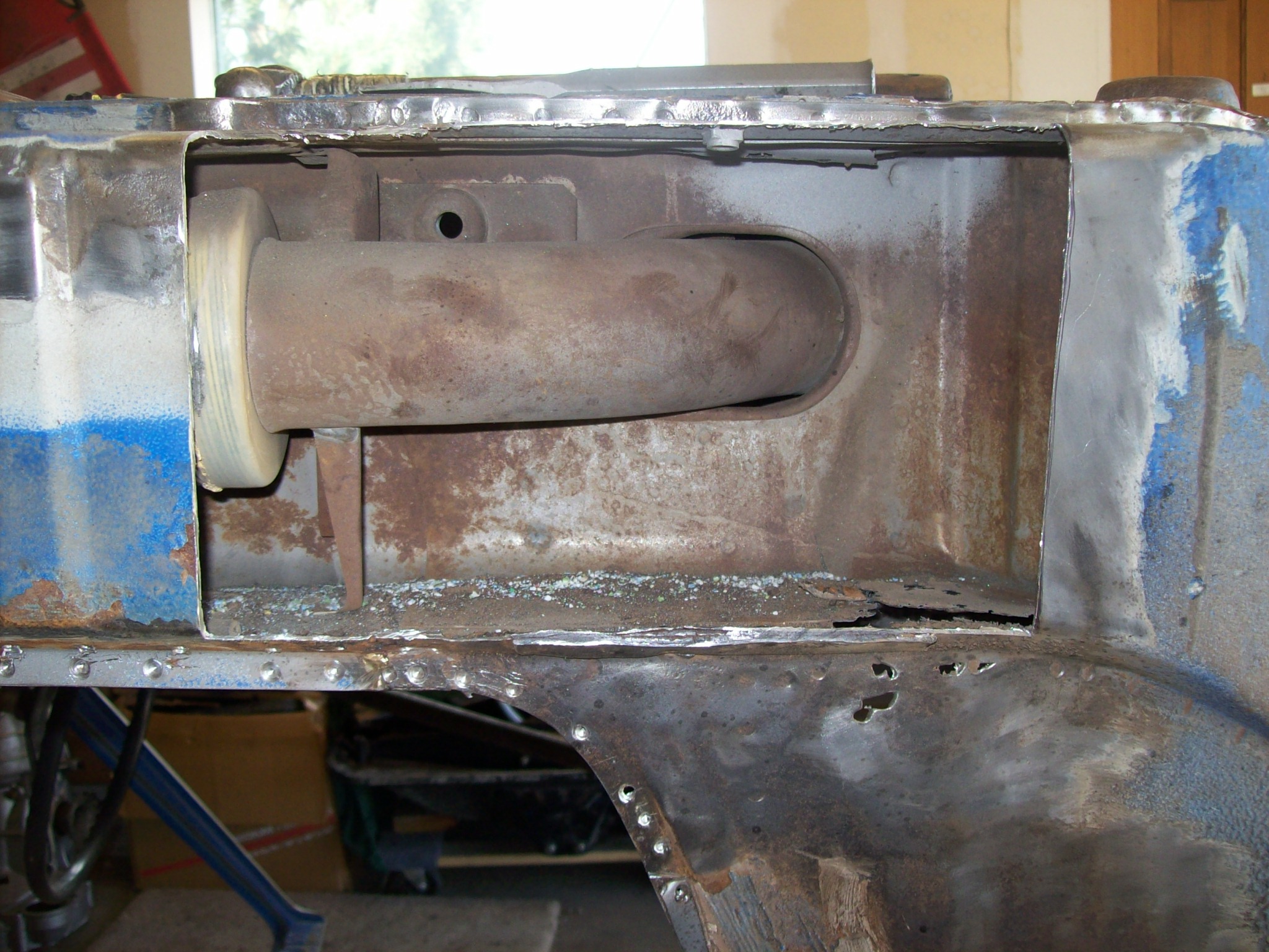

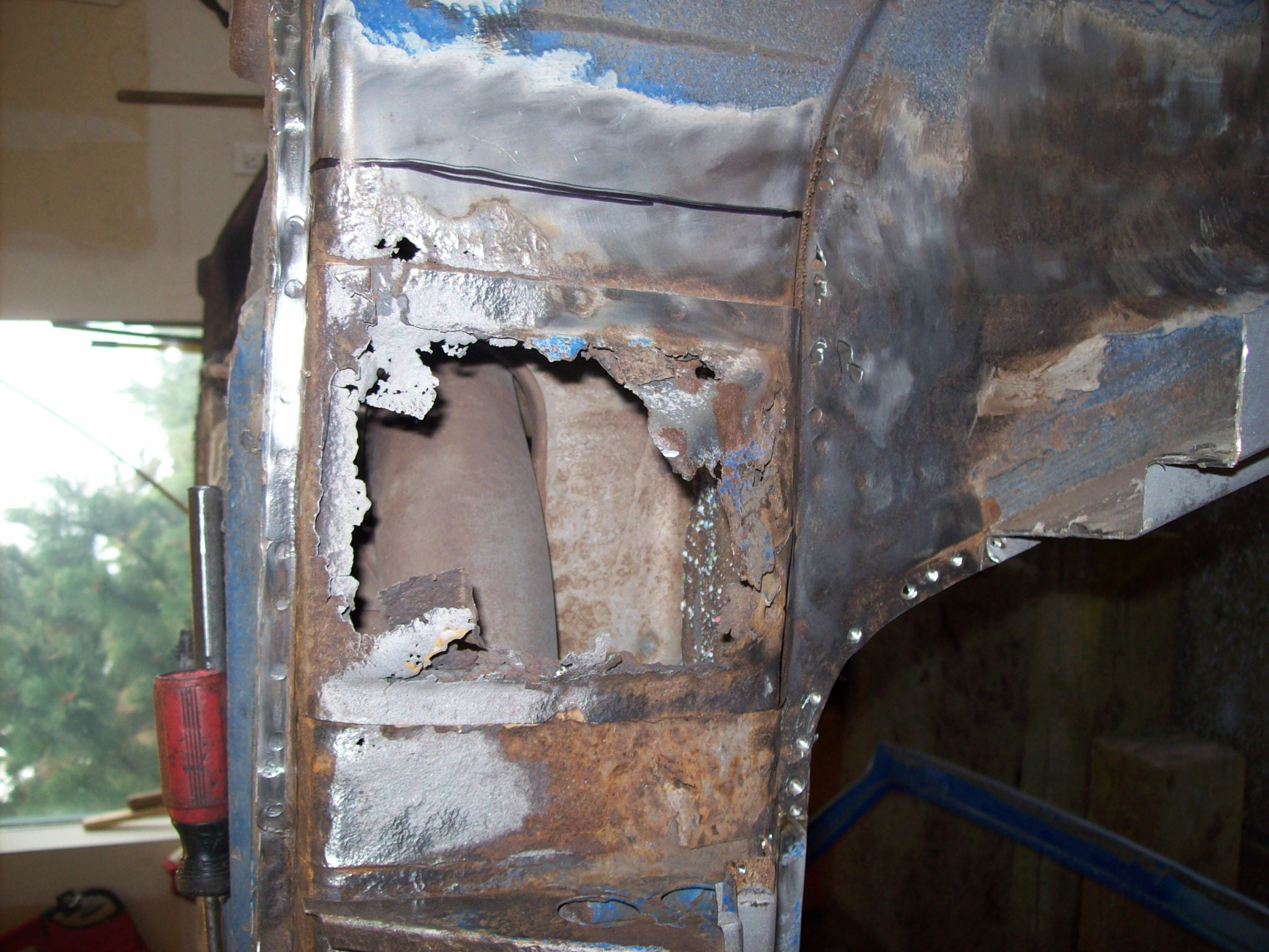

It is going to get worse before it gets better...so I invested in some 1/4 inch cobalt bits for the spots I am going to drill out. Hard to see how much is bad, and how much access I will need to create...but I have to start somewhere. first pass at the passenger side rocker (upsidedown). Still not sure why the picture wants to lay down when the file on my computer has been rotated 90 clockwise...good excercise for our necks...
And we end up with....

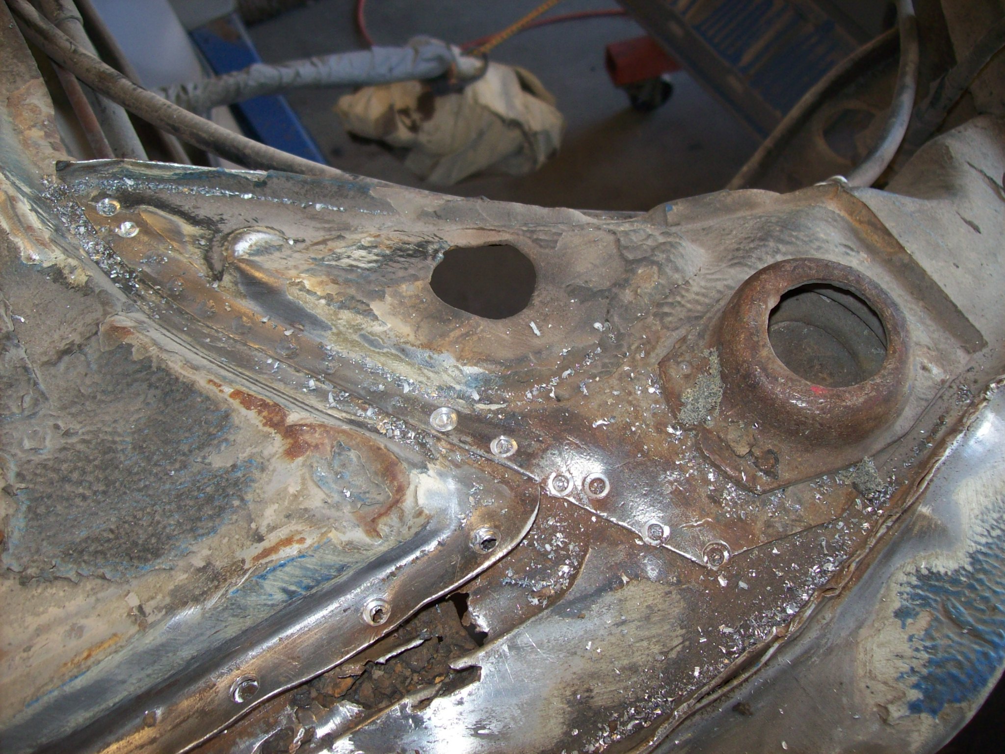

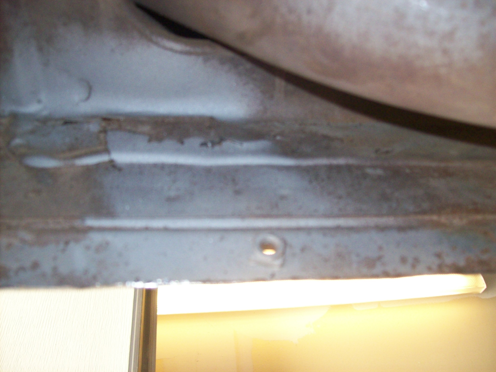

Something here caught my eye....so I started digging
This is a doubler on the bottom of the longitudinal. It was created in the over lap from the inner side of the longitudinal overlapping the outer. and there is a tiny channel that is created. Anywhere a cavity exists, moisture (can) gets in and the reaction begins. This is looking at the overlap area from the inside of the longitudinal which would be the top of the channel Really hard to see, but the area is about 2-3 inches long, an inch wide and very weak.
I will dig into it repairing the underside first, then do the other layer from inside the longitudinal. Start to create some room. There is a lot going on back here. Have to approach it like peeling back the layers of the onion...and sometimes you do feel like crying (IMG:style_emoticons/default/hissyfit.gif)
