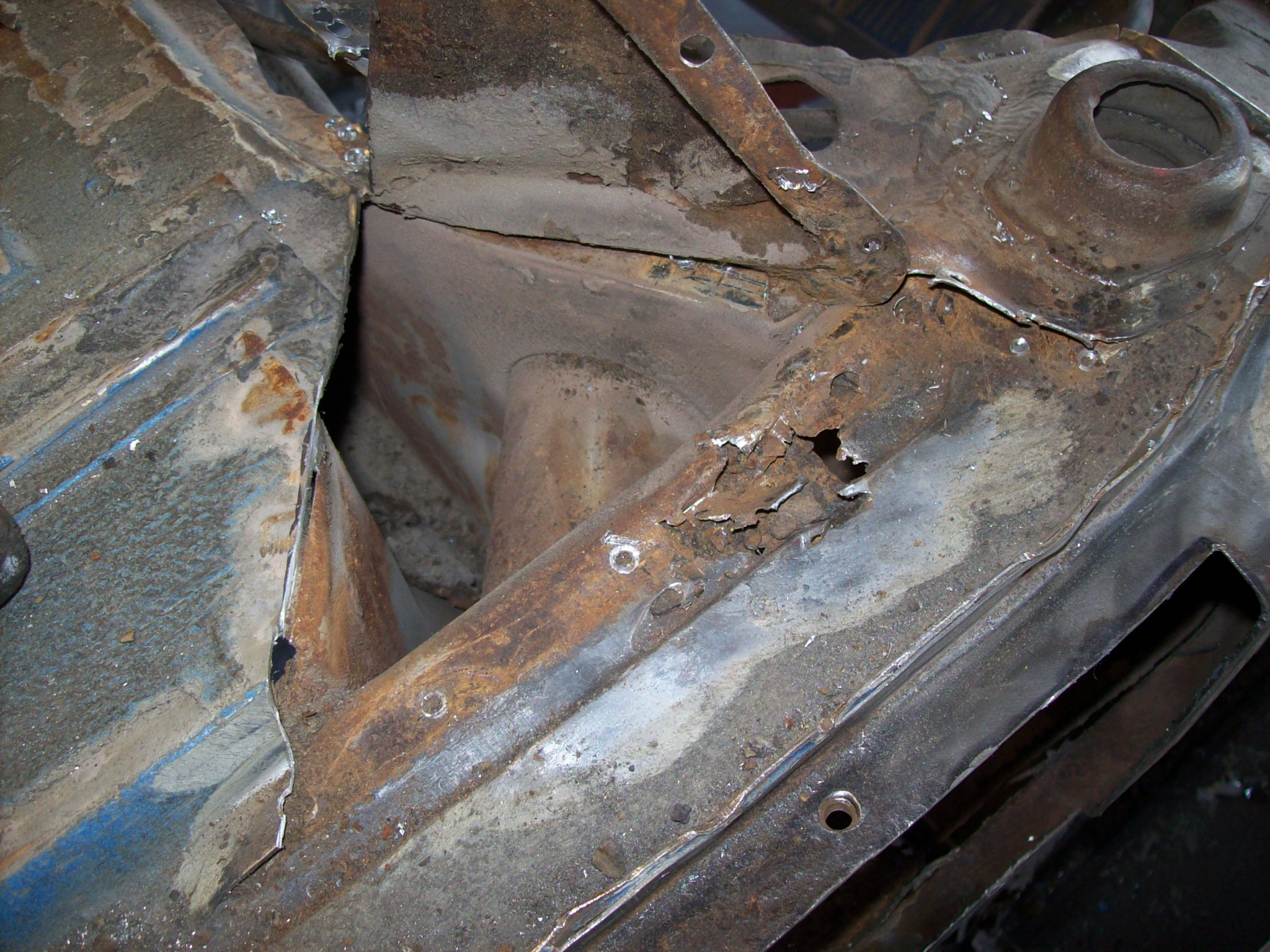

It is what it is.....I am going to just open this up

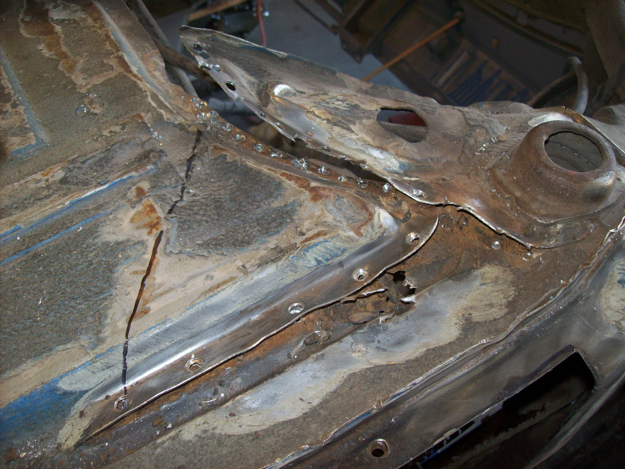

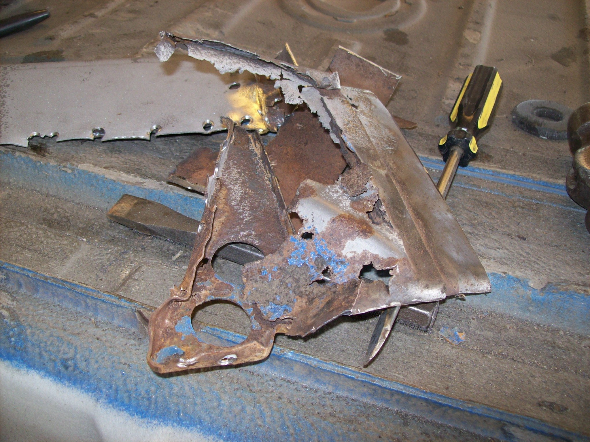

Could be worse. I will section out the bad and weld in the good and that will take care of the bottom. Top will get done from the inside. The small pile of the good the bad and the ugly.
I can treat this area and get ready to close it back up.

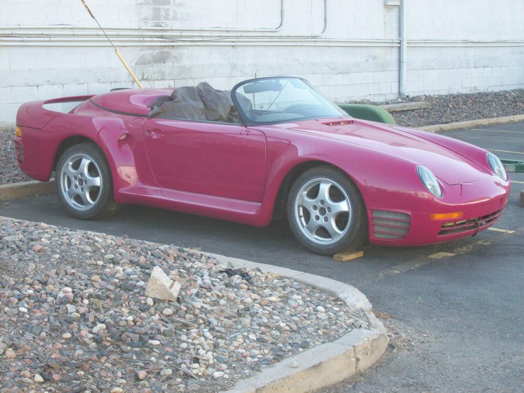

Just found out that my mig wire ran out. Helped a buddy weld the rear door on his old jeep back together. Thought I had an extra roll, but it turned out to be flux core gassless .030 and I run .023 with gas so it is off to the hardware store at 5 pm on a Sunay afternoon if I want to do any welding tomorrow. On my bumper run to Denver (gathering up my cores to drop off for rechroming) on Friday, I spied this beauty "barney" in S. Denver. Seriously...a right hand drive fiberglass 959 convertible...really? I had anything to eat yet...fortunately. (IMG:style_emoticons/default/lol-2.gif)
