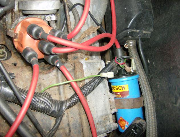

Also, I found this unused (green) wire, but I was guessing it was from the condensor that was pulled out for the CompuFire ignition (IMG:style_emoticons/default/confused24.gif)

tim_nd   Nevermind that green wire, this wire isn't cau...   Sep 3 2012, 10:03 AM
