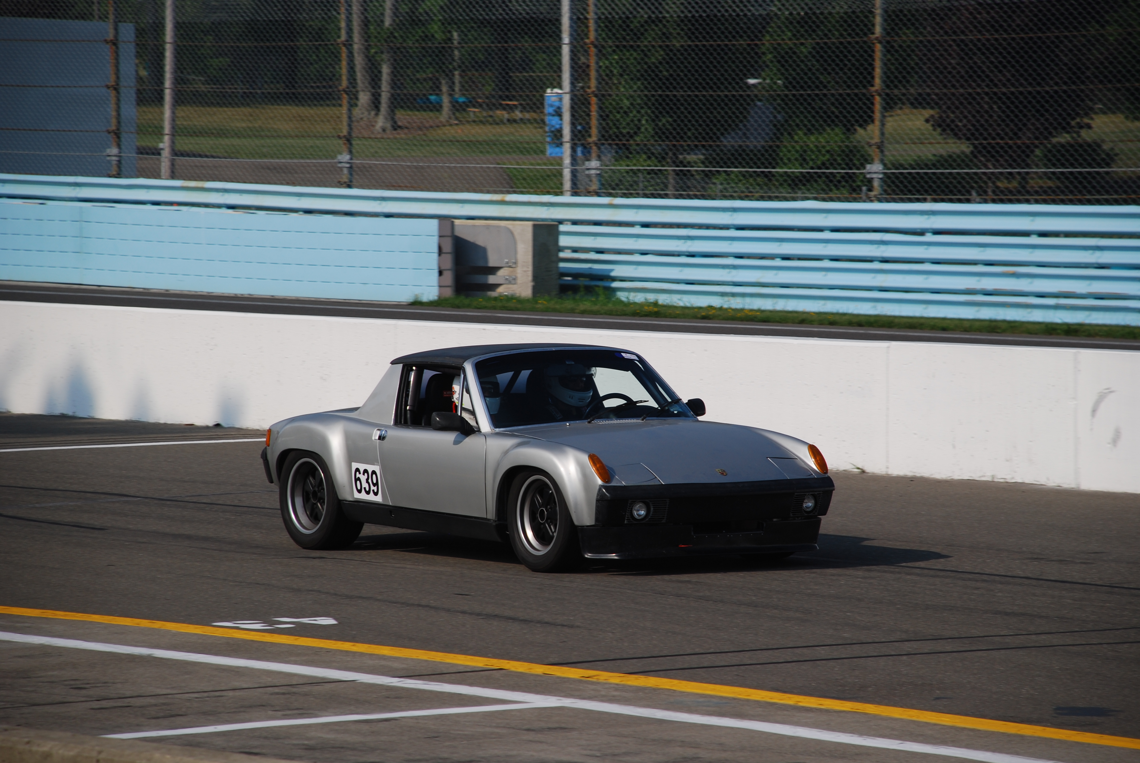

A good shot of Tom at WG.
That car is amazingly fast now, no small part owed to Tom's driving.
