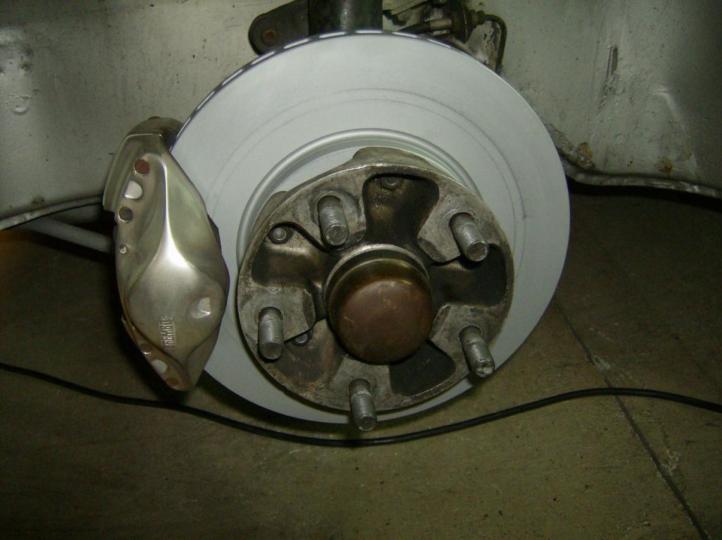

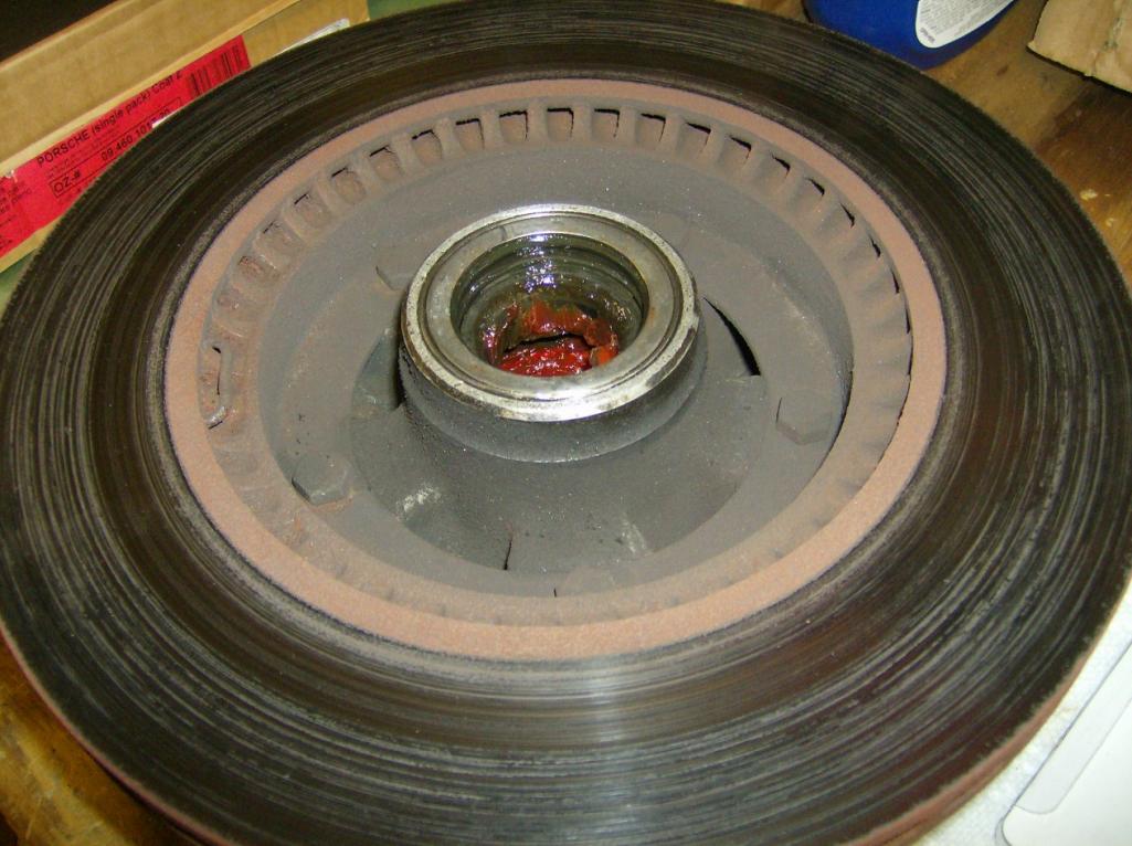

Going faster means I need to scrub off more speed too. As I mentioned in another thread, this resulted in warped rotors. The low front air dam does its job well keeping air from under the car, but unfortunately blocks airflow to the front brakes. It was amazing how hot the front fenders got!

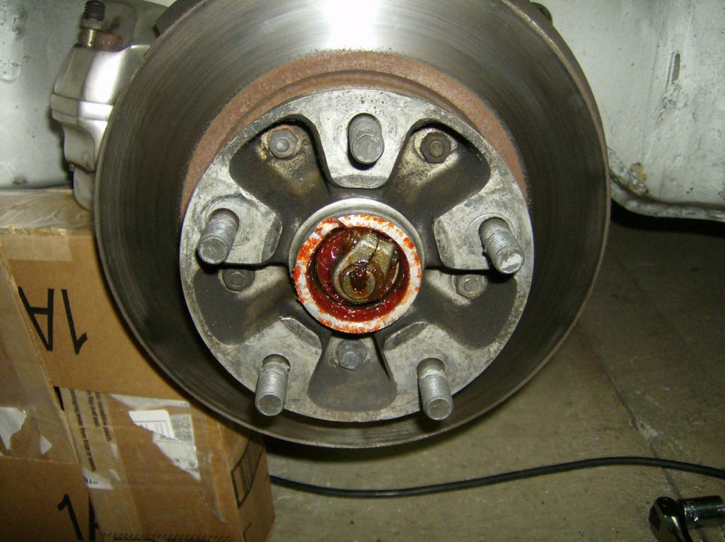

So first, get the old rotors off

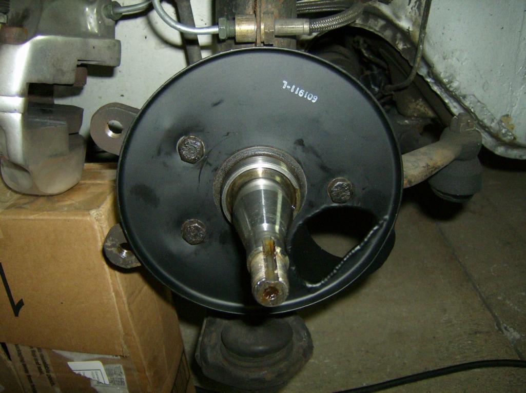

Clean up the spindle and remove the original backing plates
Put the new AJ ducted backing plates on

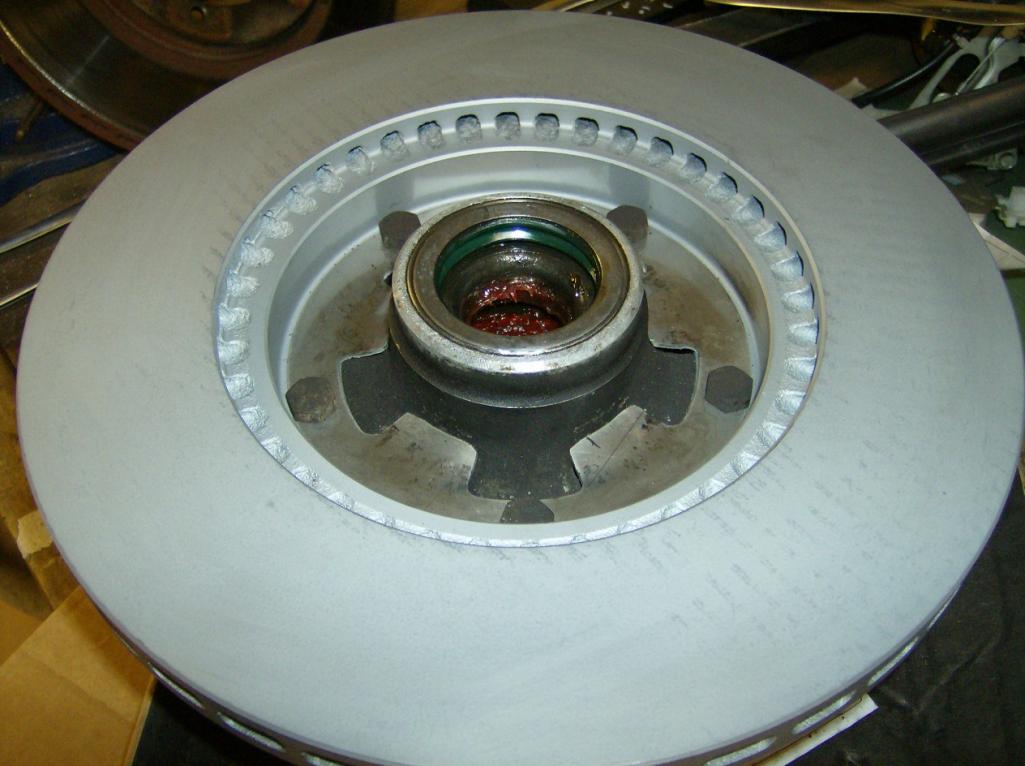

Disassemble the rotor from the hub

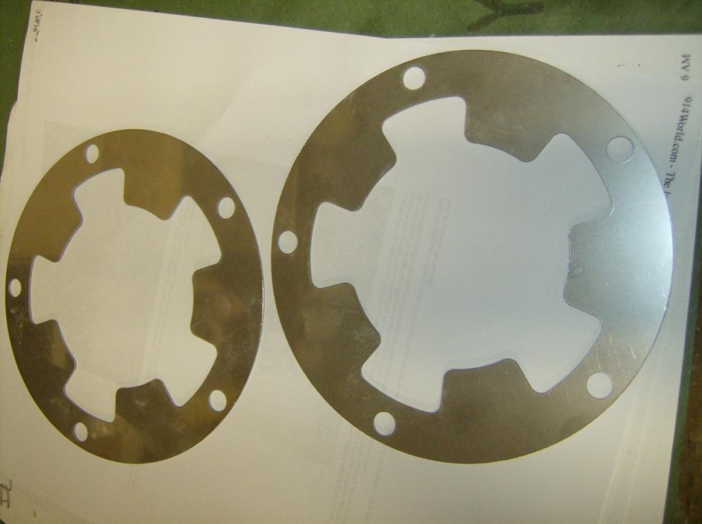

Smart racing is no longer and I couldn't find the air blockoff plates so I drew my own on AutoCAD from dimensions found online and had them waterjet locally out of stainless.
Install the blockoffs and massage them a little to fit just right
Put the rotor back on and massage the ducted backing plates to fit just right. BTW, the DAPO put the front wheel bearing seals in backwards. I didn't have new ones to put in so those pictured here are installed incorrectly!
Put it all back together and drive it
I found Zimmerman rotors on www.partsgeek.com for a decent price and free shipping.

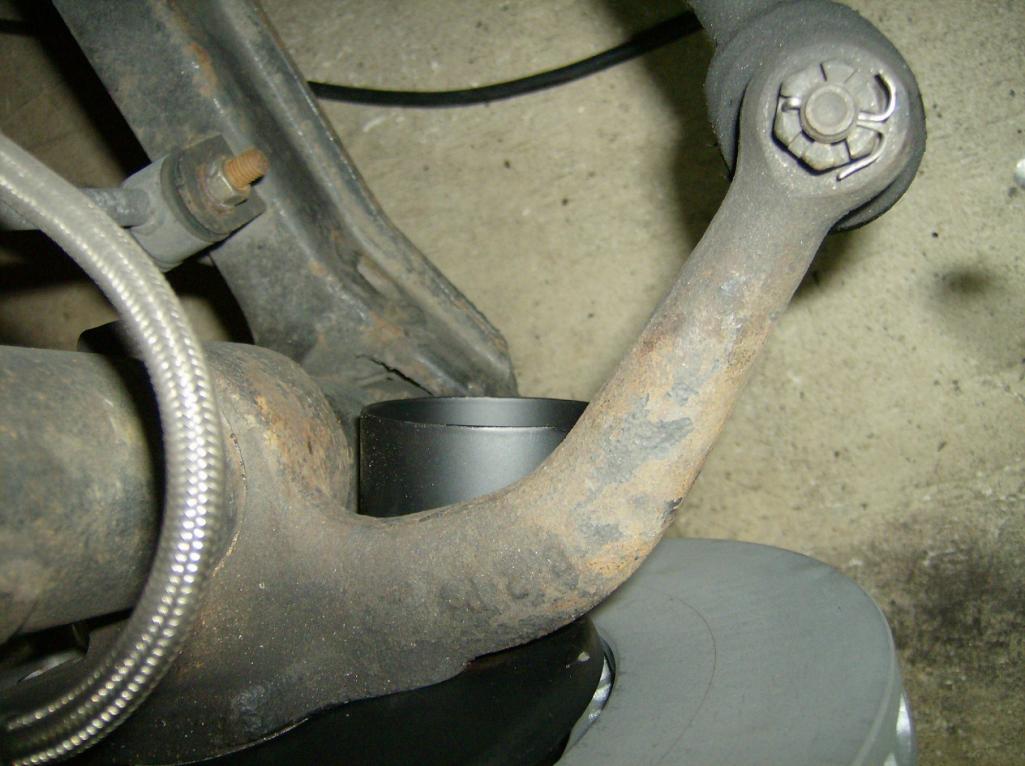

Next is to fabricate some duct manifolds for the A-arms and purchase some not so cheap silicone or neoprene duct.
