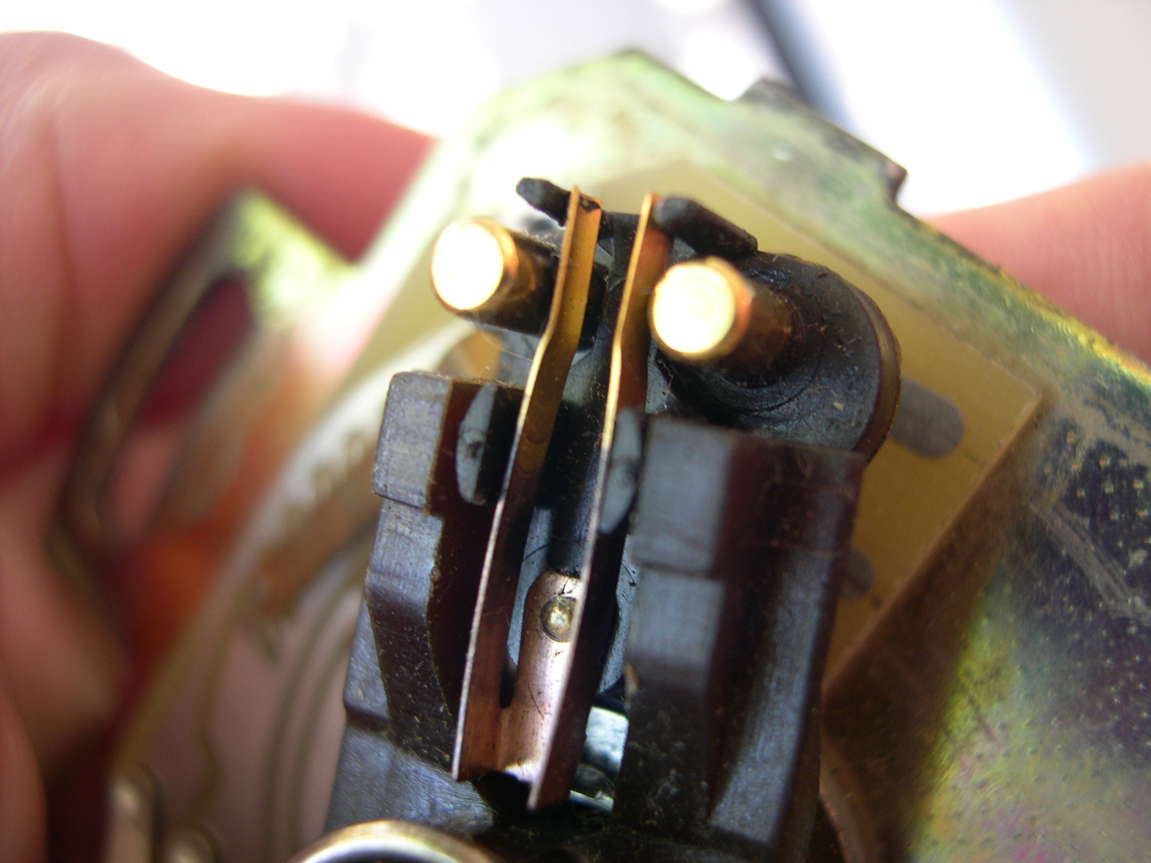

I have a 2.0 D-jet setup. The classic bucking at constant speed. I have disconnected the TPS and the car runs super smooth with no bucking at all. The board has been replaced with Dave's board. I have adjusted it as per the pelican article. I have searched and searched. I printed the picture out of what it should look like before you put the cover back on. My adjustment is perfect. My TPS is adjusted right where it should be BUT is still Bucking

I contacted jsayre regarding the behavior of his TPS with my replacement board. He sent me the TPS and I debugged its problem. The issue was corrosion on the post in the shaft of the sensor, which prevented a good connection with the leaf-contact and would never allow the sensor to detect the idle position. I dragged some 2000 grit sandpaper between the contacts. According the jsayre, this fixed the problem. I've attached a picture of the post and the leaf-contact.
