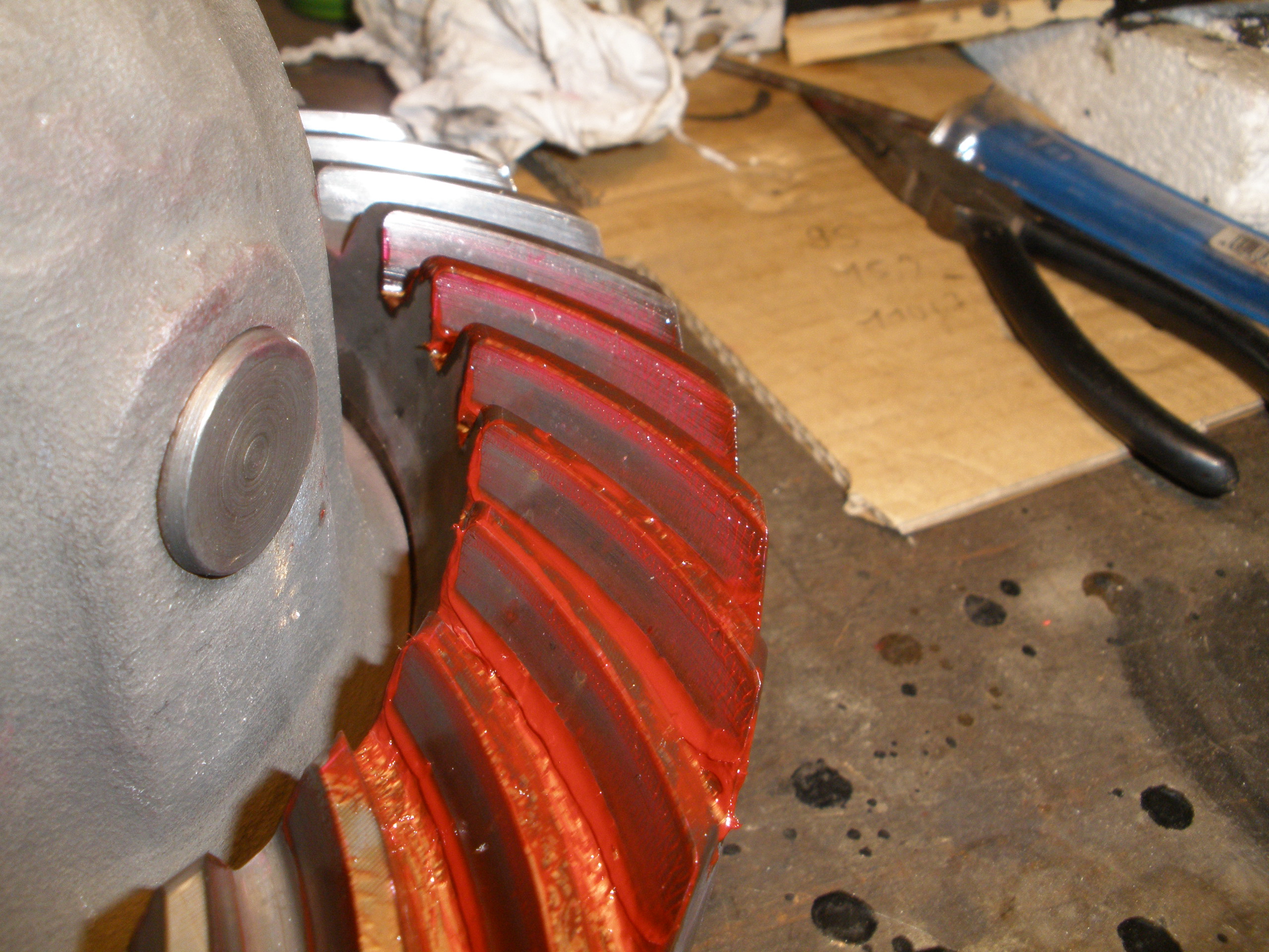

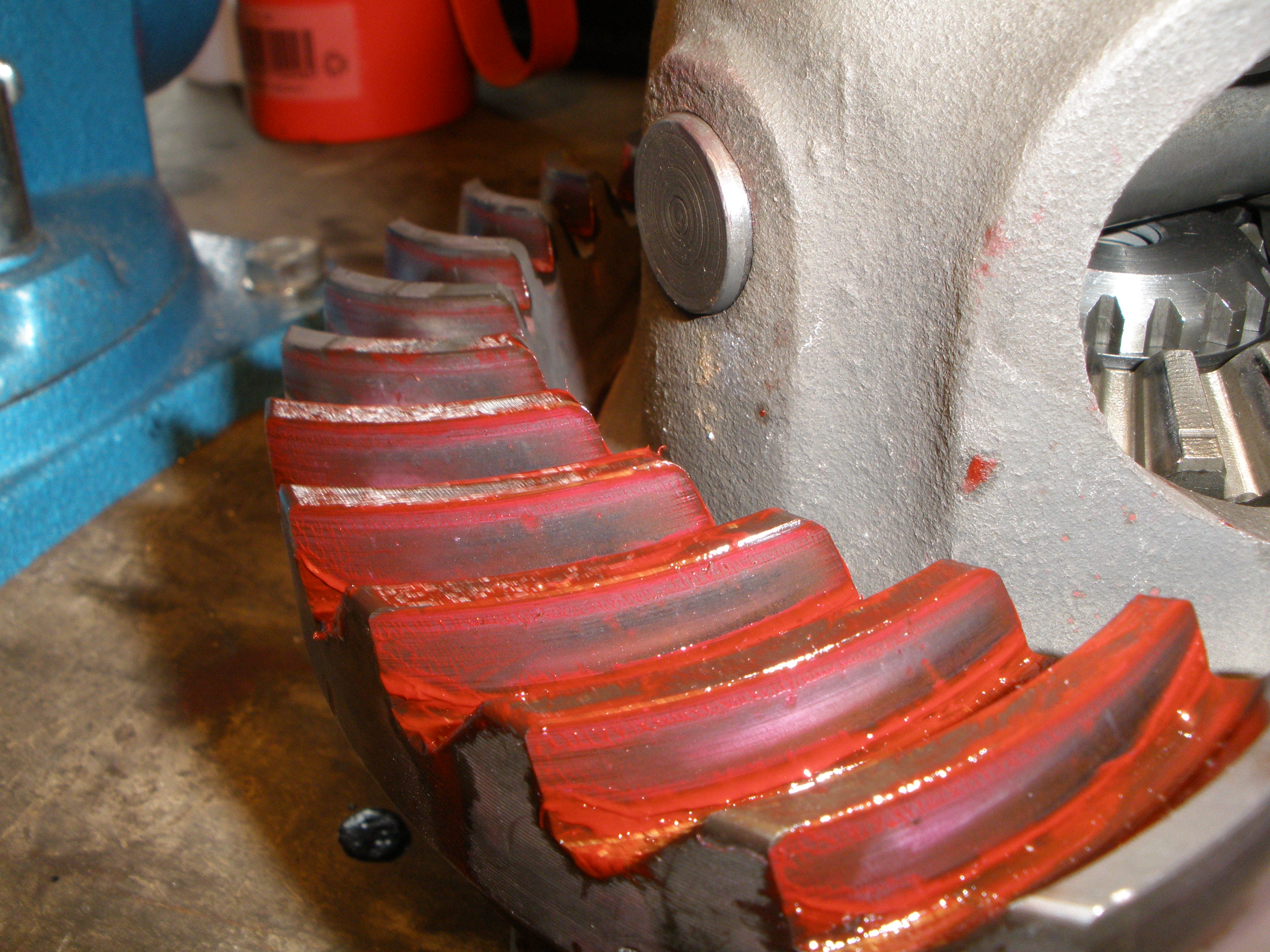

more pictures from my transmission rebuild. I made a contact pattern of the ring and pinion, the pattern is just made with hand load. The measured backlash is 0.16mm. I always put the dye on the ring. I gues the R&P is a Gleason style and not Klingenberg.. hope so.
What is your opinion about this contact pattern, can I go with this?
This is my first setting, I made a scound one, see next post

914Gelb   more pictures from my transmission rebuild. I made...   Sep 10 2012, 12:15 PM
914Gelb   2nd option of S&P setting. Pls. tell me y...   Sep 10 2012, 12:23 PM
914Gelb   I bought the tool (VW 385)to measure the pinion de...   Oct 11 2012, 12:53 AM
