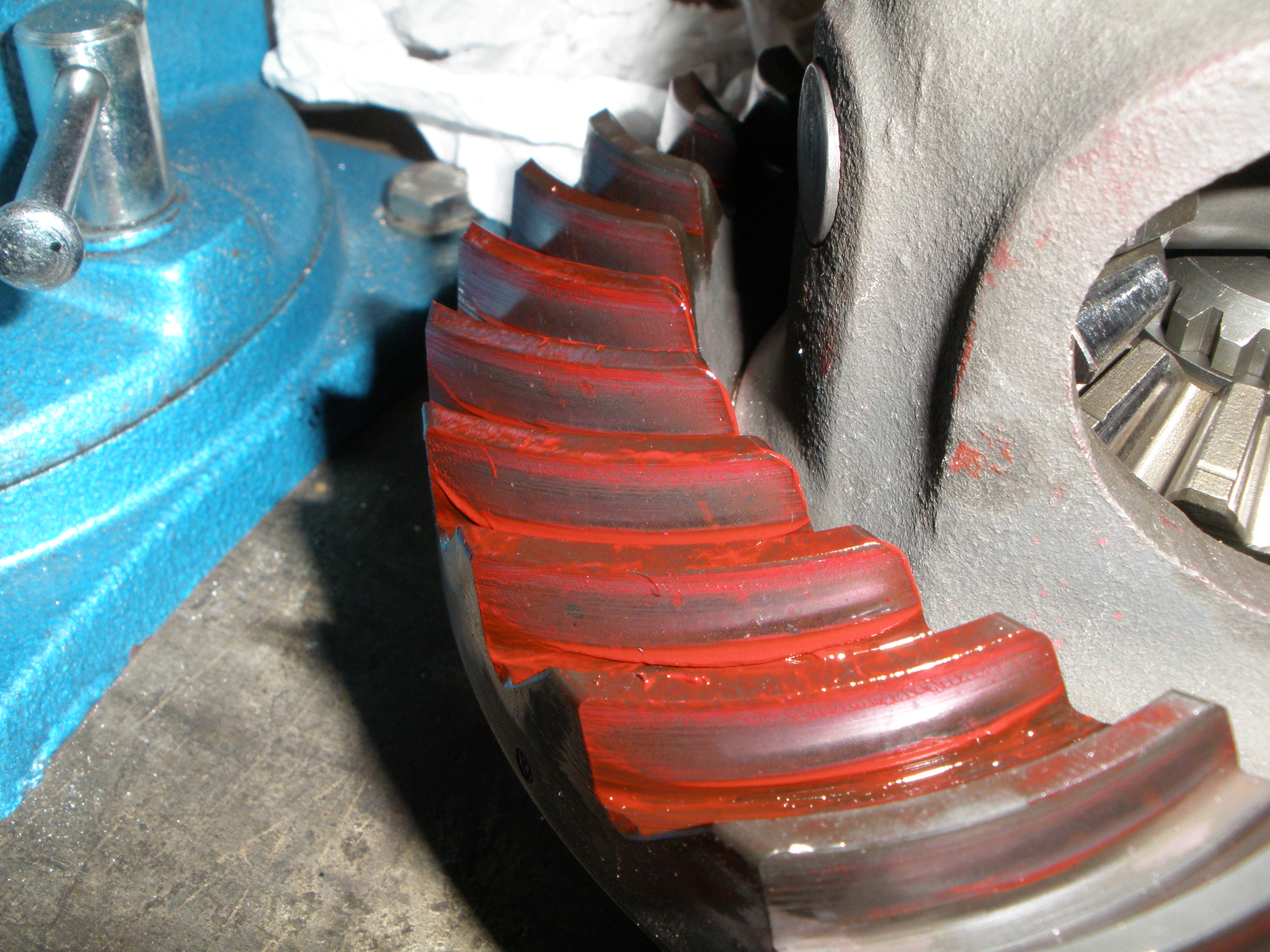

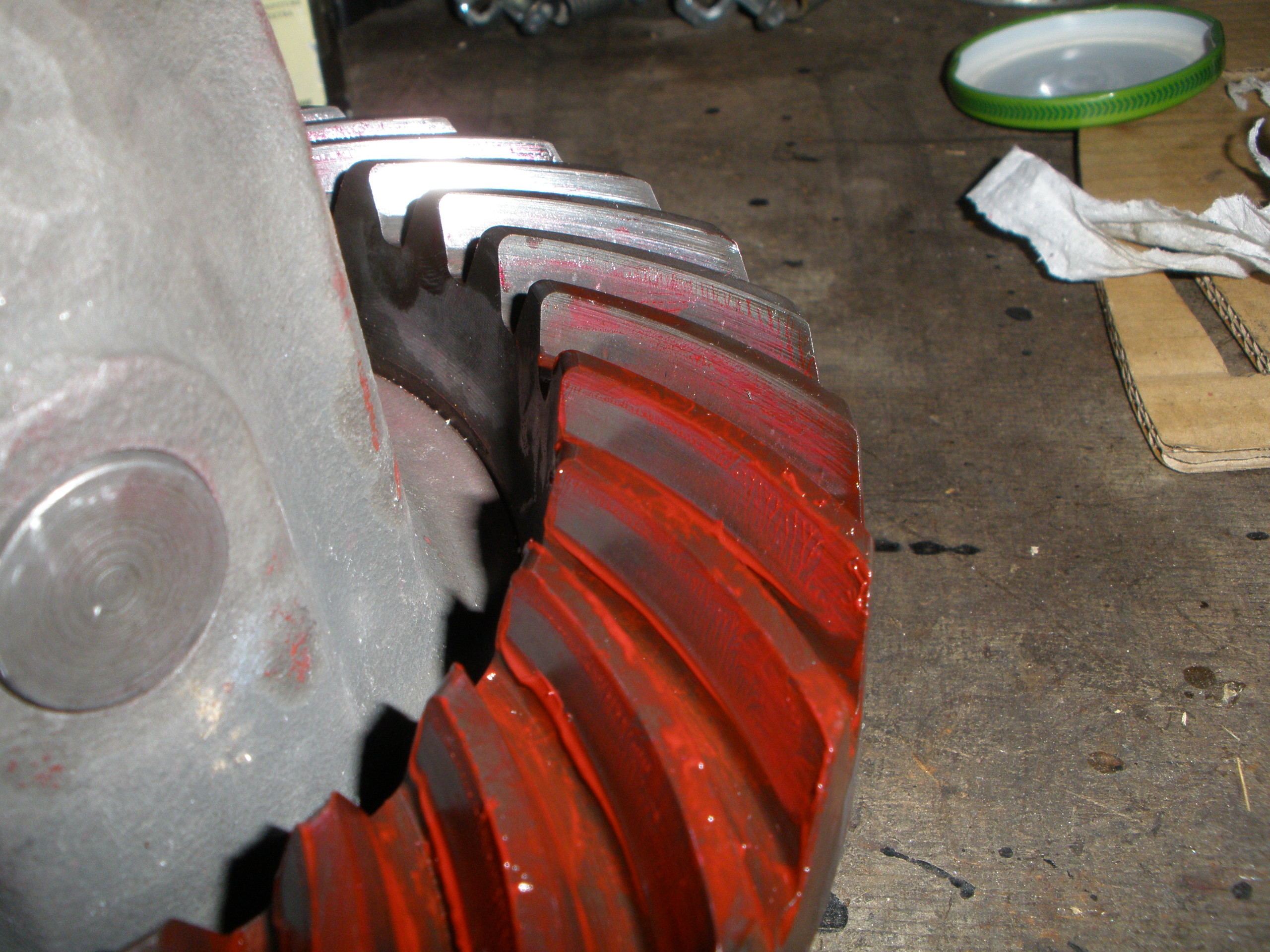

914Gelb   more pictures from my transmission rebuild. I made...   Sep 10 2012, 12:15 PM
914Gelb   2nd option of S&P setting. Pls. tell me y...   Sep 10 2012, 12:23 PM
914Gelb   I bought the tool (VW 385)to measure the pinion de...   Oct 11 2012, 12:53 AM
Cairo94507   That is a beautiful transaxle you have there. Con...   Oct 11 2012, 06:51 AM
rjames   wow. Nicely done!   Oct 11 2012, 10:43 AM
Dr Evil   Good job, Georg :thumbsup: What was the price for ...   Oct 11 2012, 11:25 AM
914Gelb   Hello, the price was match more than 400. The too...   Oct 11 2012, 11:13 PM
Cairo94507   ....oh no....he wants to see the Doc's tool......   Oct 12 2012, 06:43 AM
Dr Evil   My tool is made out of an old differential and was...   Oct 12 2012, 03:12 PM
