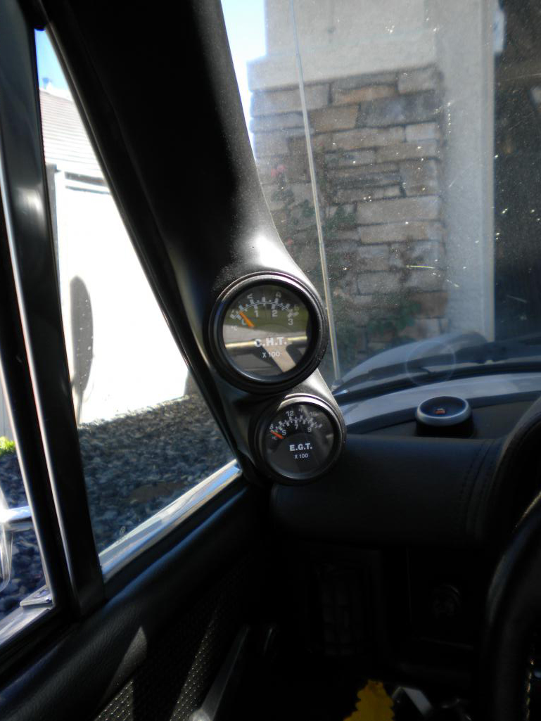

Here you go!

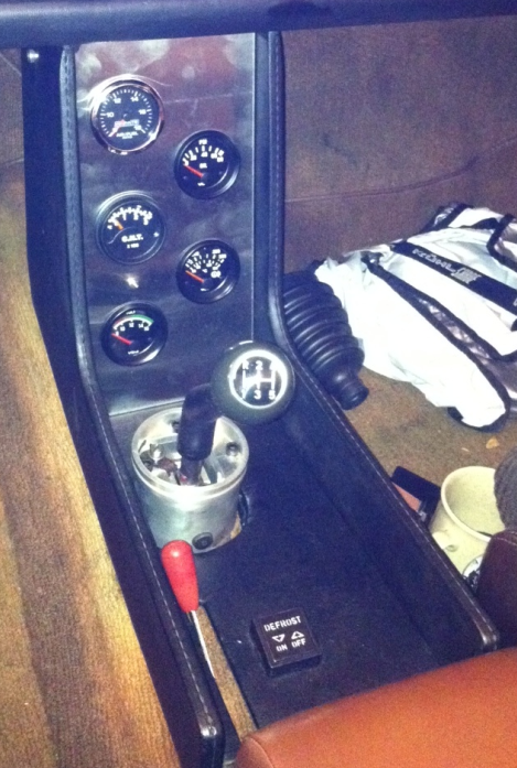

Here's mine (pardon the crappy iphone pic).
This works fine in the console but is better suited to the A pillar IMO.
An invaluable gauge that's short money...replace your broken clock with something useful! I think this gauge is a requirement if you've performed any modifications to your engine.

Great looking console .... (IMG:style_emoticons/default/smile.gif)
