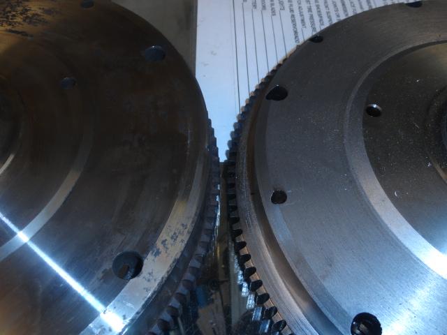

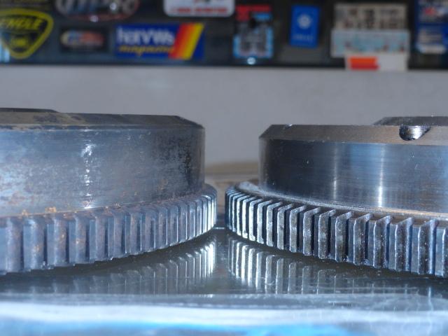

Ever since installing the 5-speed, I was forced to go back to using the stock Porsche flywheel. It's a nice forged piece, but damn this thing is boat anchor @ 17+# compared to the conversion flywheel I had on it that weighed in at about 12.5#. Believe it or not, when I had to switch back to the Porsche flywheel (due to installing the Porsche 5-speed), I also upgraded to the larger P&C set upping my displacement 85cc and the car got a bit SLOWER. . . This COULD NOT STAND!! So I did some calling around and found a local place to lighten a spare Porsche flywheel I had laying around. They were able to conservatively shave a full 5.5# off and still leave me tons of meat on it. I'll bet they could have gotten another 2# if they had not conservatively done it. Next time, I'll tell them to go crazy with it!!
(IMG:http://www.914world.com/bbs2/uploads_offsite/images.thesamba.com-9730-1348070677.1.jpg)
(IMG:http://www.914world.com/bbs2/uploads_offsite/images.thesamba.com-9730-1348070678.2.jpg)
I'm SUPER happy with the results. Instead of using HP and torque to spin that heavy flywheel, the motor can now put that lost energy to my tires, and these things are gonna pay for their past 6 months of laziness. :twisted: The car is MUCH quicker getting to a given speed. It's lighter, but not so light that it is jerky to drive and still drives like stock. Coincidentally, I had the opportunity on the way in this morning to test the added acceleration against a guy in a winged H*nda fart-car. I don't think he ever had the chance to see that I have a blue trunk lid that doesn't match the rest of the car. . . (IMG:style_emoticons/default/laugh.gif)

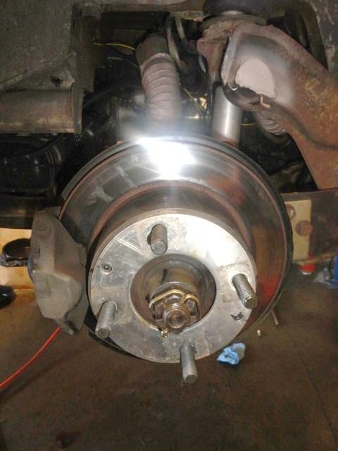

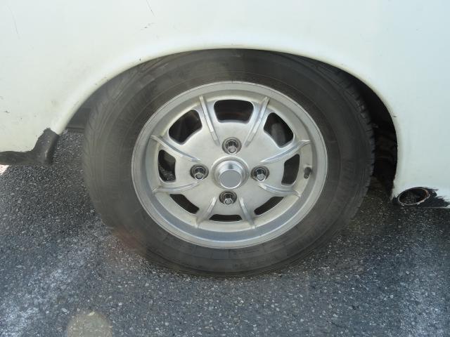

I also removed my rear hub assemblies and modified them for Porsche 930 press-in wheel studs. One thing VW really missed the boat on is using wheel bolts instead of studs and nuts. I only did the rears for now since I'm planning to change the entire front-end this winter. Instead of using steel nuts, I modified a set of Porsche alloy nuts on my lathe for use with the long studs. Now tire changing will be a breeze. Especially since I have to use 1/4" wheel spacers on the back. What a PITA to hold the wheel AND spacer when using the lug bolts. . . :evil: BTW: the photo makes it look like the lugs are not pressed in straight, but that is just an illusion due to zooming in for the photo (I blame the jerk behind the lens (IMG:style_emoticons/default/laugh.gif) ).
(IMG:http://www.914world.com/bbs2/uploads_offsite/images.thesamba.com-9730-1348070678.3.jpg)
(IMG:http://www.914world.com/bbs2/uploads_offsite/images.thesamba.com-9730-1348070679.4.jpg)
