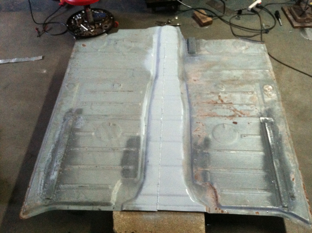

(IMG:http://www.914world.com/bbs2/uploads_offsite/i163.photobucket.com-12156-1348107611.1.jpg)
Floor put together....

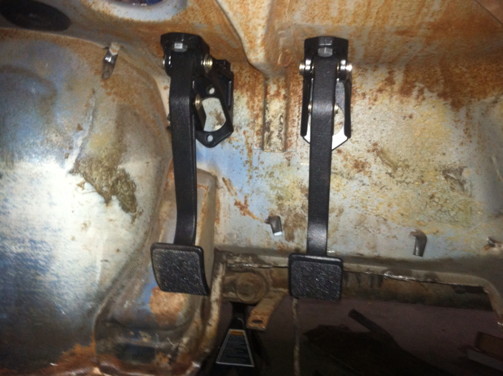

Figured out how to mount my pedals....

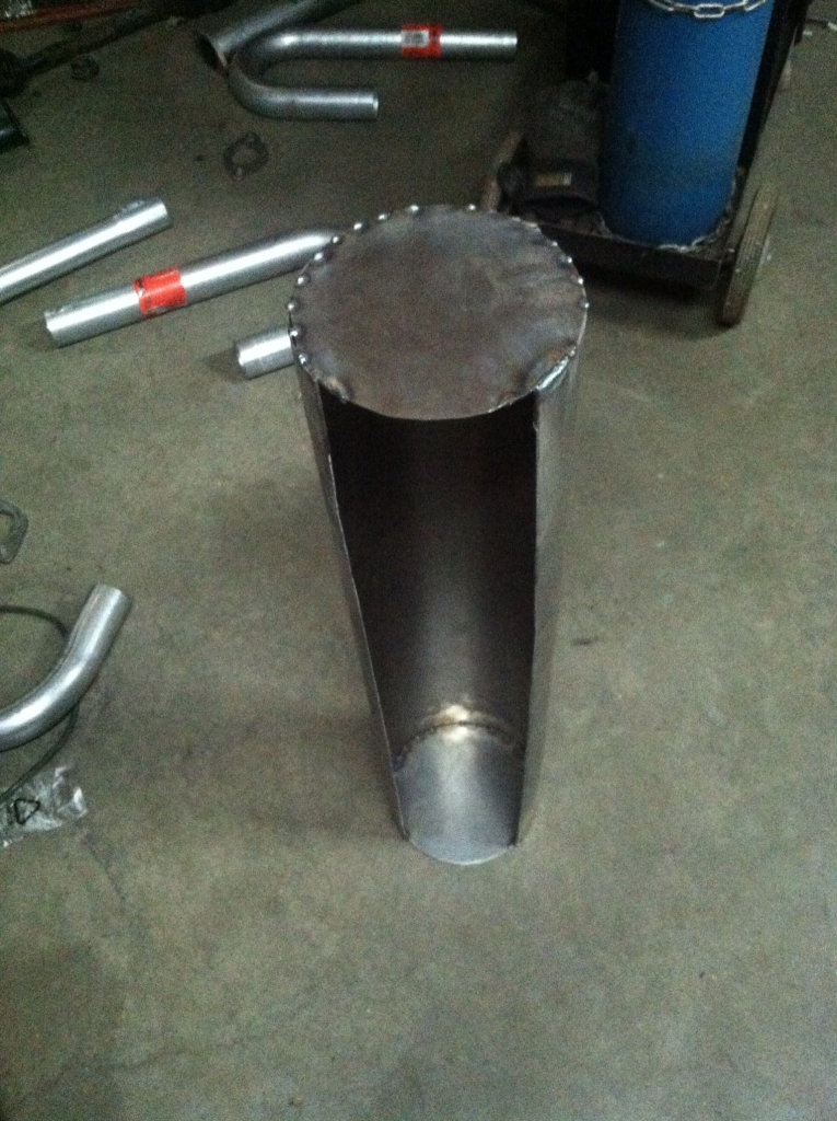

Started this strange thing... What the heck is it?
