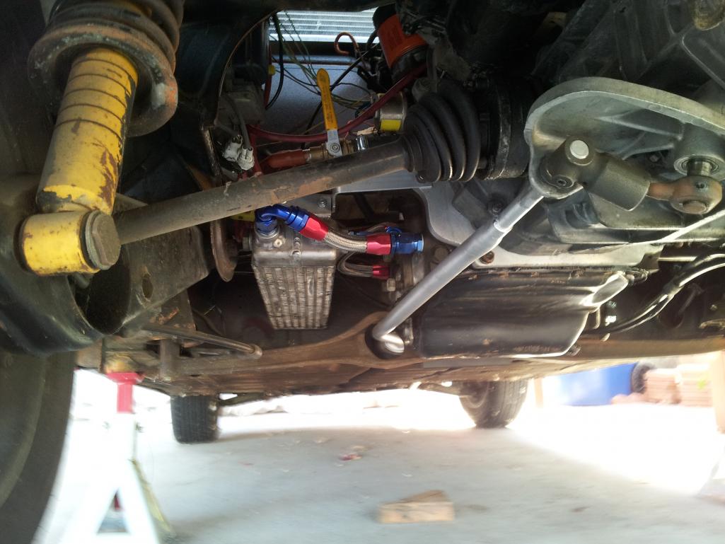

Rotary'14   This is how I am mounting my oil cooler. The PO o...   Oct 23 2011, 06:15 PM

Rotary'14   Nice !! You tell Us , Does it work ?? I...   Oct 23 2011, 06:20 PM
