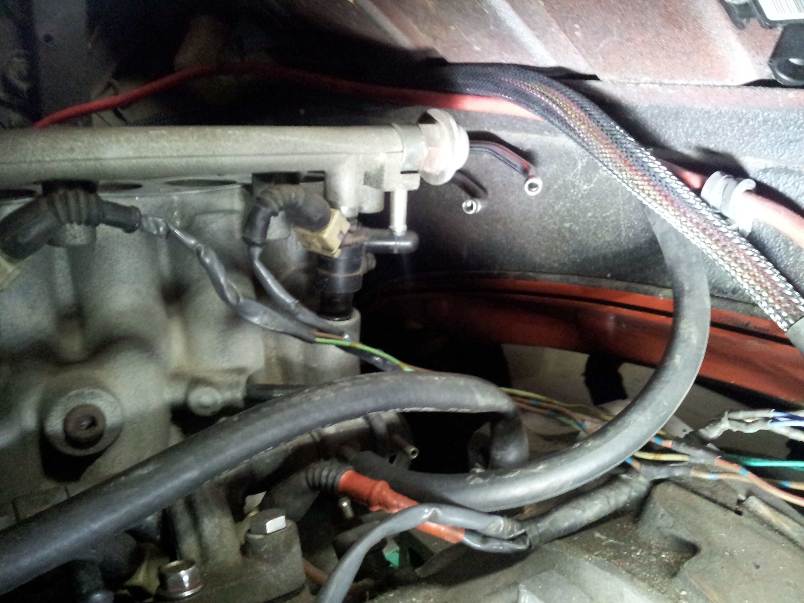

Rotary'14   Here's a long overdue update on the cut-less c...   Oct 1 2012, 08:33 PM
Rotary'14   Engine bay fuel lines,,   Oct 1 2012, 08:39 PM
Rotary'14   Engine side,,   Oct 1 2012, 08:41 PM
