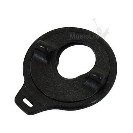

Here it is... make the hole big enough to fit over the existing floorboard peg and twist and lock.

QUOTE(Eric_Shea @ Oct 9 2012, 07:00 PM) *
(IMG:http://www.914world.com/bbs2/uploads_offsite/www.musiclo.com-1110-1349838042.1.jpg)
Sorry Eric. I must have been having flashbacks of my previous "rocker" lifestyle. (IMG:style_emoticons/default/aktion035.gif)
I didn't think that the oem pegs were tall enough to utilize them for both the standard carpet and then the aftermarket floor mats. (IMG:style_emoticons/default/idea.gif)
