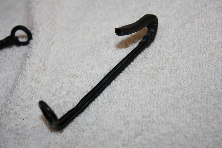

primed, painted
then used heat shrink tubing @ hook. I thought that would be a good idea being that it will be tromped on there plus the metal to metal contact with the grommet issues.

pnewman   Anyhow. Here is what I have made and am currently...   Oct 9 2012, 10:03 PM
pnewman   twisted wire to design   Oct 9 2012, 10:06 PM
pnewman   cut off excess & create loops   Oct 9 2012, 10:07 PM
pnewman   weld shut loops then grind, wire wheel & media...   Oct 9 2012, 10:09 PM
pnewman   primed, painted then used heat shrink tubing @ hoo...   Oct 9 2012, 10:13 PM
pnewman   finally installed with #10 x 1/2" stainless s...   Oct 9 2012, 10:16 PM
