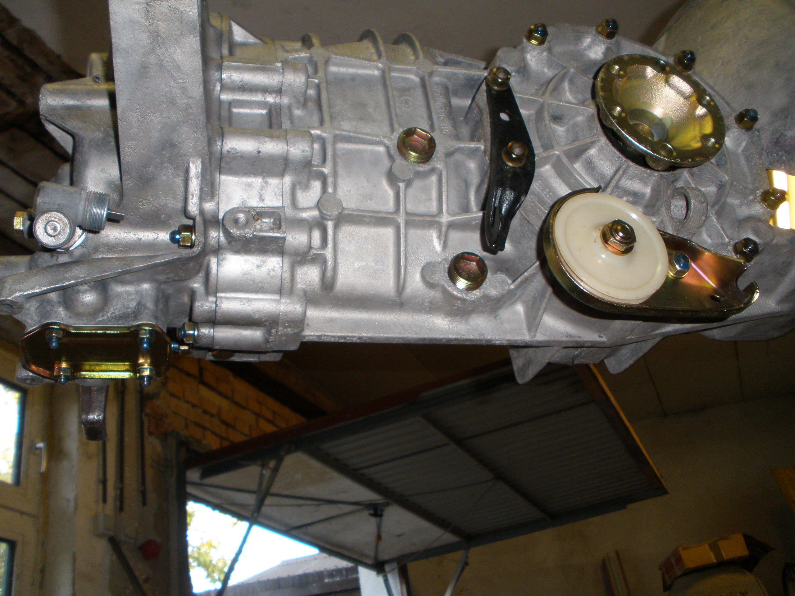

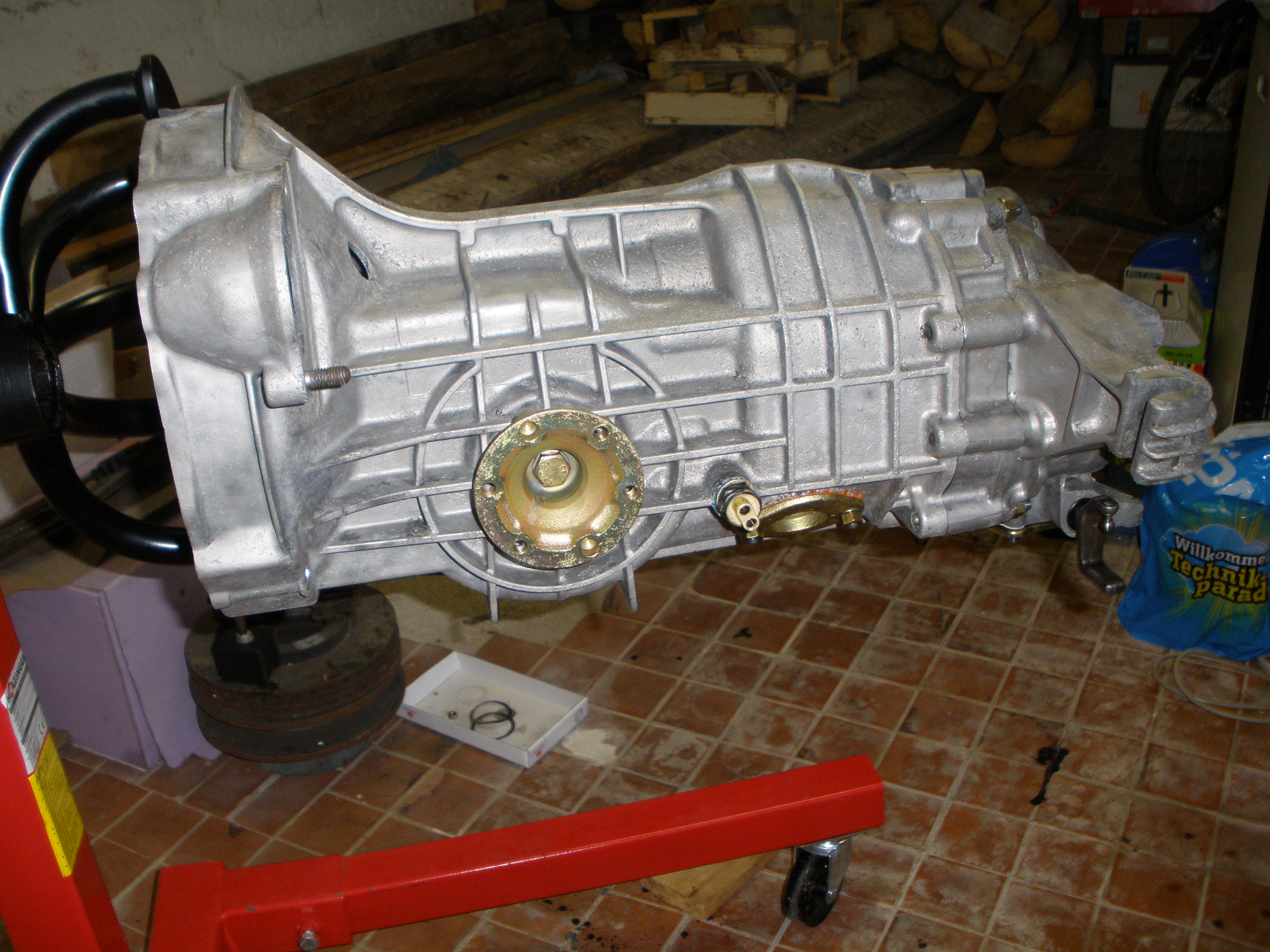

914Gelb   I bought the tool (VW 385)to measure the pinion de...   Oct 11 2012, 12:53 AM
Cairo94507   That is a beautiful transaxle you have there. Con...   Oct 11 2012, 06:51 AM
rjames   wow. Nicely done!   Oct 11 2012, 10:43 AM
Dr Evil   Good job, Georg :thumbsup: What was the price for ...   Oct 11 2012, 11:25 AM
914Gelb   Hello, the price was match more than 400. The too...   Oct 11 2012, 11:13 PM
