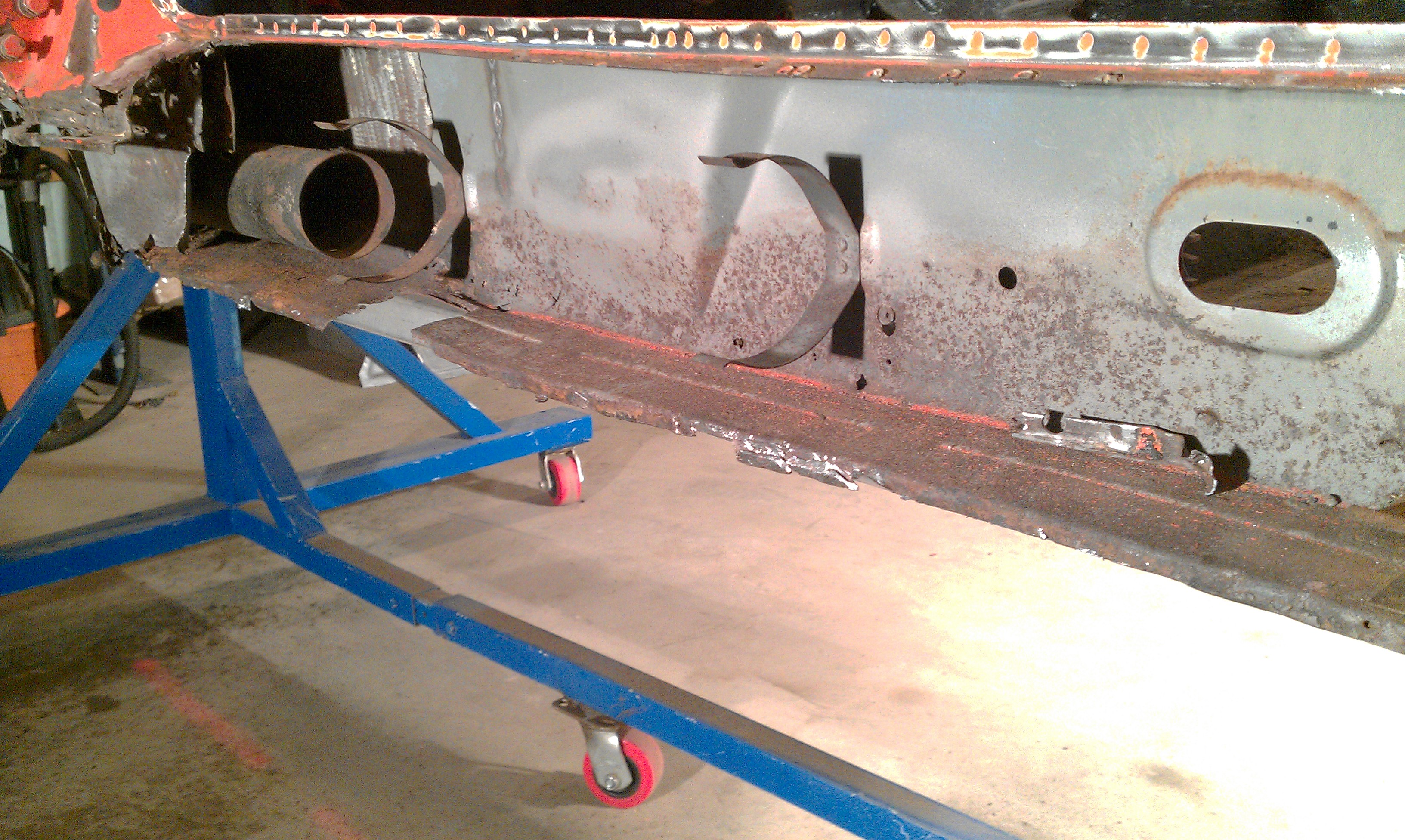

Well finally got back to work.
Opened up the drivers long so I could get to work.

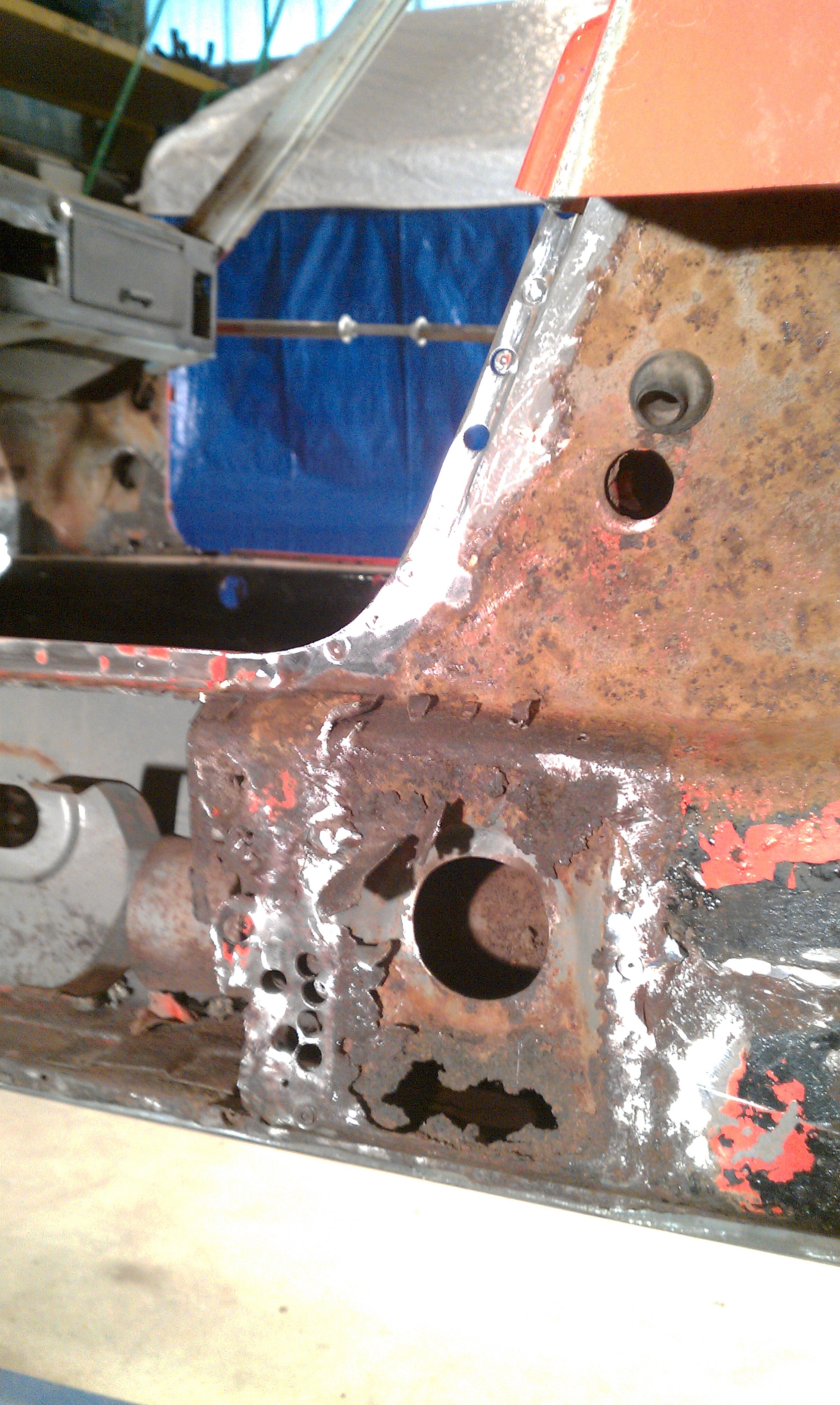

cary   Started by surveying the rust at both ends of the ...   Oct 24 2012, 08:24 PM
cary   Front end ............... Look what I found und...   Oct 24 2012, 08:27 PM

cary   The more I look at that drivers long. The more I...   Nov 11 2012, 11:04 PM

cary   Now for the bad news. I didn't look at the pas...   Nov 18 2012, 08:52 PM
