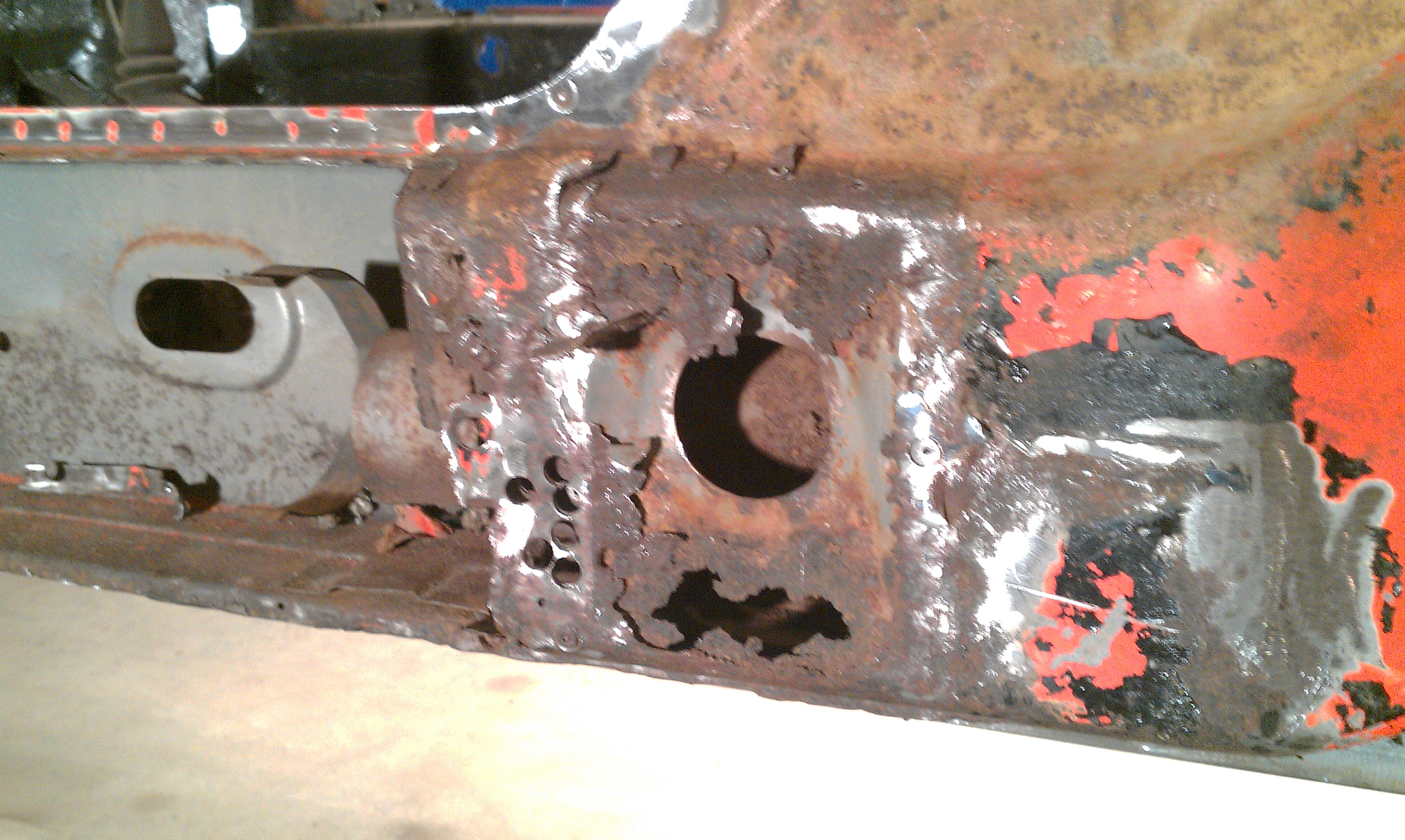

cary   Started by surveying the rust at both ends of the ...   Oct 24 2012, 08:24 PM
cary   Front end ............... Look what I found und...   Oct 24 2012, 08:27 PM
cary   Then I start the carnage ................   Oct 24 2012, 08:32 PM
cary   Getting my moneys worth from my cutting wheels.......   Oct 24 2012, 08:38 PM
cary   First I cut off the bottom .............. Still...   Oct 24 2012, 08:55 PM
cary   Then you see where the day ended ................ ...   Oct 24 2012, 09:07 PM
cary   You can see in this picture our cheater bar. B...   Oct 24 2012, 09:24 PM
cary   As you can see the car isn't liking hanging up...   Oct 24 2012, 09:27 PM
cary   Here's a shot looking into the wheelhouse. Wha...   Oct 24 2012, 09:29 PM

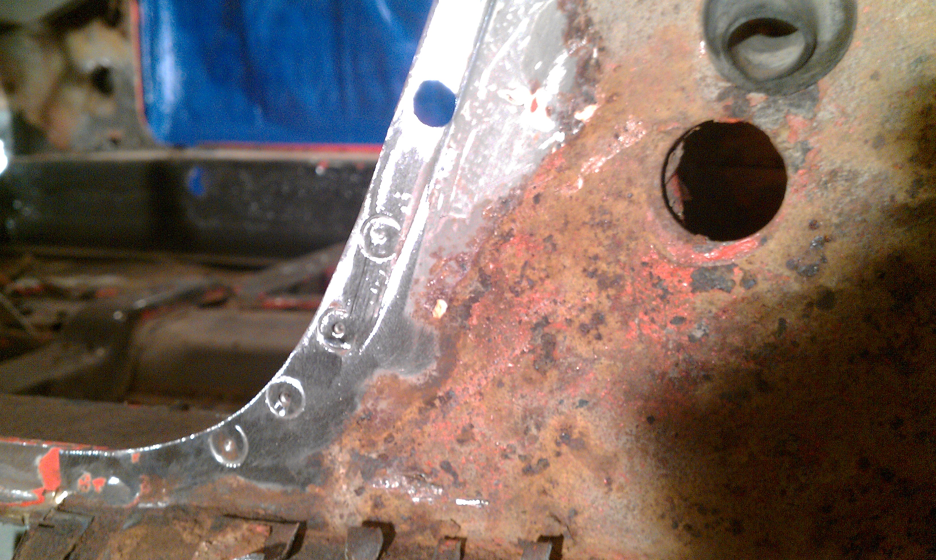

cary   So I moved on the recreating the bottom corner of ...   Nov 19 2012, 09:32 PM
cary   Here's where we start. This is going to tak...   Nov 19 2012, 09:37 PM
cary   Using some of Mark's work as a pattern. I...   Nov 19 2012, 09:41 PM
cary   First attempt with the shrinker we made the apex o...   Nov 19 2012, 09:46 PM
