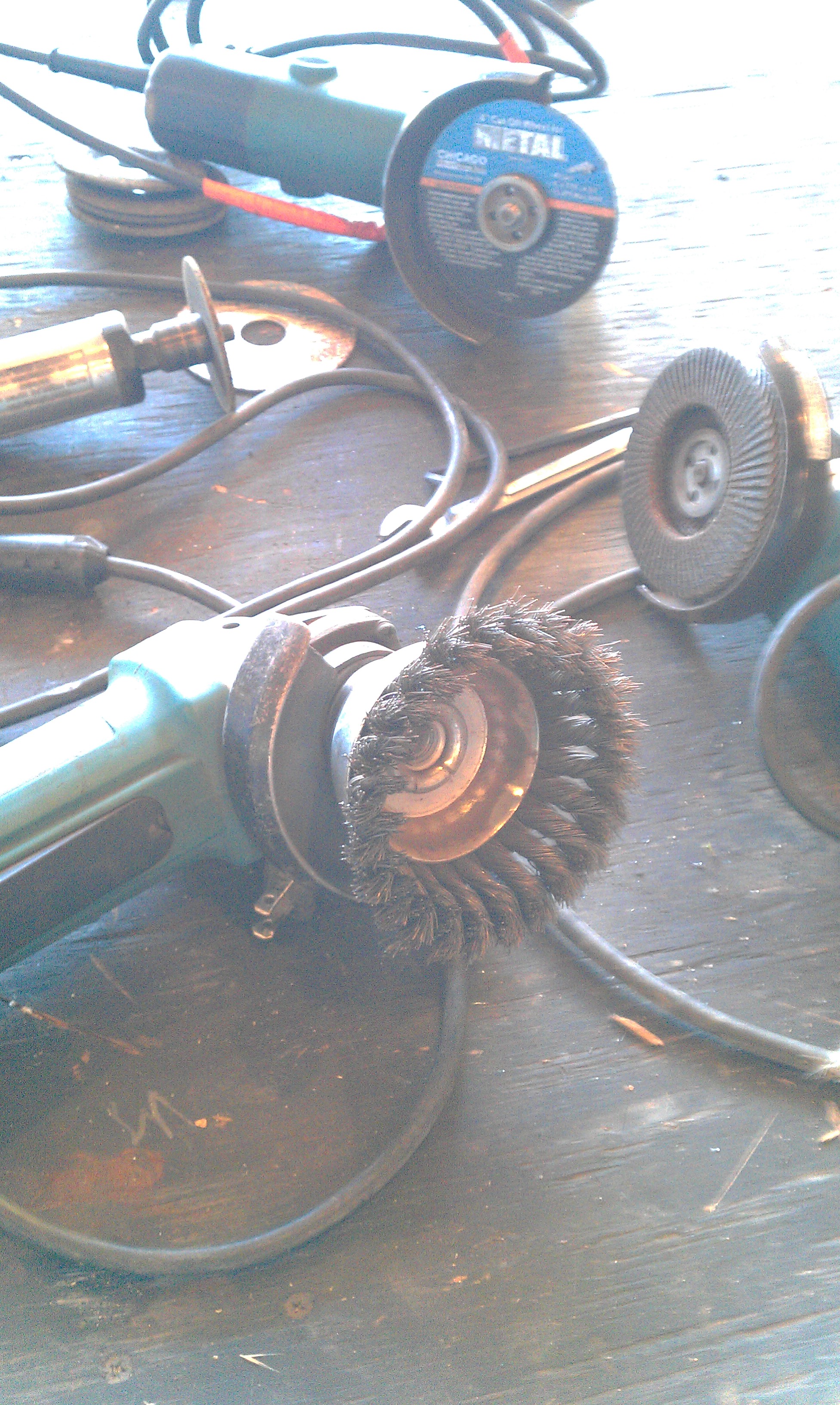

Well I headed out to shop for a mid week evening shift.
Attached Image Weapons .........

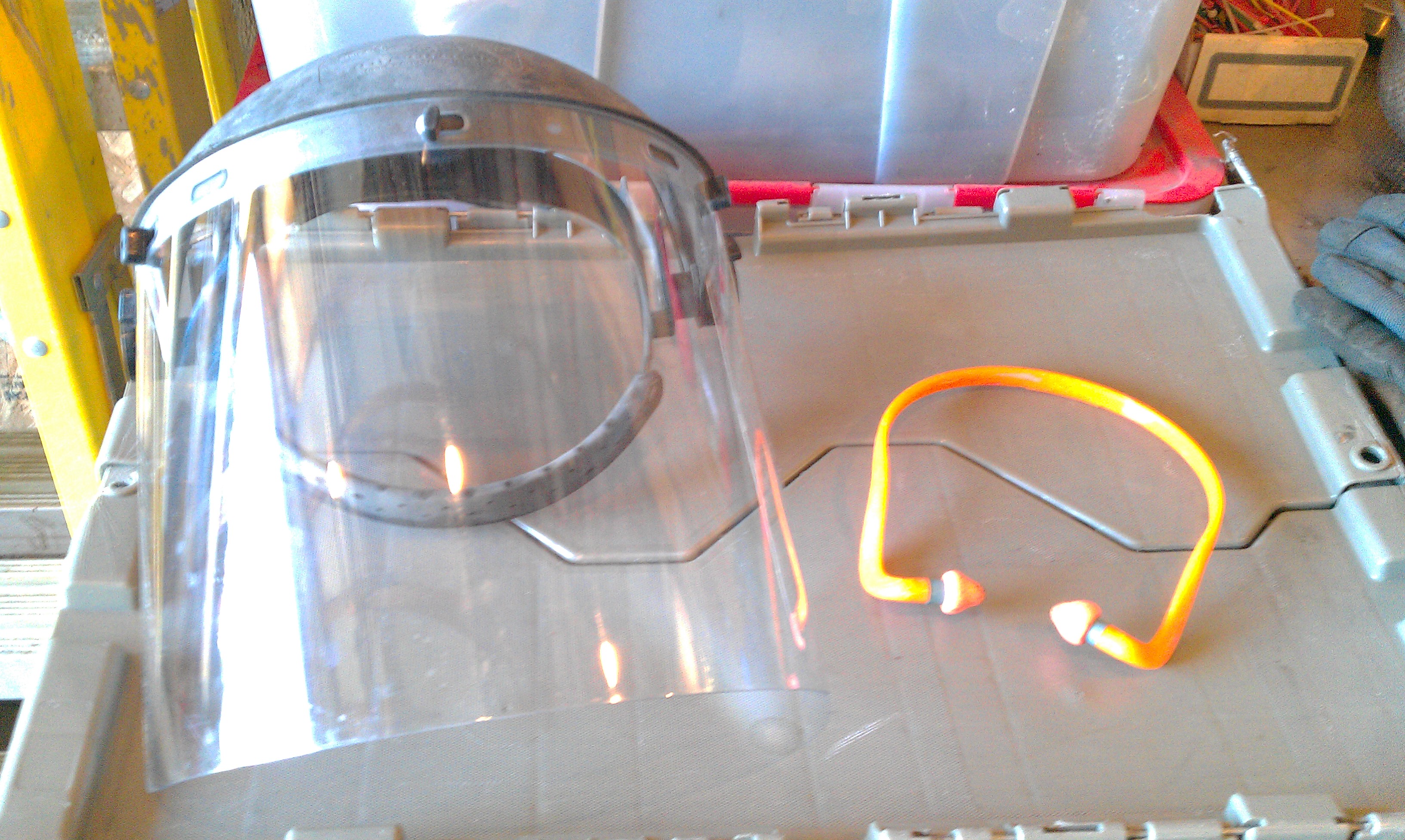

Safety equipment so I can live fight another day.
