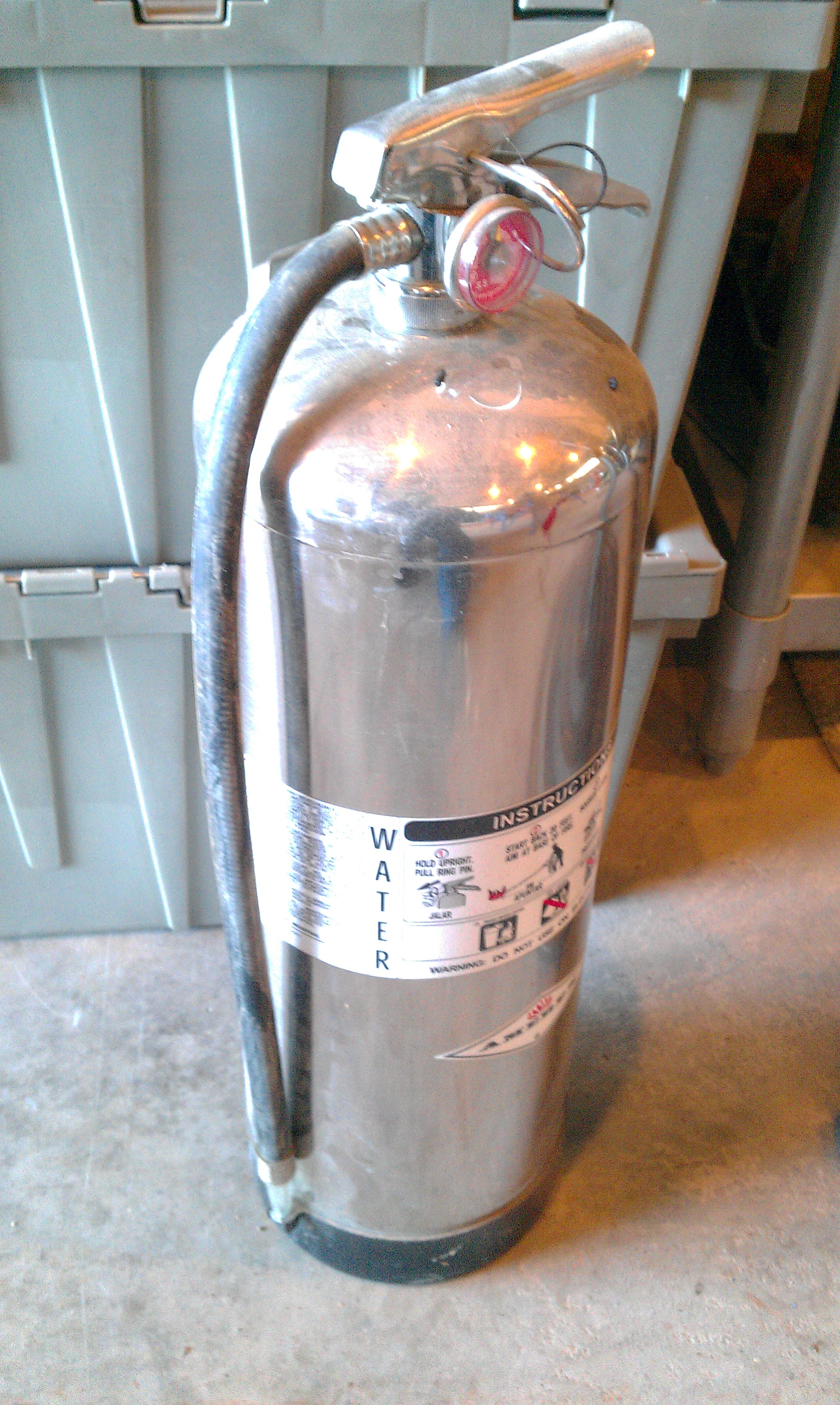

Just in case I do something stupid ...........
