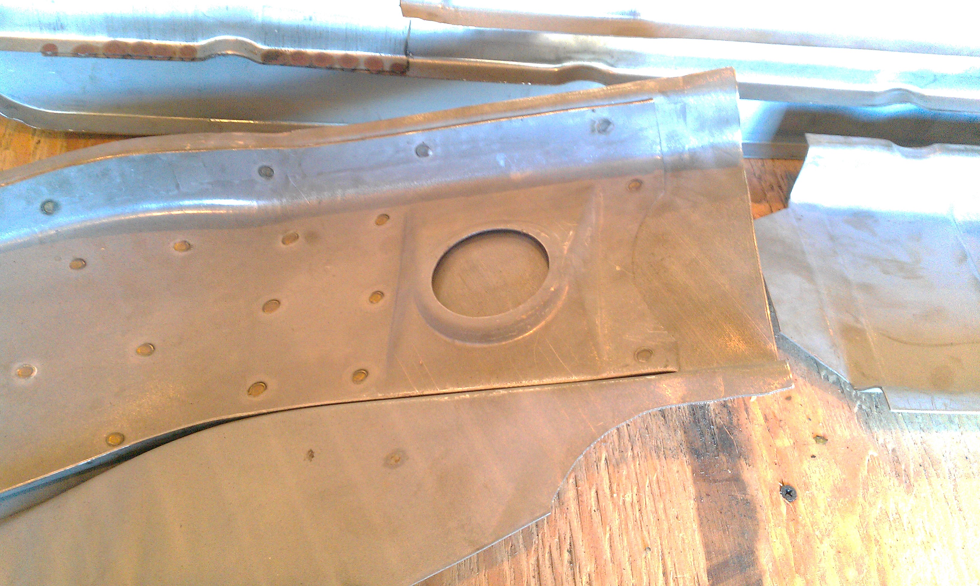

Here's what I'll need to somewhat recreate ...........
Thats the new passenger side that I have from RD.
Hmmm......
