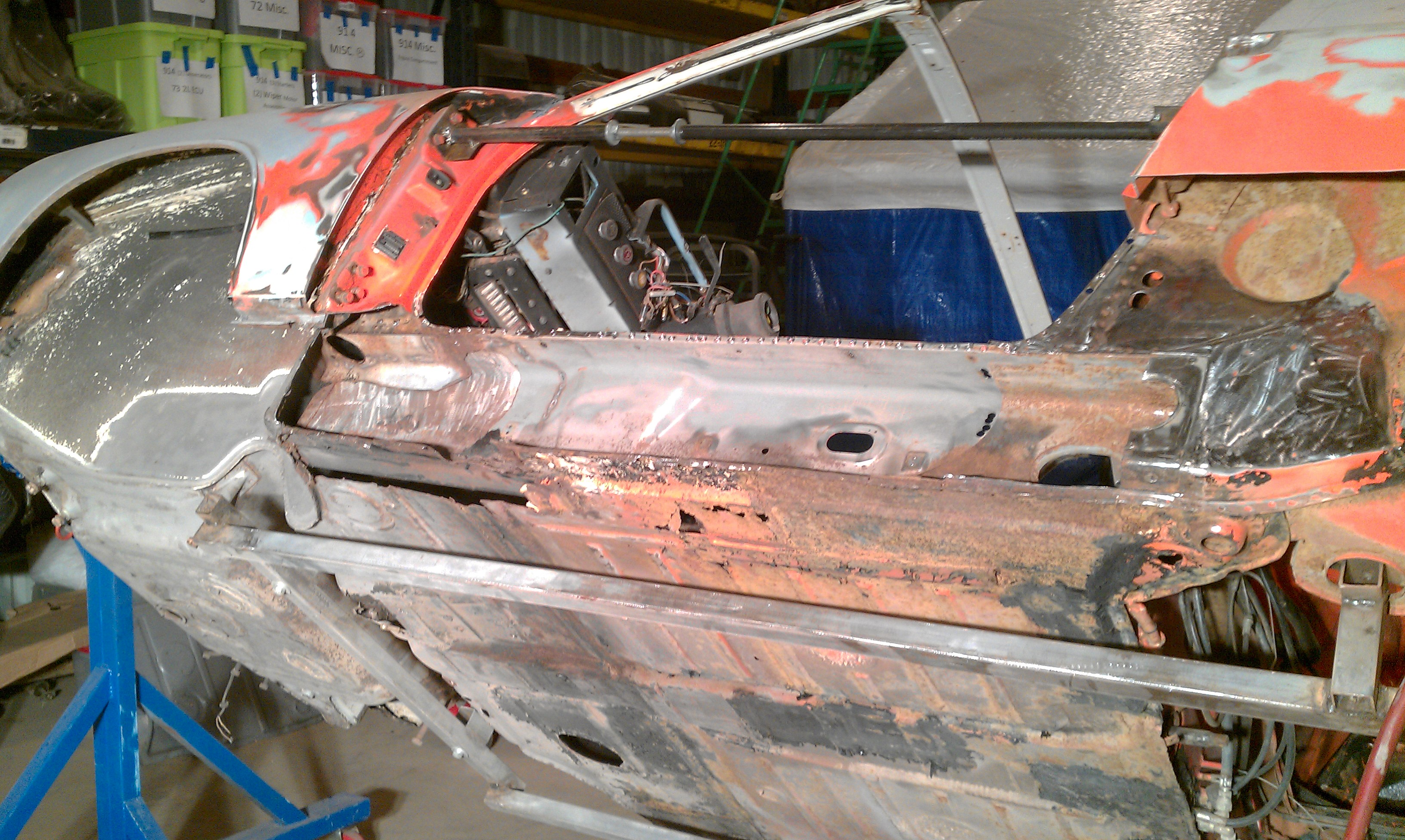

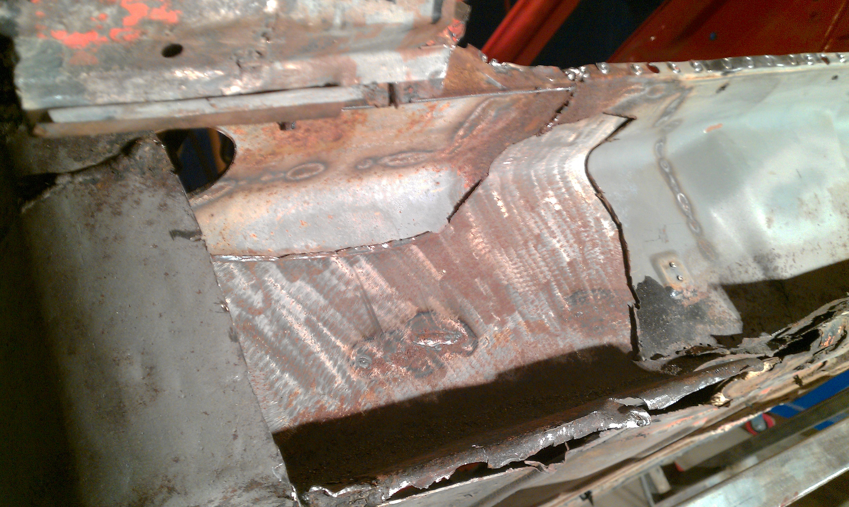

Here's the long all gutted. Didn't have to bugger up the heater tubes too bad.
They didn't ever plan on taking those heater tubes out when they designed the assembly line process.
I love the front door post one the best. Welded on the backside......
The engine compartment I just use the air chisel with a sharp edge.
Here's the fine craftsmanship I found in the front clip install sometime in its life.
Now I'll have some pondering how I'm going tidy that up.
Seems odd that the back side patch had little or no rust. Just some surface stuff.
Looking for some advice I guess ........
