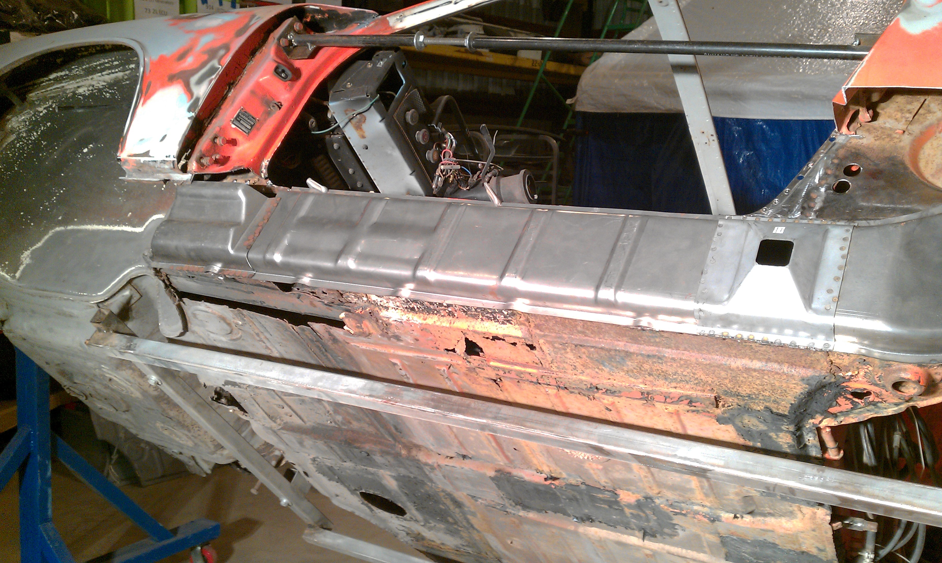

cary   Here's the long all gutted. Didn't have to...   Oct 18 2012, 11:21 AM
cary   Or just mix up some JB weld and we're good to ...   Oct 18 2012, 11:24 AM

cary   The more I look at that drivers long. The more I...   Nov 11 2012, 11:04 PM

cary   I decided an amputation is in order. Heading to th...   Nov 18 2012, 09:43 AM
cary   Well whats the going rate on a 3 1/2 hour surgery?...   Nov 18 2012, 08:21 PM
