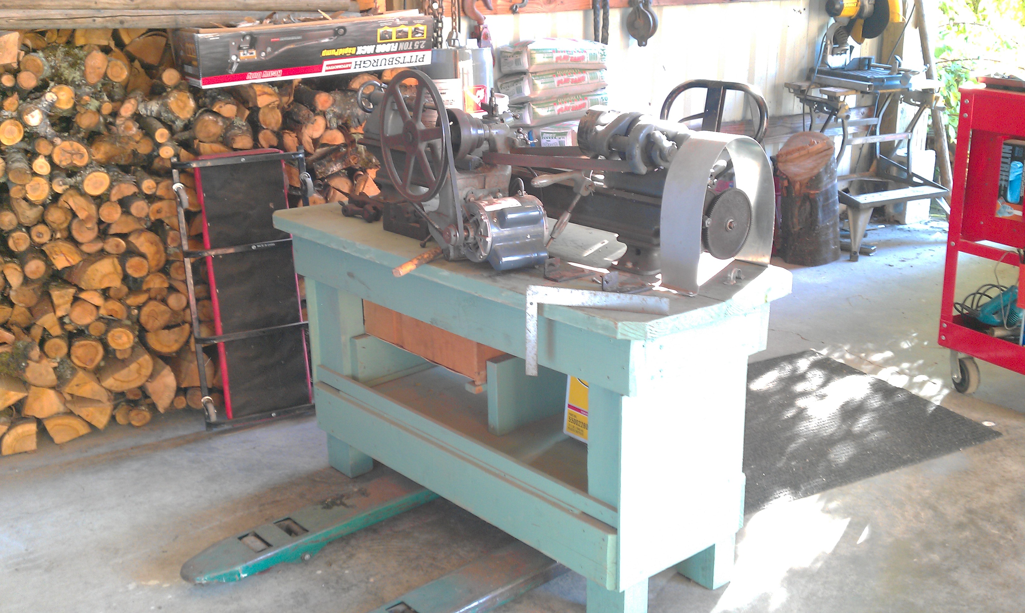

While I was painting Super In-Law was tinkering with the lathe I bought last month.
Do I really need it ? Probably not. I wanted more for fixing than making.
But at $300 I couldn't pass it up.
Tool Whore.
