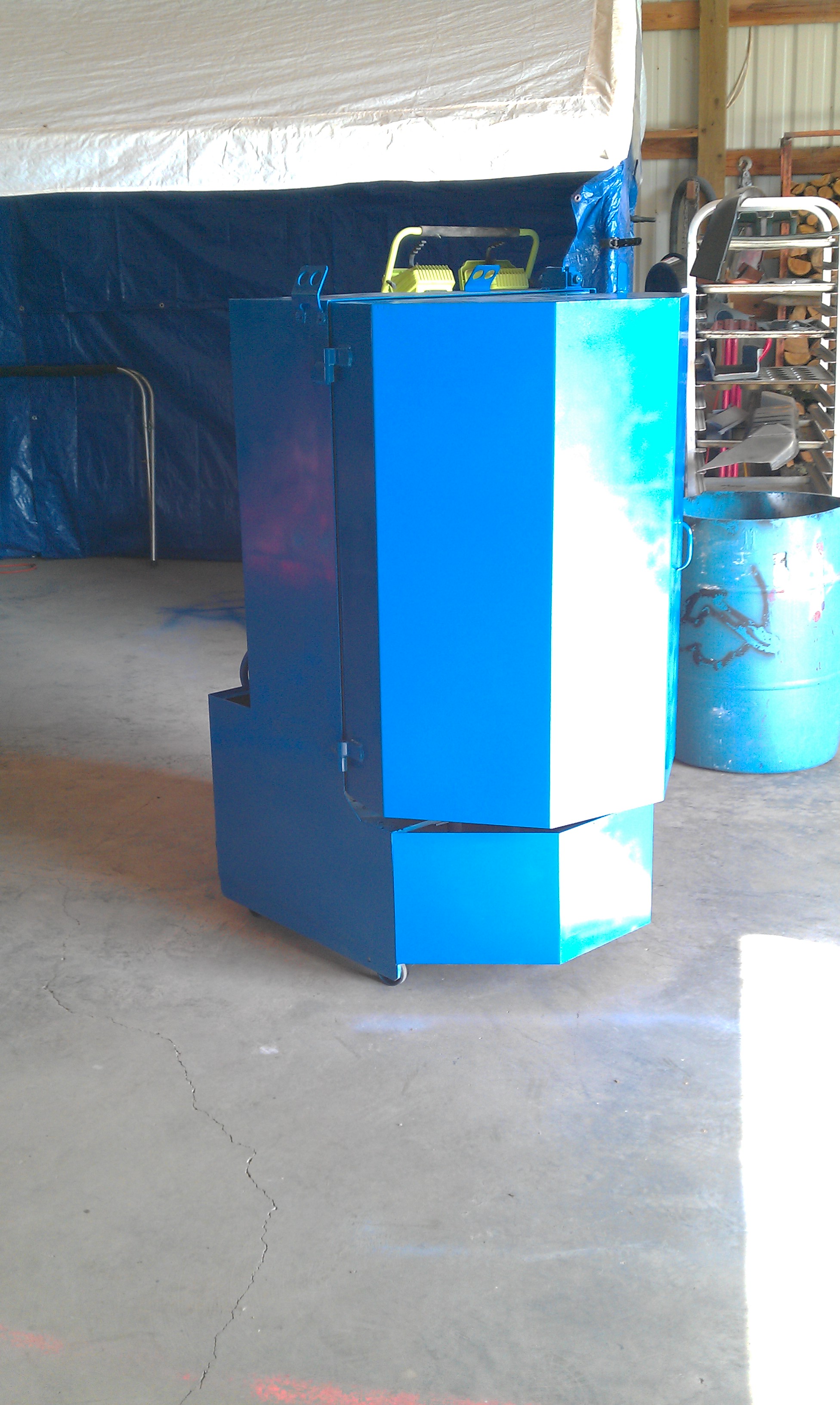

Out into the light of day...............
Even though its cheap paint. It teaches you to keep the gun moving. And how to tinker with different pressures and settings to get the atomization your looking for.

QUOTE(cary @ Oct 20 2012, 07:06 PM) *
That's a viper-jet washer! Used to have one... Good piece of equipment!
