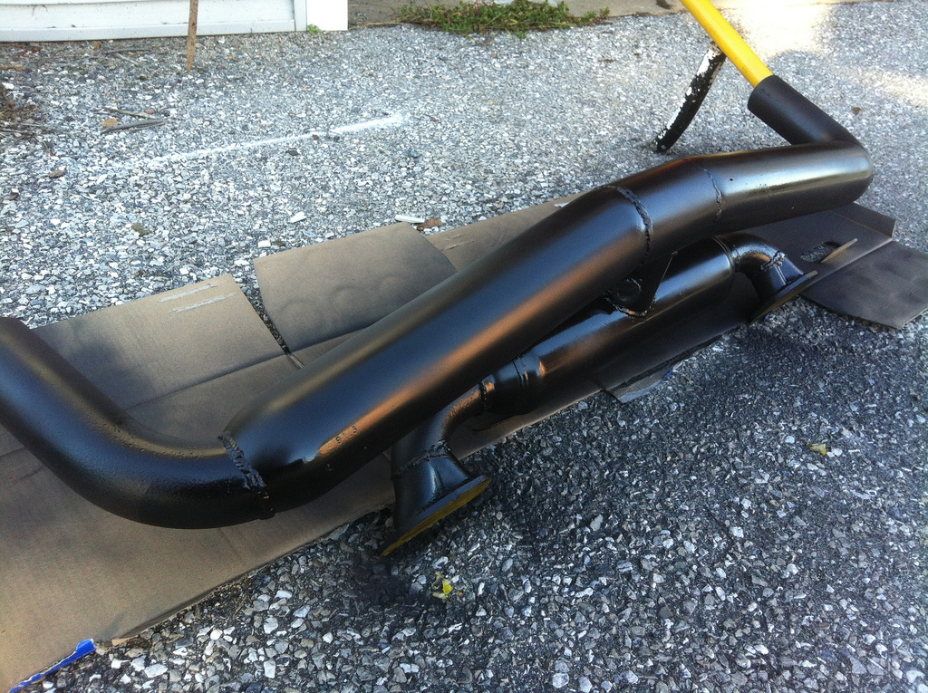

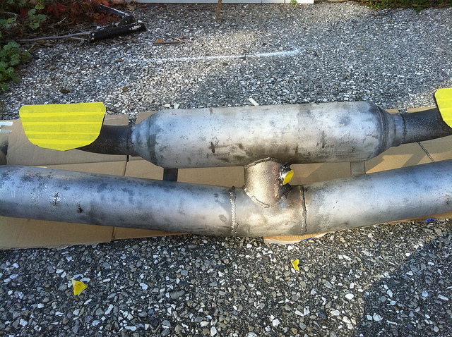

Last week I picked up a triad muffler from Bill in Mt Airy.
Over the weekend I blasted it clear of old paint and what little rust it had. I also got a free, used O2 bung from a fellow teener this weekend at ECC.

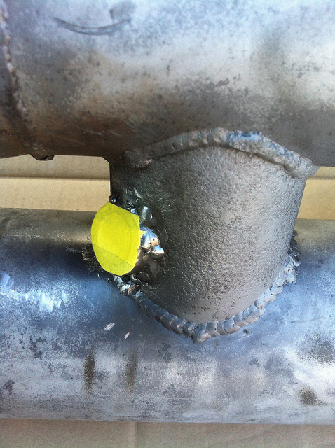

Today I cut in the opening for the O2 sensor. I cleaned up the used bung and welded it into pace. I could not find a 18mm fine bolt, so I tried to be very careful not to warp the bung while welding it into place.
Then I put the first coating of grill paint on it.
(IMG:http://www.914world.com/bbs2/uploads_offsite/farm9.staticflickr.com-1435-1350941580.1.jpg)
(IMG:http://www.914world.com/bbs2/uploads_offsite/farm9.staticflickr.com-1435-1350941581.2.jpg)
(IMG:http://www.914world.com/bbs2/uploads_offsite/farm9.staticflickr.com-1435-1350941581.3.jpg)
I actually made real progress today!!!
The second and third coats of paint will come ay a later date. The first was put on quickly today to keep it from rusting up since I had blasted the metal bare yesterday.
Zach
wndsrfr
post Oct 22 2012, 06:00 PM
Posts: 1,467
Joined: 30-April 09
From: Rescue, Virginia
Member No.: 10,318
Geez, you're working fast Zach....good to see that bung is working out--it's pretty meaty & shouldn't have warped much if any. Which wideband are you going to be using?
