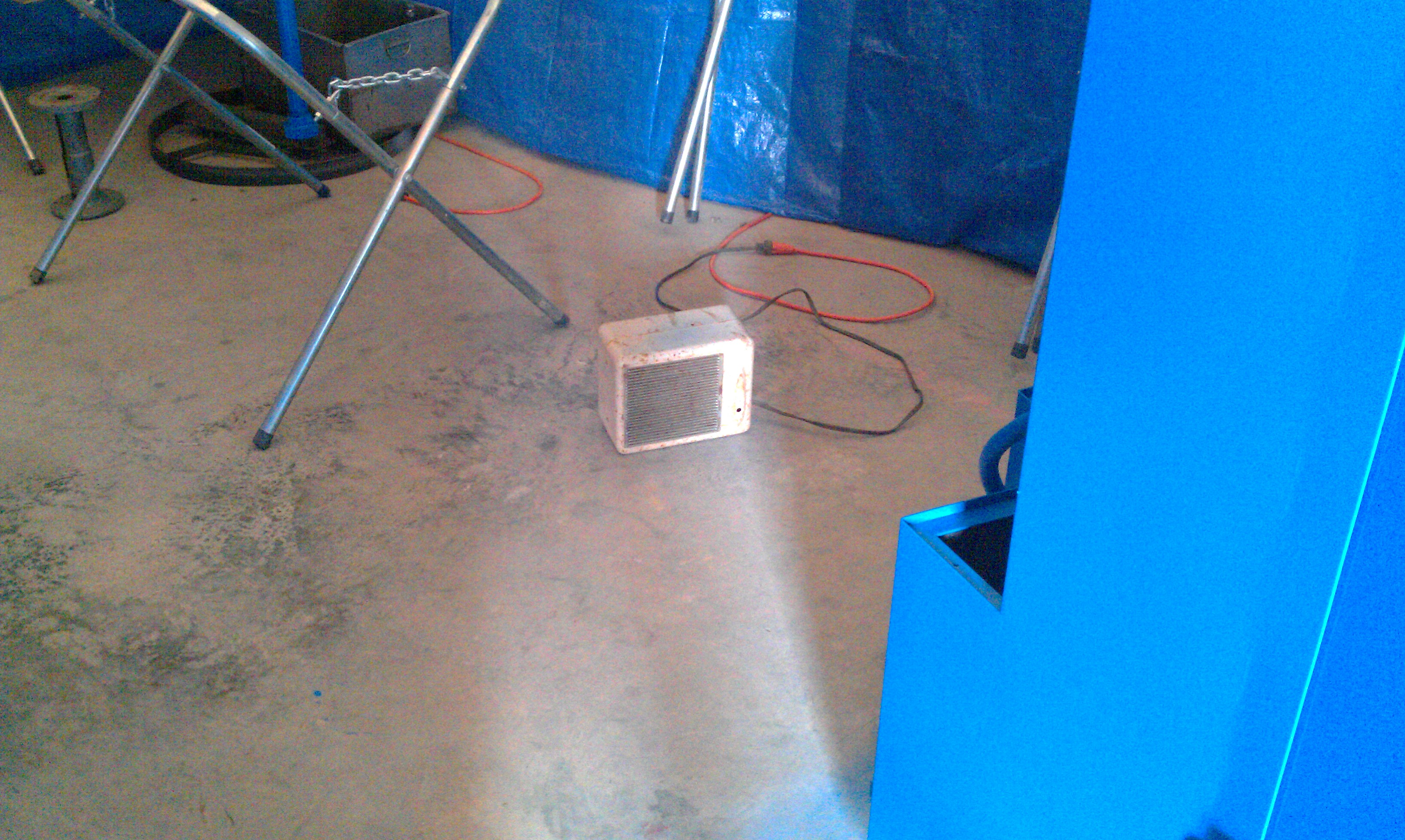

Wednesday the 24th.
Started the day by putting the second coat on the parts washer.
In my heated paint booth ..................... LOL
