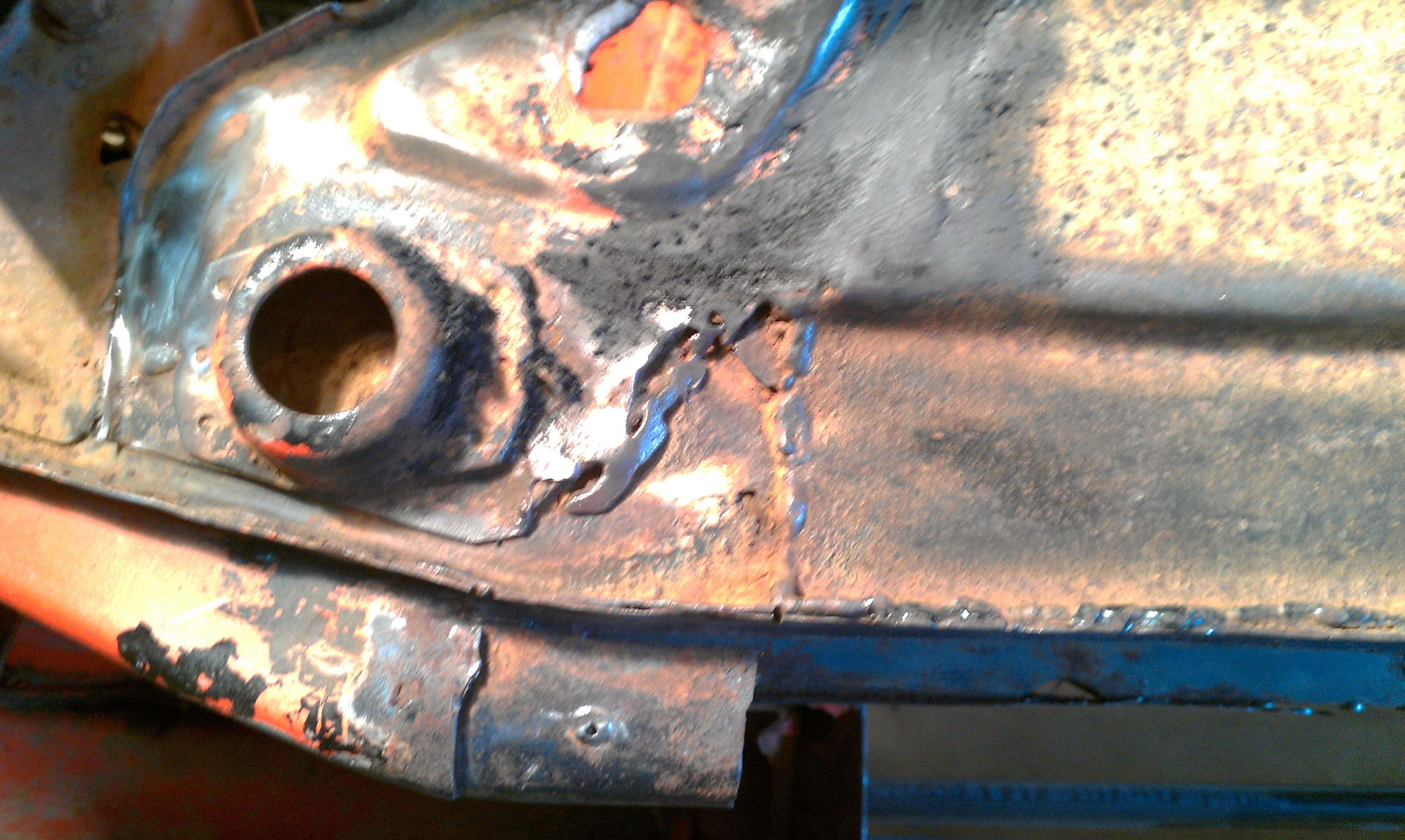

cary   The more I look at that drivers long. The more I...   Nov 11 2012, 11:04 PM

cary   I decided an amputation is in order. Heading to th...   Nov 18 2012, 09:43 AM
cary   Well whats the going rate on a 3 1/2 hour surgery?...   Nov 18 2012, 08:21 PM
cary   Now to disconnect the firewall/hell hole ............   Nov 18 2012, 08:29 PM
cary   Here's a shot up the rear suspension long. Sho...   Nov 18 2012, 08:33 PM
cary   Now for the front end. Outside shot. Inside ...   Nov 18 2012, 08:36 PM
cary   Now 3 1/2 hours later ................   Nov 18 2012, 08:39 PM
cary   Now for the bad news. I didn't look at the pas...   Nov 18 2012, 08:52 PM

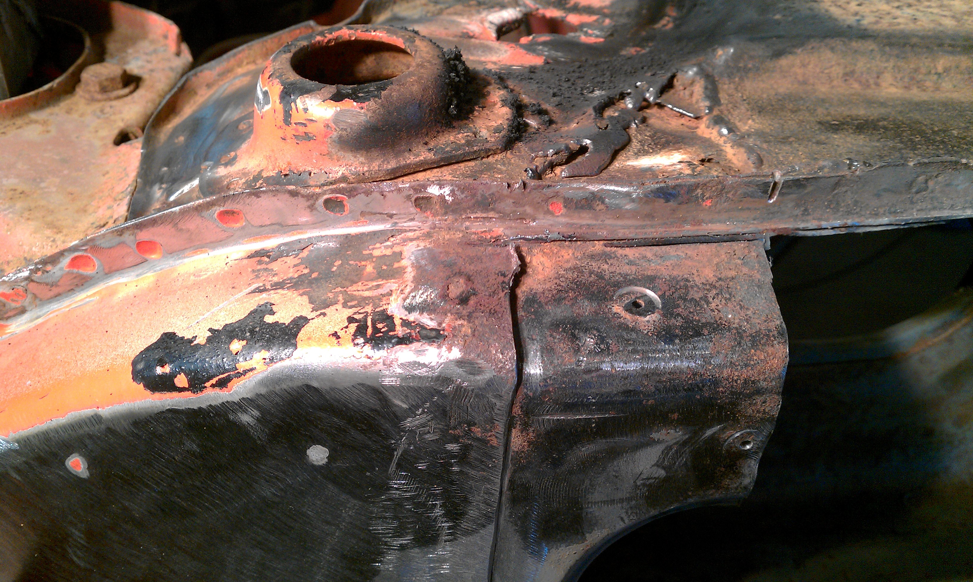

cary   Well decided against moving on to the passenger lo...   Nov 19 2012, 09:23 PM
cary   So I moved on the recreating the bottom corner of ...   Nov 19 2012, 09:32 PM
cary   Here's where we start. This is going to tak...   Nov 19 2012, 09:37 PM
cary   Using some of Mark's work as a pattern. I...   Nov 19 2012, 09:41 PM
cary   First attempt with the shrinker we made the apex o...   Nov 19 2012, 09:46 PM
