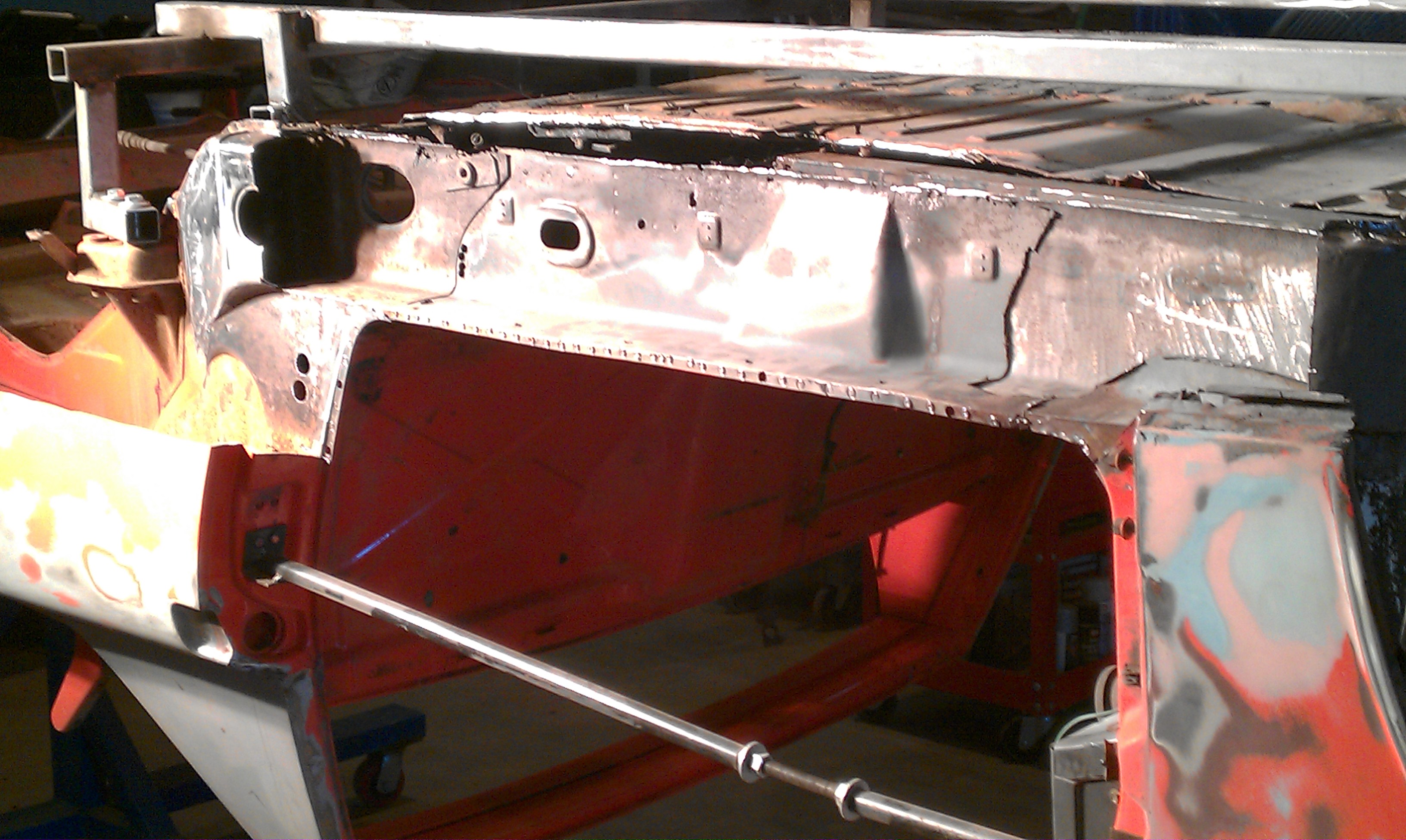

First I cut off the bottom ..............
Still amazes me how crappy the workmanship was on that front clip repair
back in the day..................

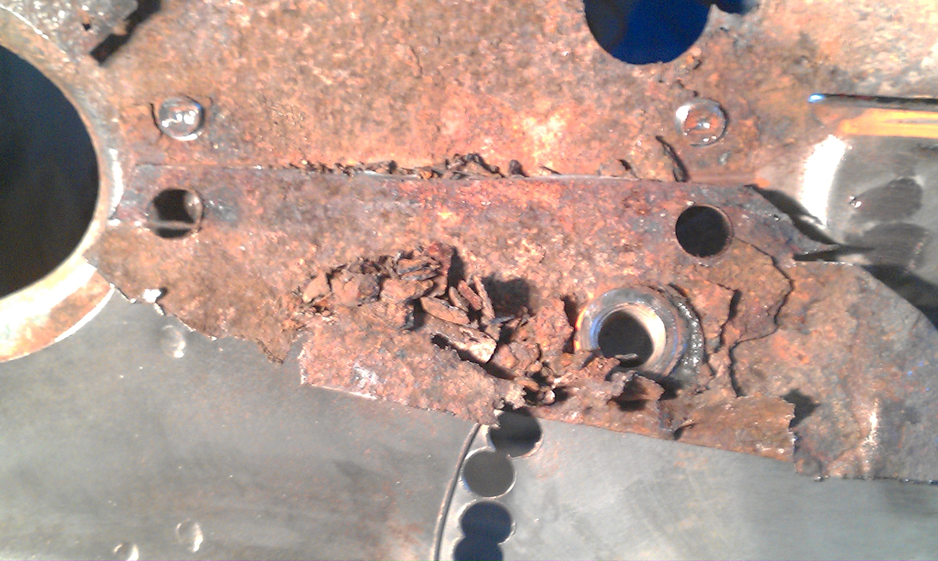

Then I cut thru the first layer to remove the seatbelt nut .............
What that shows you is what happens when you don't use weld thru primer.
What you see is that portion folded down after I cut only thru the first layer.
So I cut off a portion on the inner box layer. The rust was primarily isolated
to the bottom.
