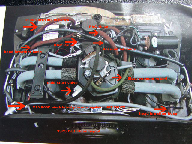

QUOTE(Bullet @ Jun 13 2004, 06:44 PM)
I was reading through some stuff on pbanders site and I read that my pcv breather hose should not go to the top of my air box but it should go to the air distrubtion box? and the i looked at this picture and he has it routed to the air box. I ran outside and tried this. but found out that the pcv house is to big for the hoses conections on the intake. so i used a ruber house to make it work. Car runs a beter now but i get a really anoying whistle when i do this. is this normal?
(IMG:http://www.914world.com/bbs2/uploads/post-2-1082882279.jpg)
'75-'76s do not have PCV valves. The PCV line runs from the oil filler connection to the air cleaner box, above the throttle plate.
What year is your car? I missed that.

Bullet   I was reading through some stuff on pbanders site ...   Jun 13 2004, 08:44 PM
Bleyseng   It goes to the plenum via a rubber boot that has a...   Jun 13 2004, 10:21 PM

Bullet   mine is a 75 2.0L. So you are saying that it goes...   Jun 13 2004, 11:43 PM
Bleyseng   Air cleaner then if you have a 75 with all the smo...   Jun 14 2004, 08:18 AM
