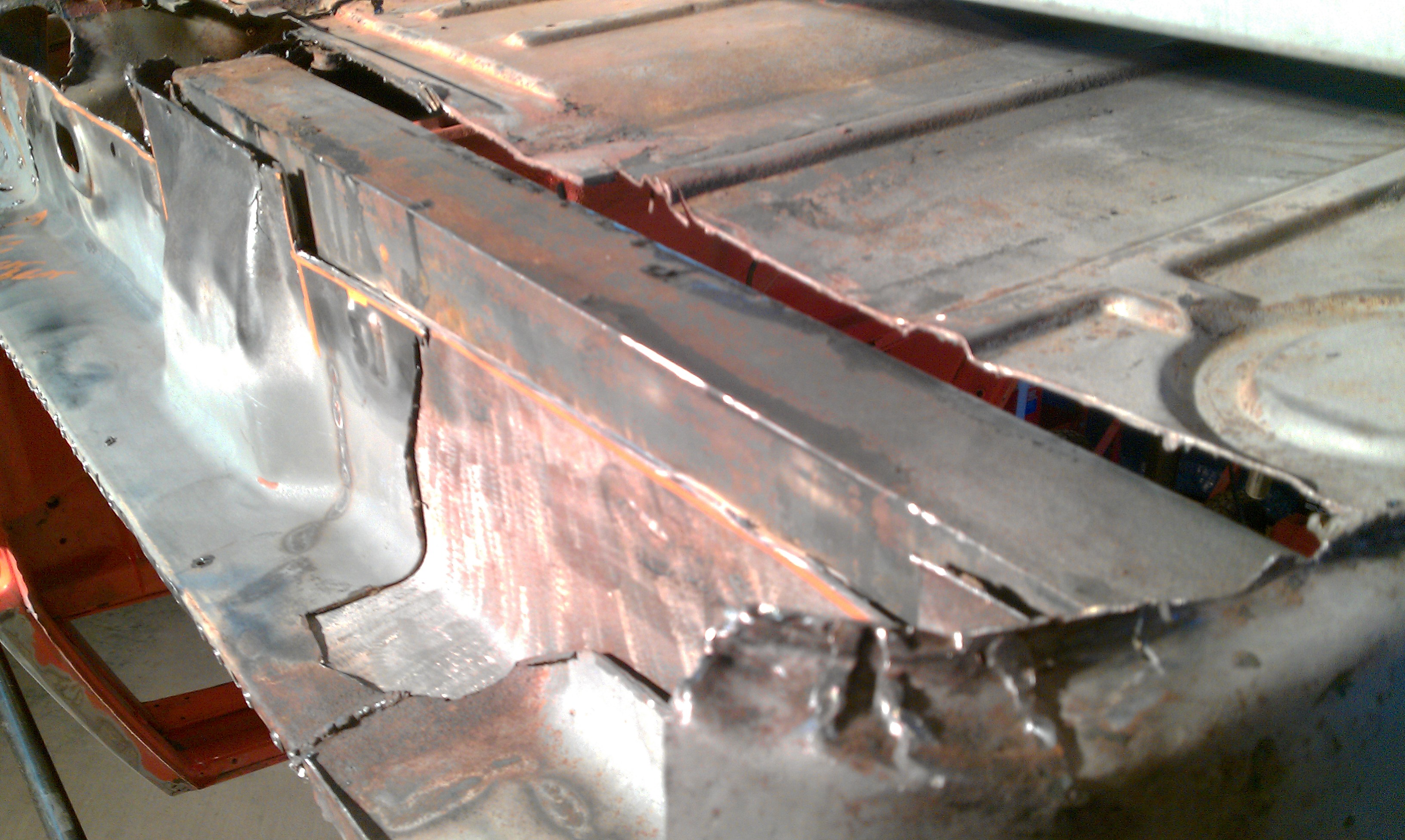

You can see in this picture our cheater bar.
Back 10 years ago when we were prepping the car for my son Robert.
We installed a portion of angle iron between the front wall and the floor crossmember.
It served us well. I haven't decided if I'll replace it with a stiffener kit or leave it for sentimental reasons.
