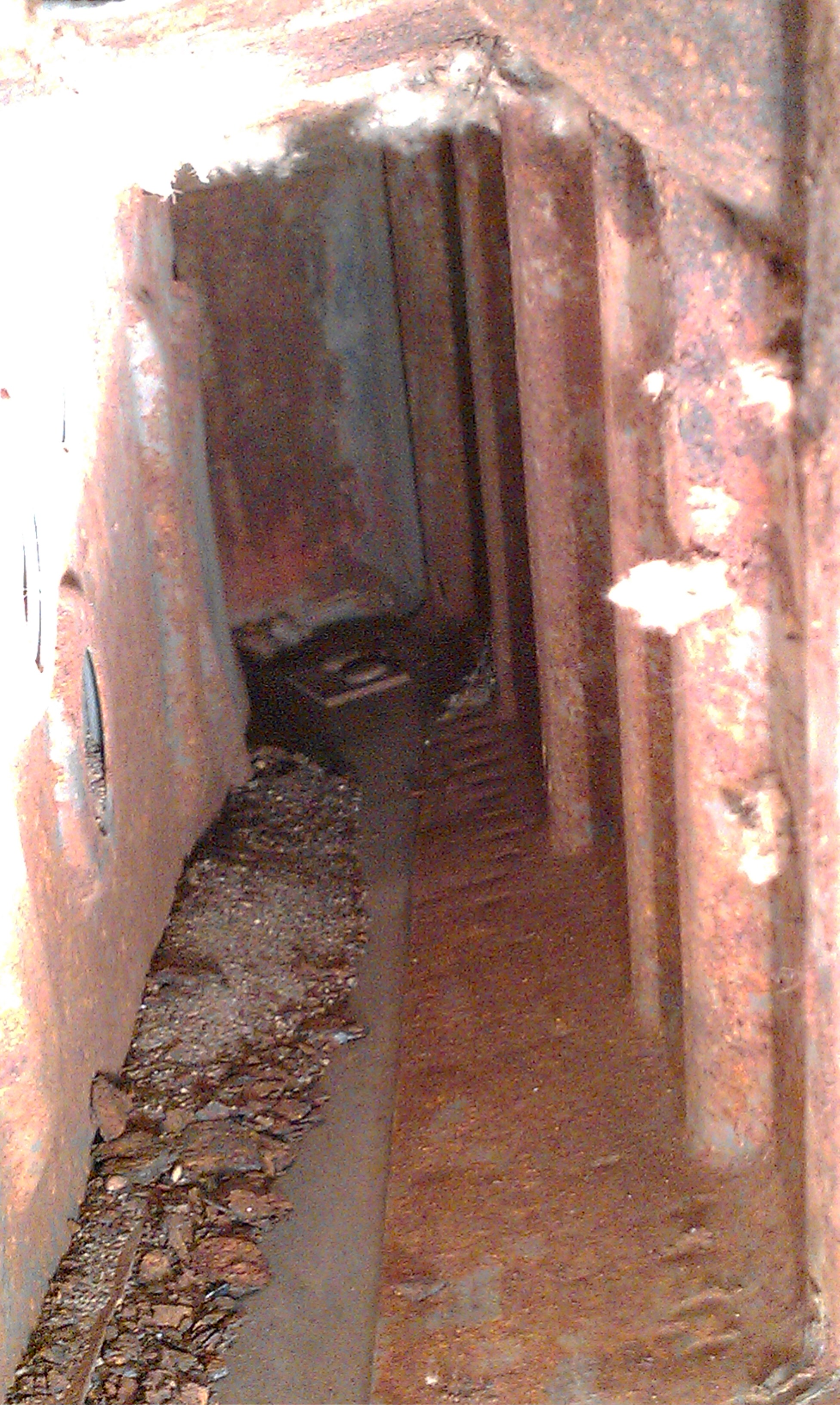

cary
post Oct 24 2012, 09:29 PM
Posts: 3,900
Joined: 26-January 04
From: Sherwood Oregon
Member No.: 1,608
Here's a shot looking into the wheelhouse.
Whats the best practice of rustproofing this cavity?
