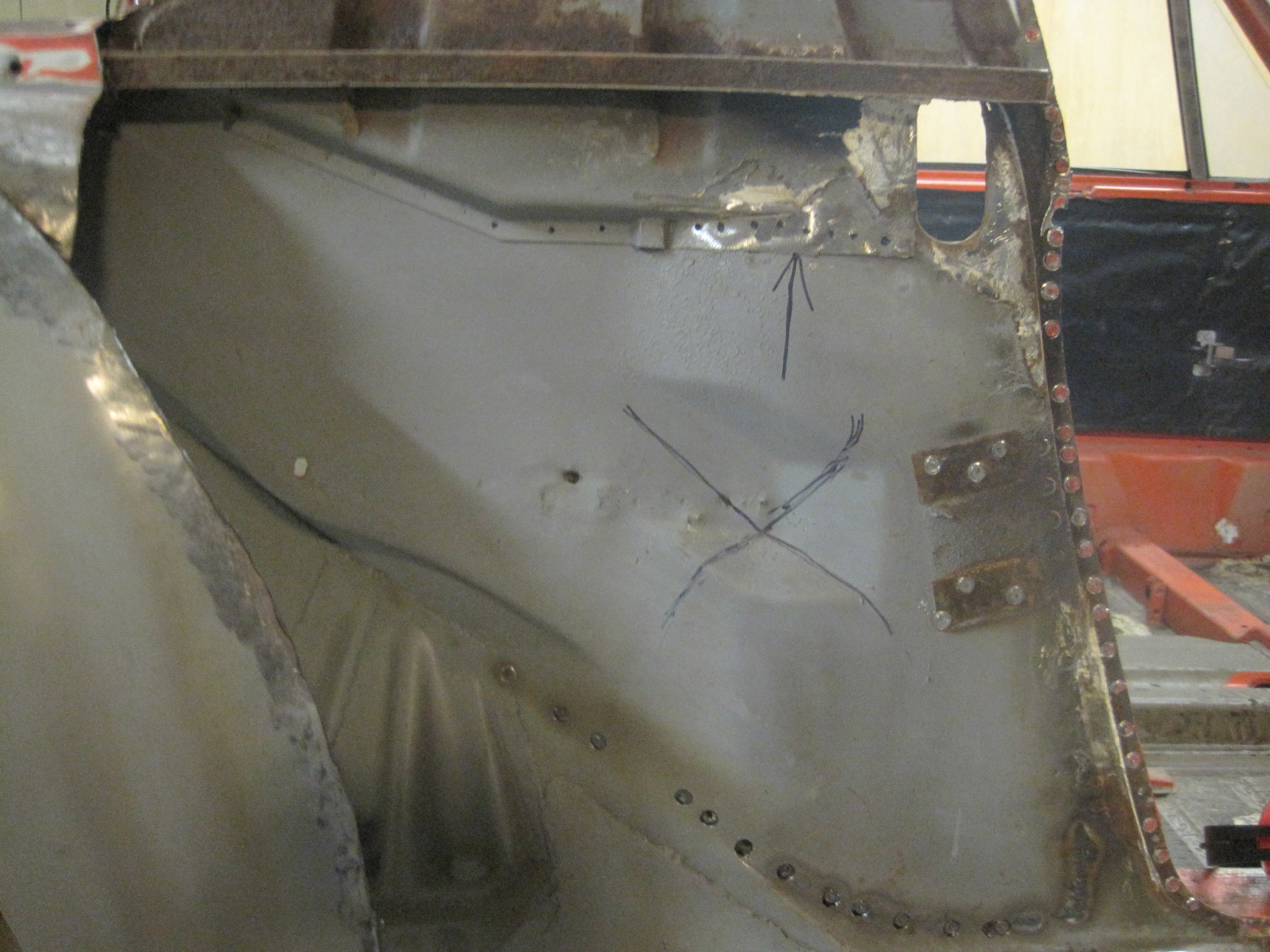

Well I am actually going backwards on this project now. I found that the inner right panel (marked with an X in the picture) was pretty rusted from the battery so I am replacing it now.
My question for others who have performed this repair is should I splice in the panel even with the bottom of the sail support (shown with an arrow in the picture) or should I go above that where the spot welds are?
