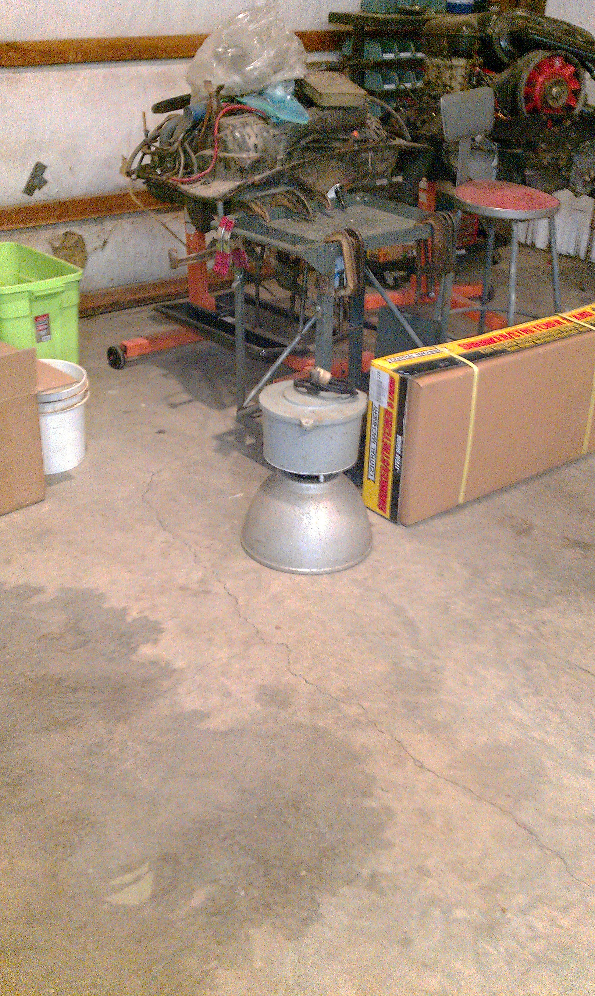

Stopped by a garage sale and found some new lights for the shop.
$30 each. Transformers are nice and quiet.
Didn't work much last winter. Didn't have enough light.
