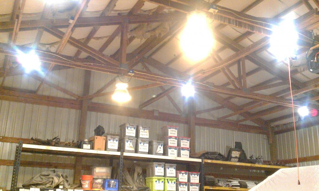

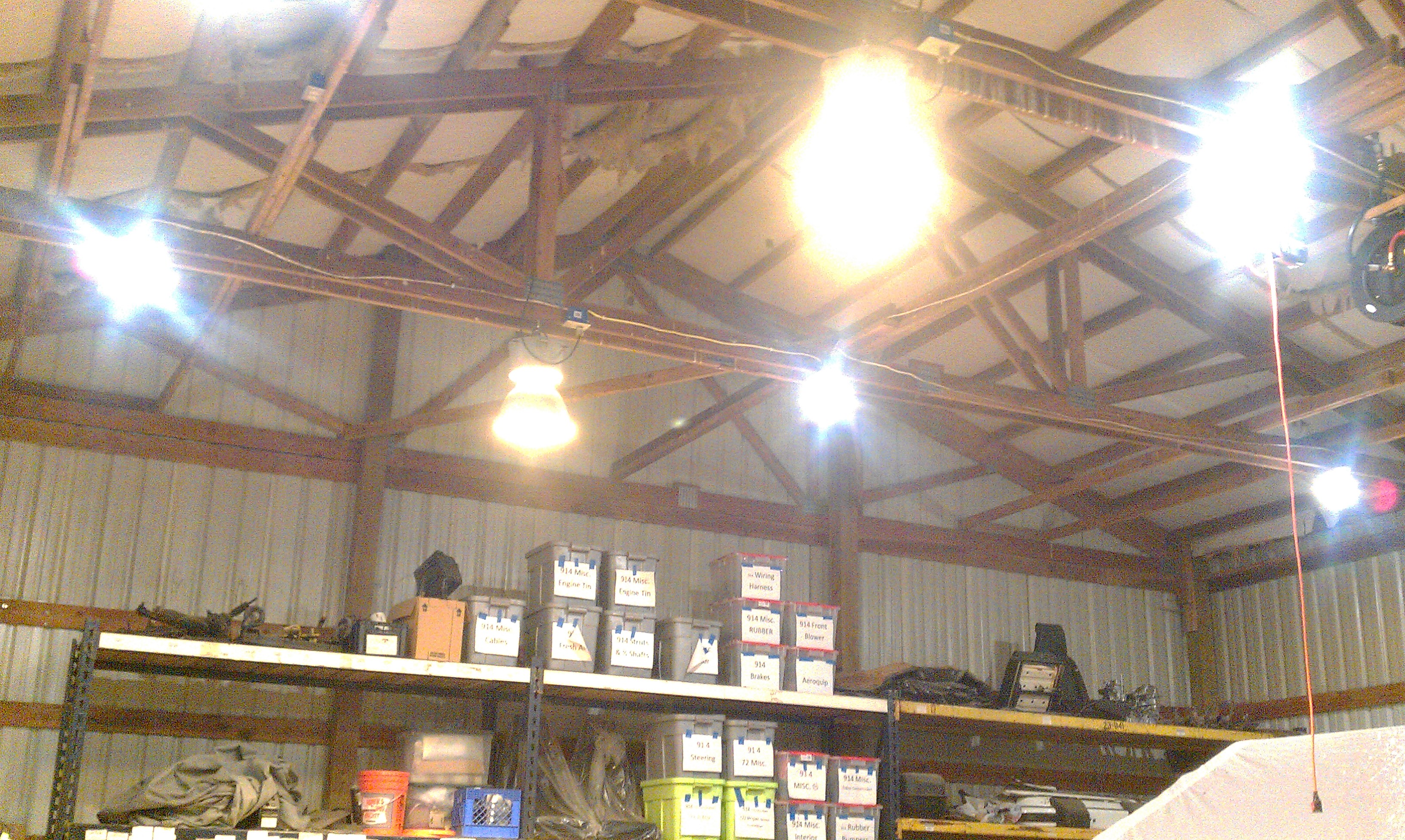

cary   Stopped by a garage sale and found some new lights...   Nov 7 2012, 07:41 AM
cary   Let there be light .........................   Nov 7 2012, 07:42 AM
cary   Now a guy can work at night ............. After wo...   Nov 7 2012, 07:44 AM
cary   Now back to work ..................... What ha...   Nov 7 2012, 07:50 AM
