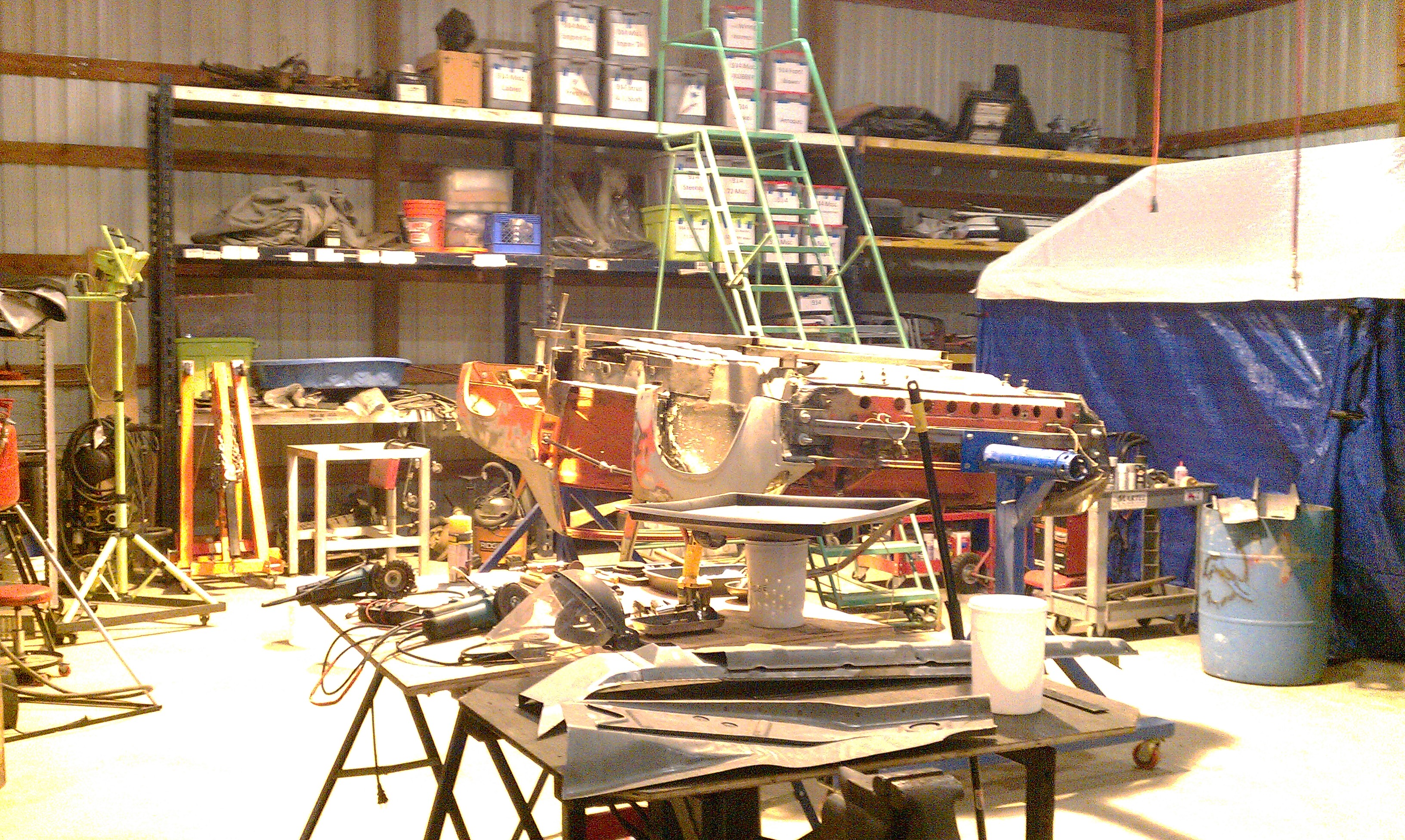

cary   Now a guy can work at night ............. After wo...   Nov 7 2012, 07:44 AM
