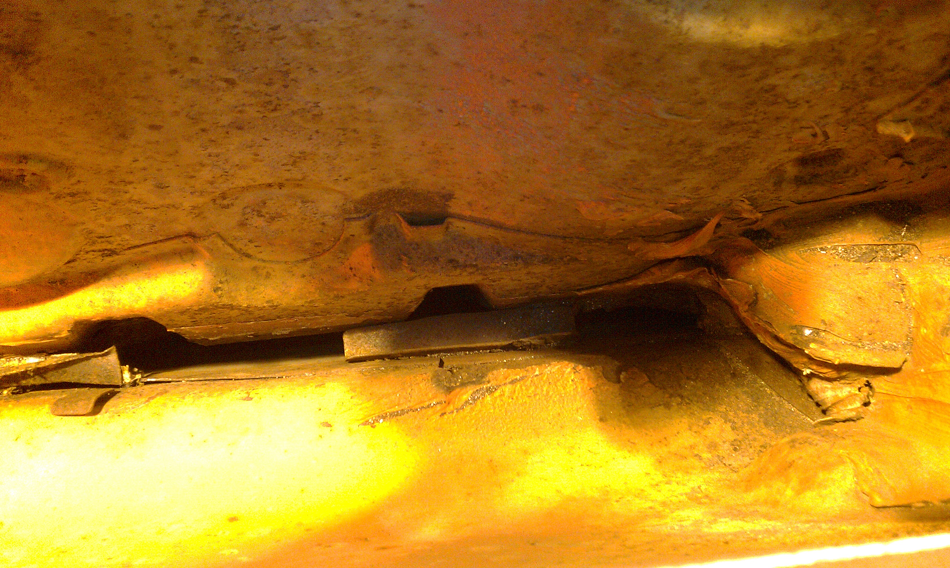

Now back to work .....................
What have some some folks done to seal up the sail panel cavity so we don't get debris up in there.
This is looking at it hanging upside on the rotisserie.

cary   Now back to work ..................... What ha...   Nov 7 2012, 07:50 AM
wingnut86   Wow Cary, Friends and family can no longer call i...   Nov 7 2012, 08:55 AM
cary   I'm not getting too much flash rust. They...   Nov 7 2012, 08:21 PM
