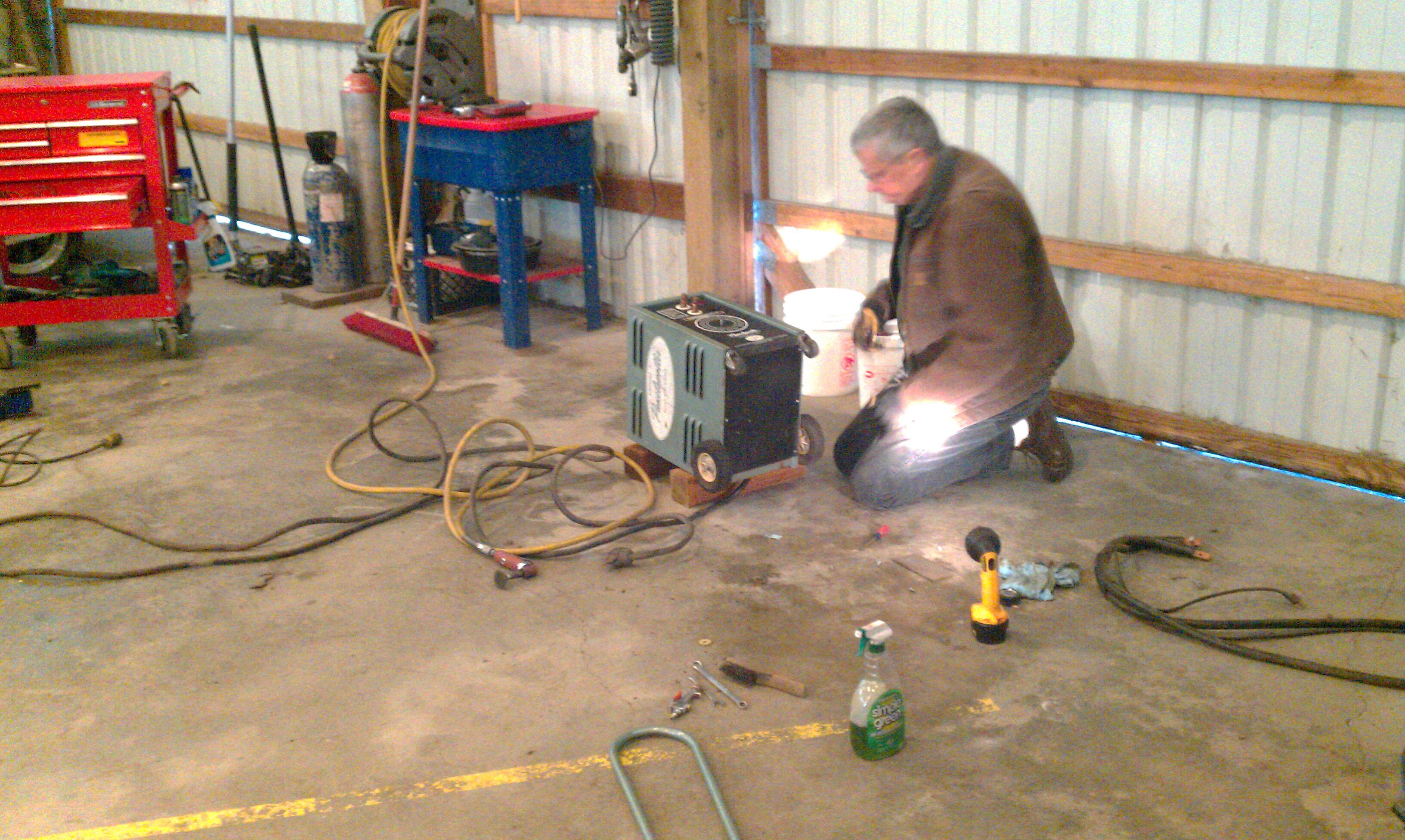

Here's a picture of the panel spotter being tidied up and the connections checked.

cary   Here's a picture of the panel spotter being ti...   Nov 14 2012, 08:12 AM
