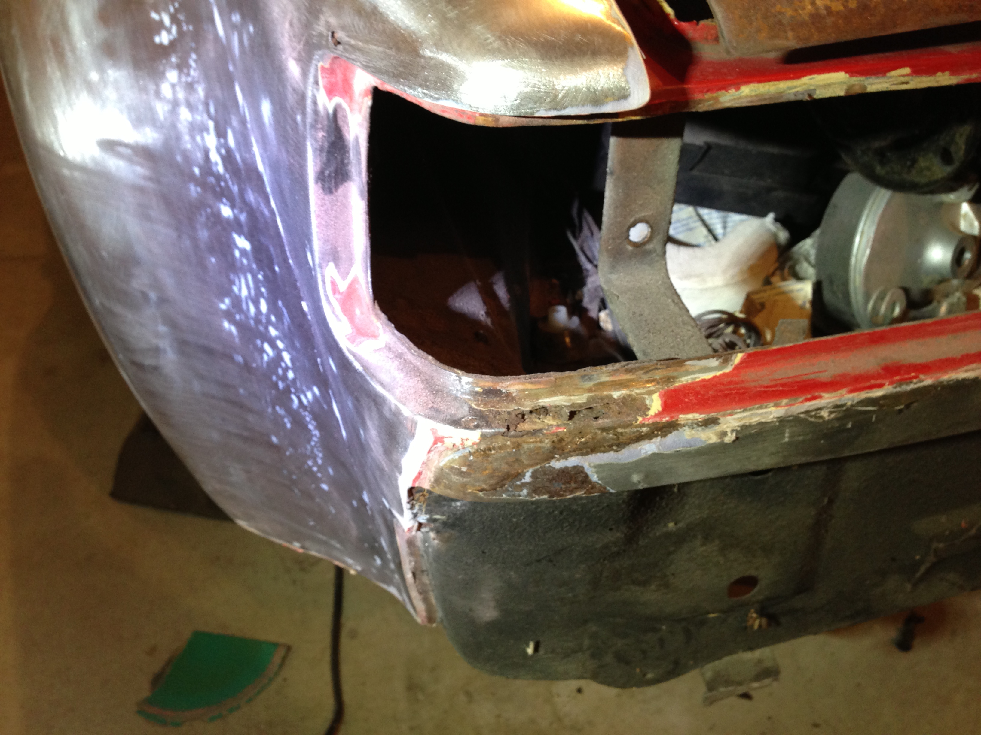

so i got a little lazy and only did about an hour og work on the car here is a few pics for updates pretty typical rust areas not really all that worried the rear half of the floor plan is going to be replaced..

ONTHEGRIND   this is the ugly part looks like the p/o hamme...   Nov 18 2012, 07:30 PM
ONTHEGRIND   firewall   Nov 18 2012, 07:30 PM
ONTHEGRIND   door jam had alot of bondo..   Nov 18 2012, 07:32 PM

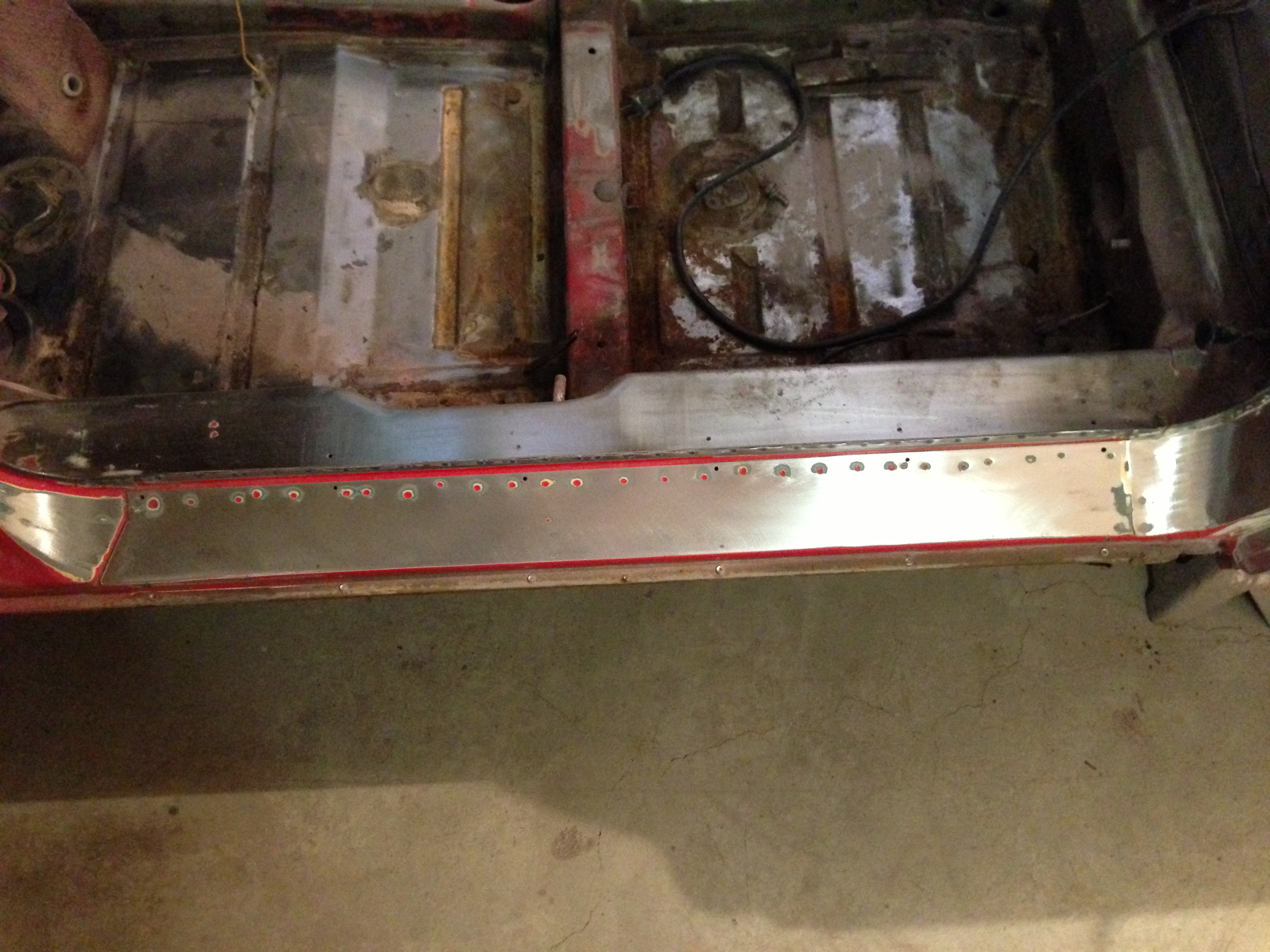

ONTHEGRIND   Stripped the good today and the left front 1/4 goi...   Nov 24 2012, 05:45 PM
ONTHEGRIND   one more   Nov 24 2012, 06:12 PM
Andyrew   What grit are you using to strip it? Looks like it...   Nov 24 2012, 07:31 PM
ONTHEGRIND   Using 3m green 80 grit 8 Inch disc on a soft pads ...   Nov 25 2012, 11:10 AM

SirAndy   Where is your bracing? :huh: I wouldn't rem...   Nov 26 2012, 12:43 AM
ONTHEGRIND   Was going fab up something at the shop tomarrow I ...   Nov 26 2012, 01:52 AM
sixnotfour   So where you work you have cellete bench is it th...   Nov 26 2012, 03:01 AM
ONTHEGRIND   Campbell ca...   Nov 26 2012, 08:33 AM
ONTHEGRIND   I was looking at door braces last night, I think I...   Nov 26 2012, 09:04 AM
r_towle   well. The front part hangs off a flexible area tha...   Nov 26 2012, 04:19 PM

SirAndy   Any pics ? A simple search for "+floor +br...   Nov 26 2012, 05:09 PM
ONTHEGRIND   I'm only removing the inner firewall skin you ...   Nov 26 2012, 04:32 PM
SirAndy   I'm only removing the inner firewall skin you ...   Nov 26 2012, 04:58 PM
