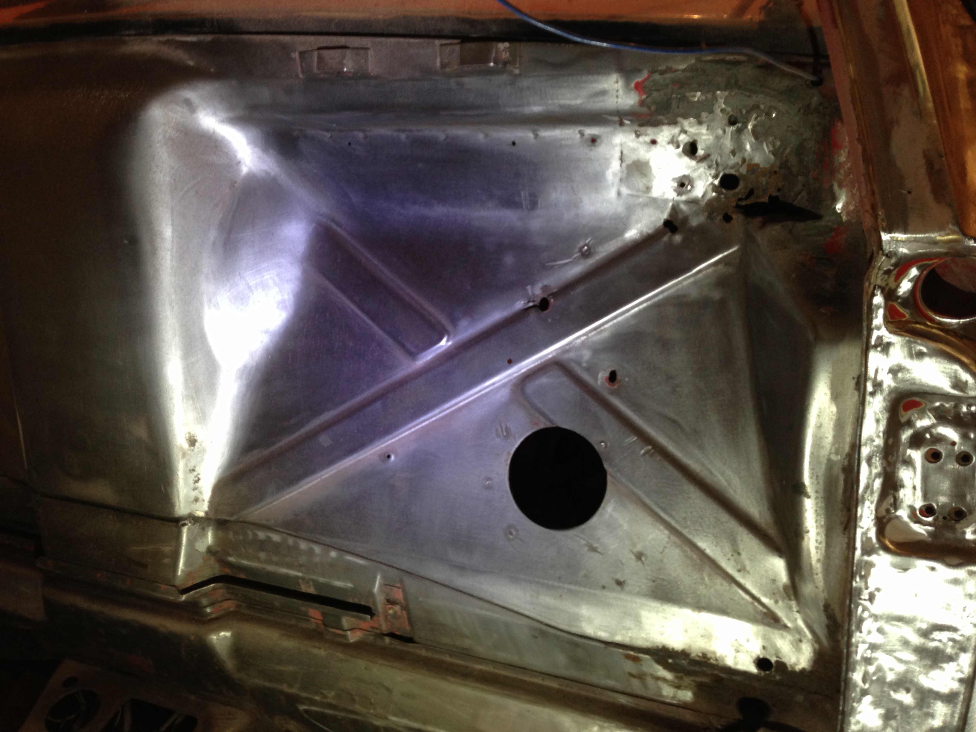

firewall

ONTHEGRIND   this is the ugly part looks like the p/o hamme...   Nov 18 2012, 07:30 PM
ONTHEGRIND   firewall   Nov 18 2012, 07:30 PM
