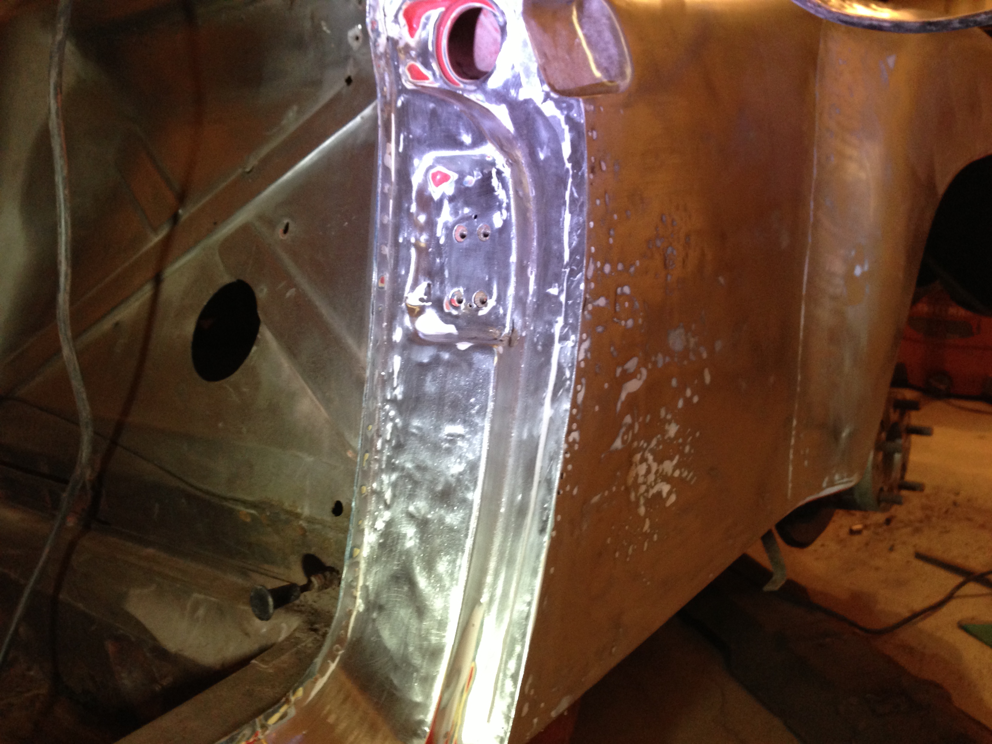

door jam had alot of bondo..

Andyrew   The flares look just sub par of a good body tech, ...   Nov 16 2012, 02:47 PM
ONTHEGRIND   Unfortunately I'm not a body guy but I do happ...   Nov 16 2012, 03:04 PM
ONTHEGRIND   Yeah I was just looking for rust gonna hammer and ...   Nov 16 2012, 03:07 PM

ONTHEGRIND   so i got a little lazy and only did about an h...   Nov 18 2012, 07:25 PM
ONTHEGRIND   this is the ugly part looks like the p/o hamme...   Nov 18 2012, 07:30 PM

ONTHEGRIND   door jam had alot of bondo..   Nov 18 2012, 07:32 PM
