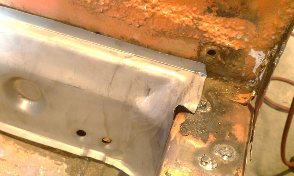

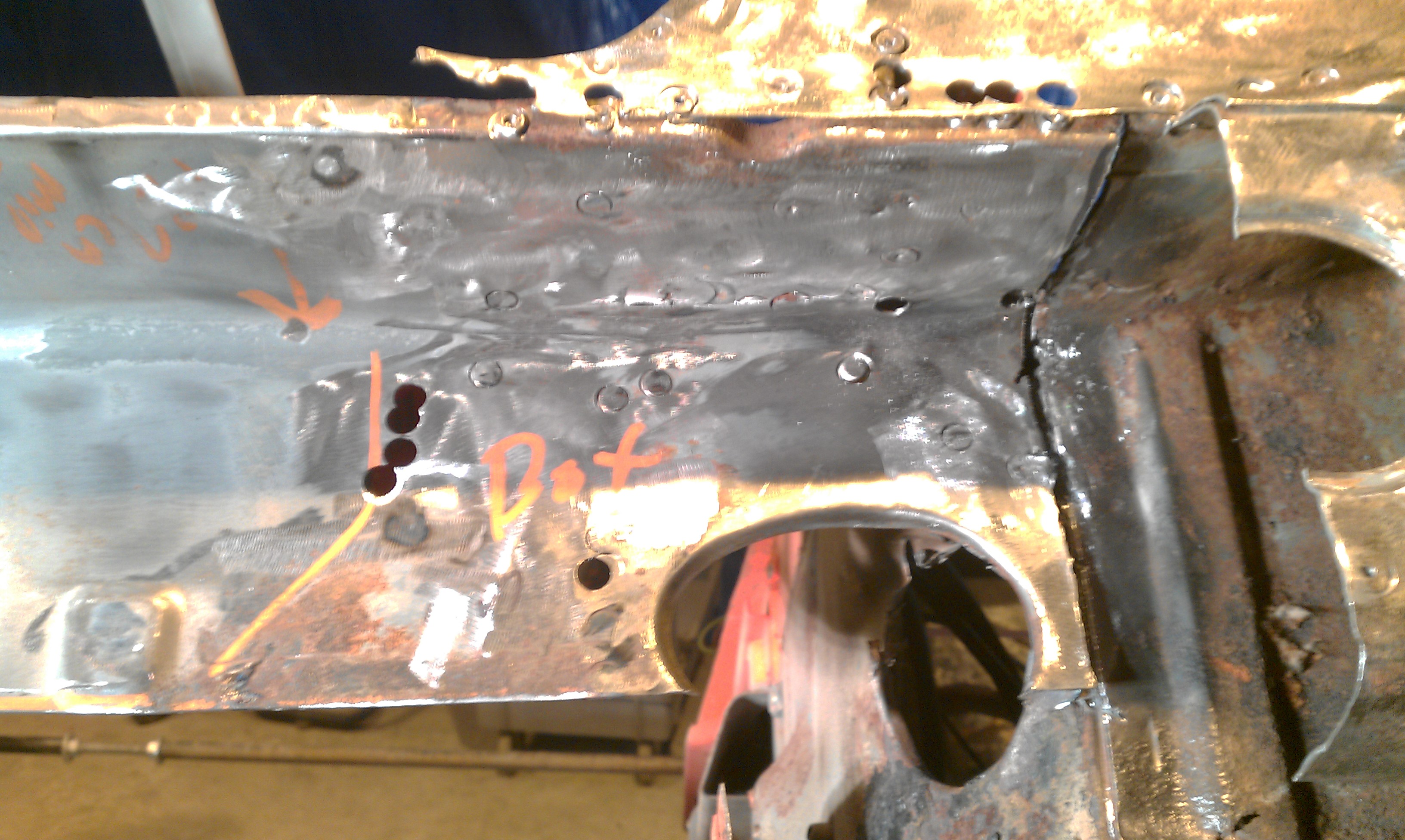

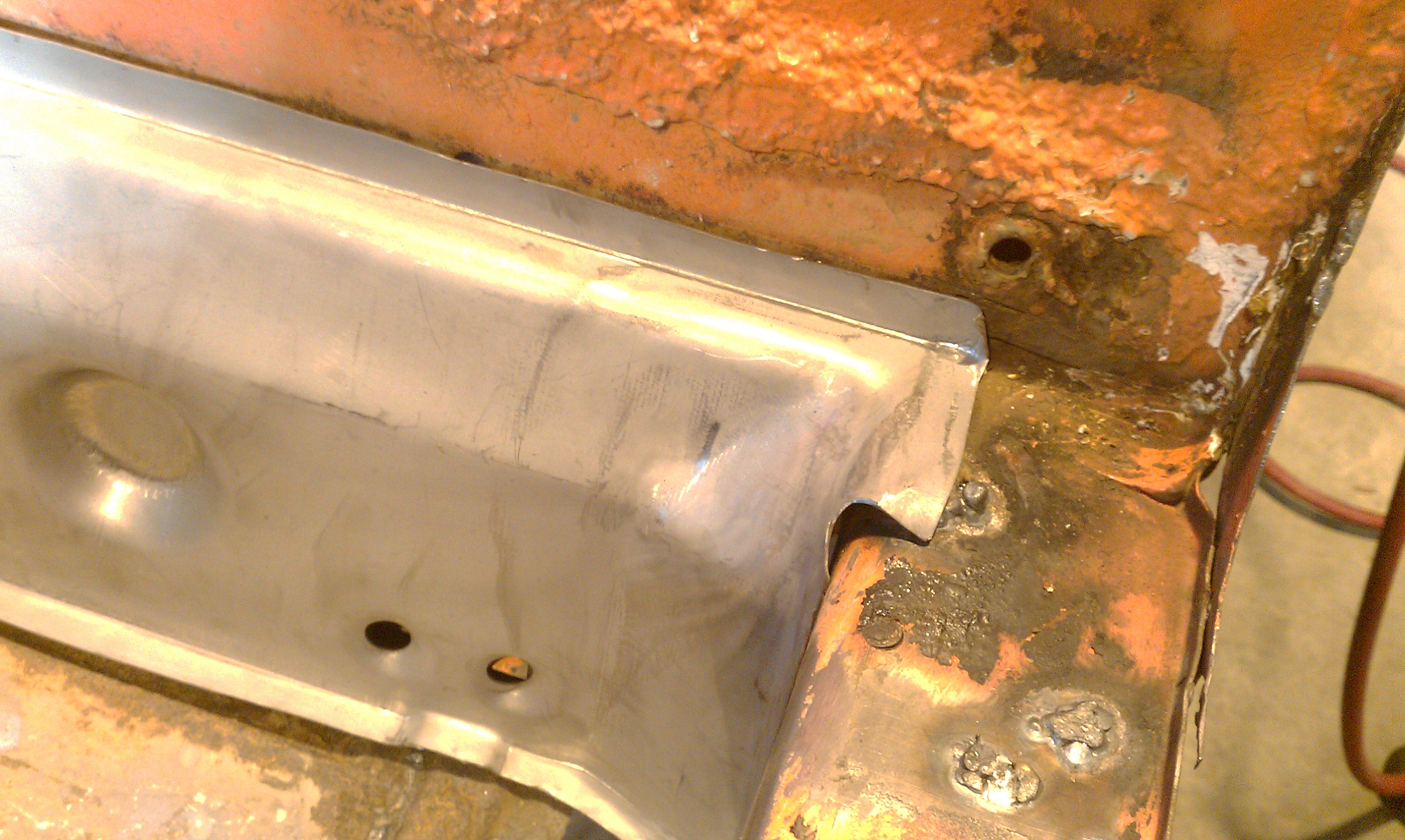

cary   Well decided against moving on to the passenger lo...   Nov 19 2012, 09:23 PM
cary   So I moved on the recreating the bottom corner of ...   Nov 19 2012, 09:32 PM
cary   Here's where we start. This is going to tak...   Nov 19 2012, 09:37 PM
cary   Using some of Mark's work as a pattern. I...   Nov 19 2012, 09:41 PM
cary   First attempt with the shrinker we made the apex o...   Nov 19 2012, 09:46 PM
