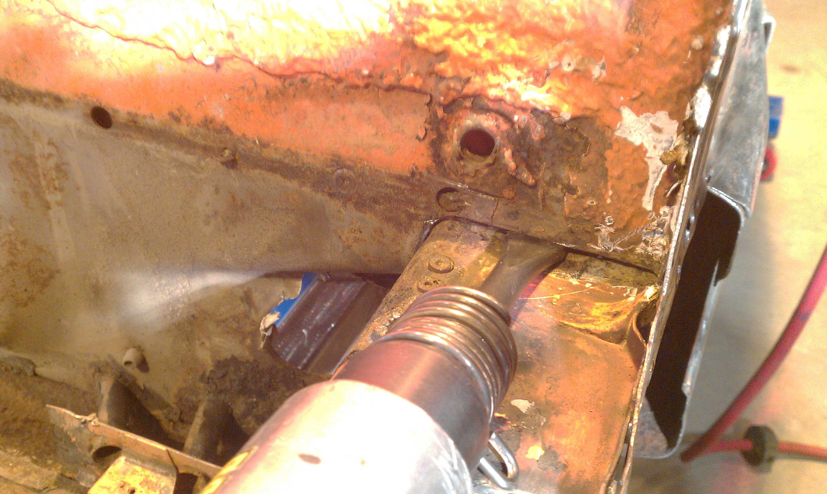

Now to disconnect the firewall/hell hole ....................
Air chisel takes a little practice to use. It can tear stuff up pretty fast.

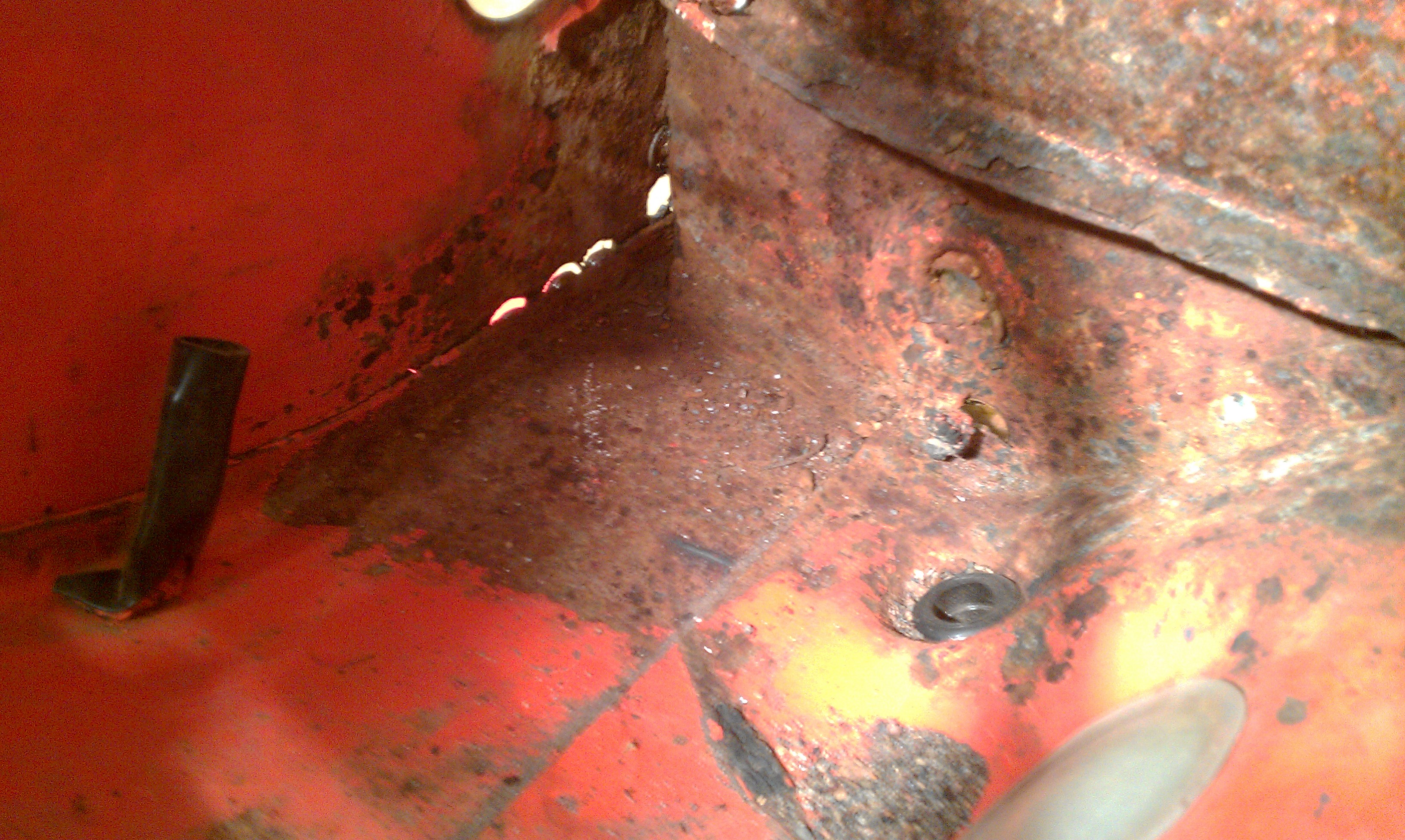

cary   Now for the bad news. I didn't look at the pas...   Nov 18 2012, 08:52 PM
