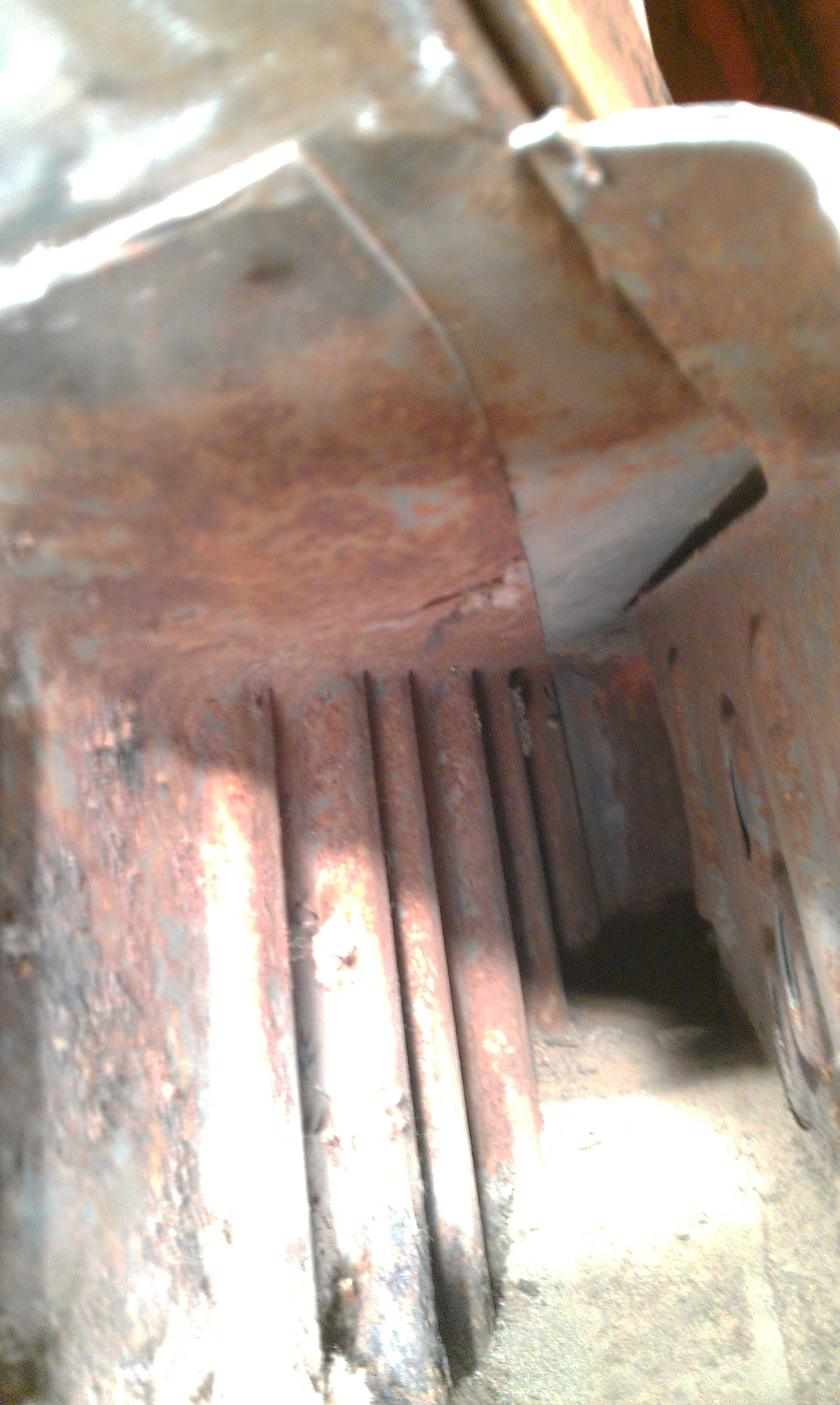

cary
post Nov 18 2012, 08:33 PM
Posts: 3,900
Joined: 26-January 04
From: Sherwood Oregon
Member No.: 1,608
Here's a shot up the rear suspension long.
Showing the inner box stiffener.

cary   Here's a shot up the rear suspension long. Sho...   Nov 18 2012, 08:33 PM
