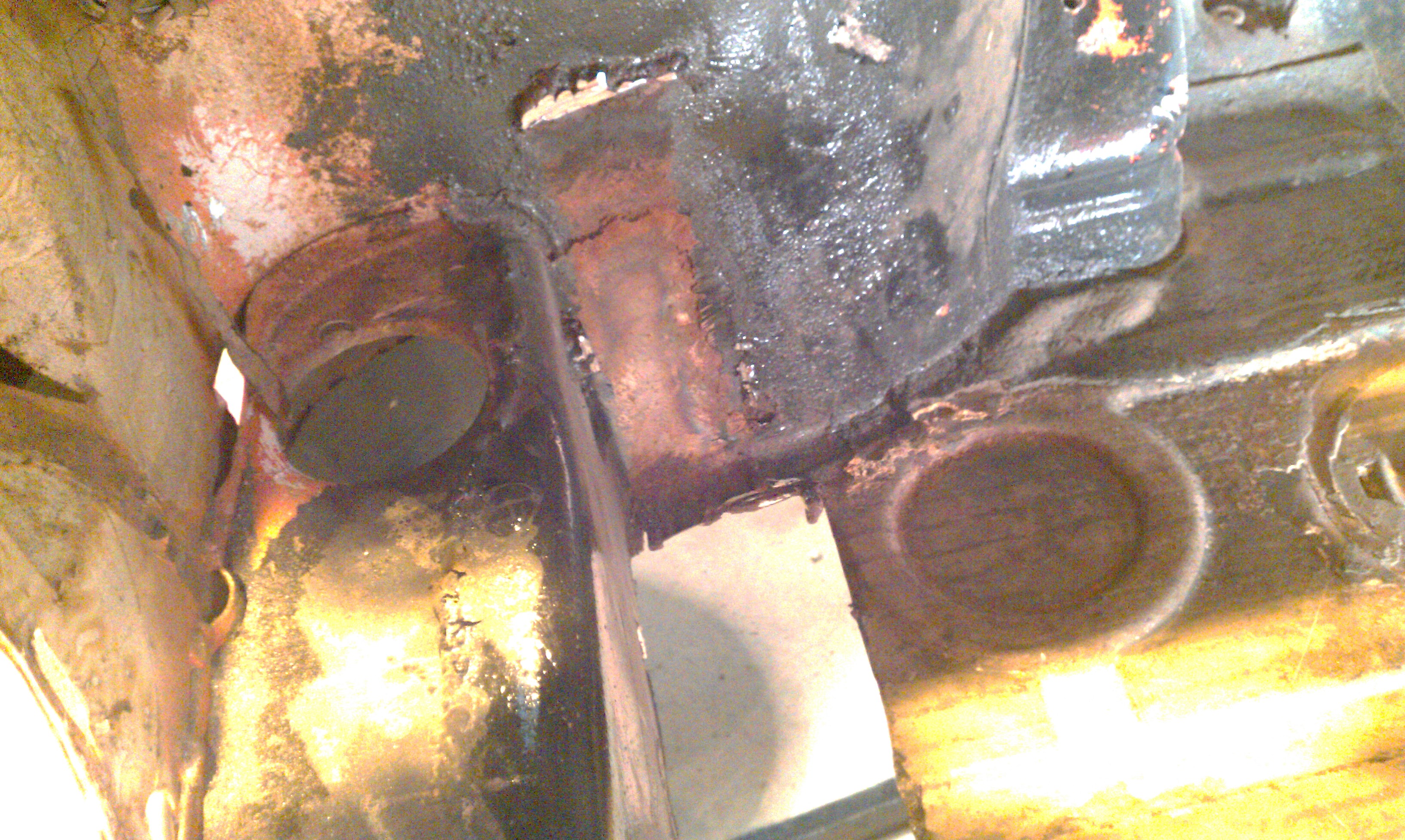

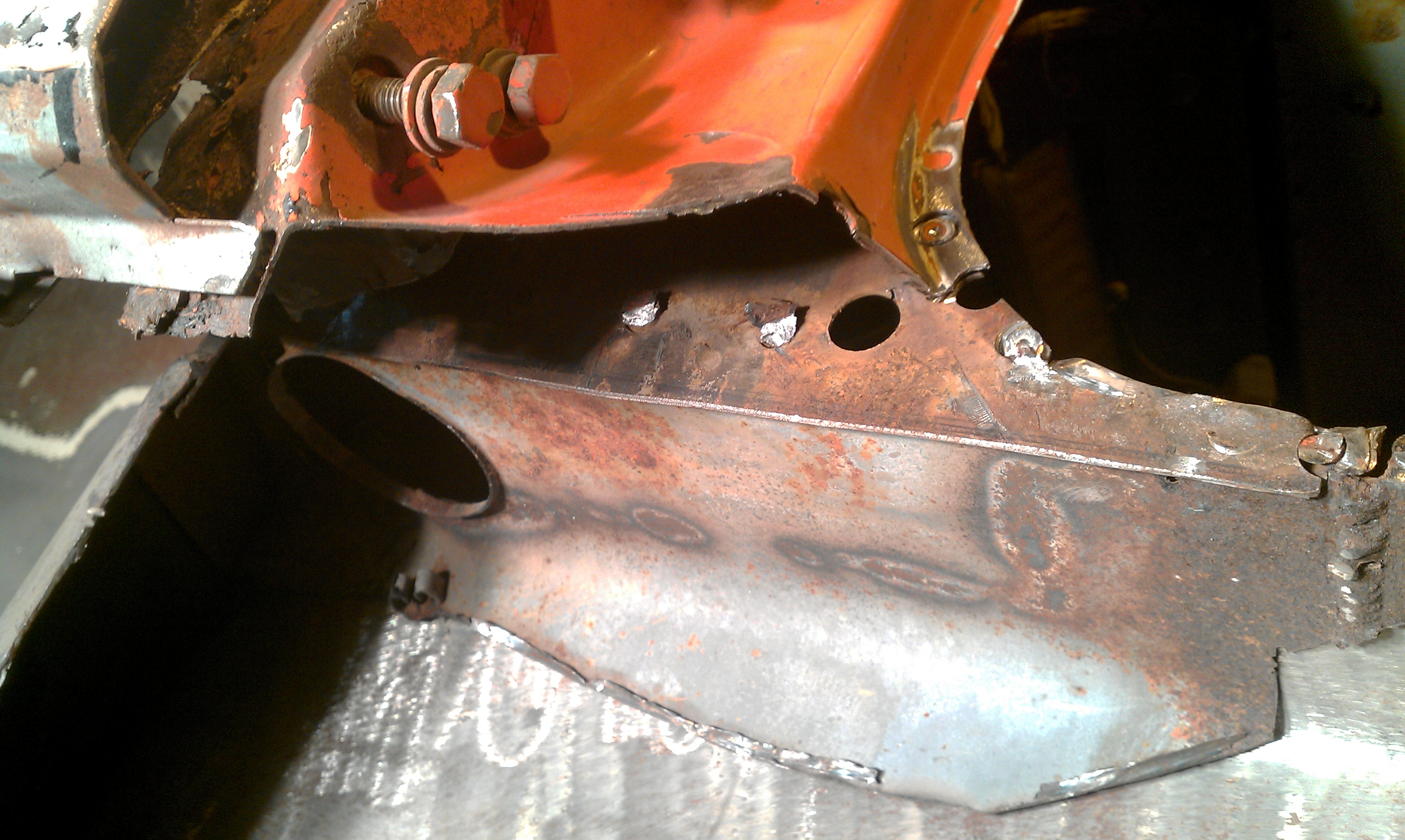

Now for the front end.
Outside shot.
Inside shot.

cary   Now for the front end. Outside shot. Inside ...   Nov 18 2012, 08:36 PM
cary   Now 3 1/2 hours later ................   Nov 18 2012, 08:39 PM
