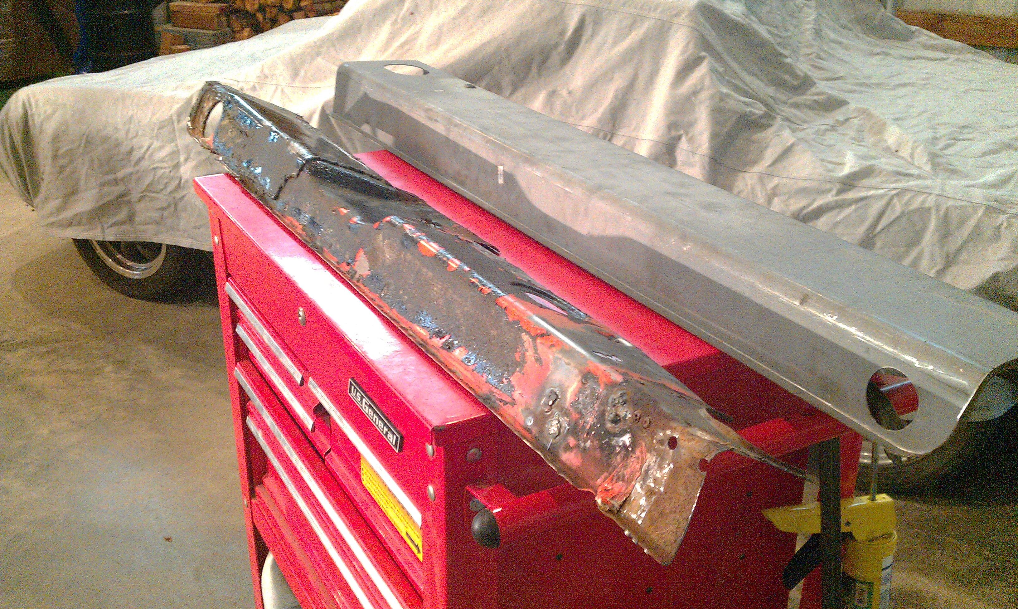

cary   The more I look at that drivers long. The more I...   Nov 11 2012, 11:04 PM
cary   Here's a picture of the panel spotter being ti...   Nov 14 2012, 08:12 AM
cary   I decided an amputation is in order. Heading to th...   Nov 18 2012, 09:43 AM
cary   Well whats the going rate on a 3 1/2 hour surgery?...   Nov 18 2012, 08:21 PM
