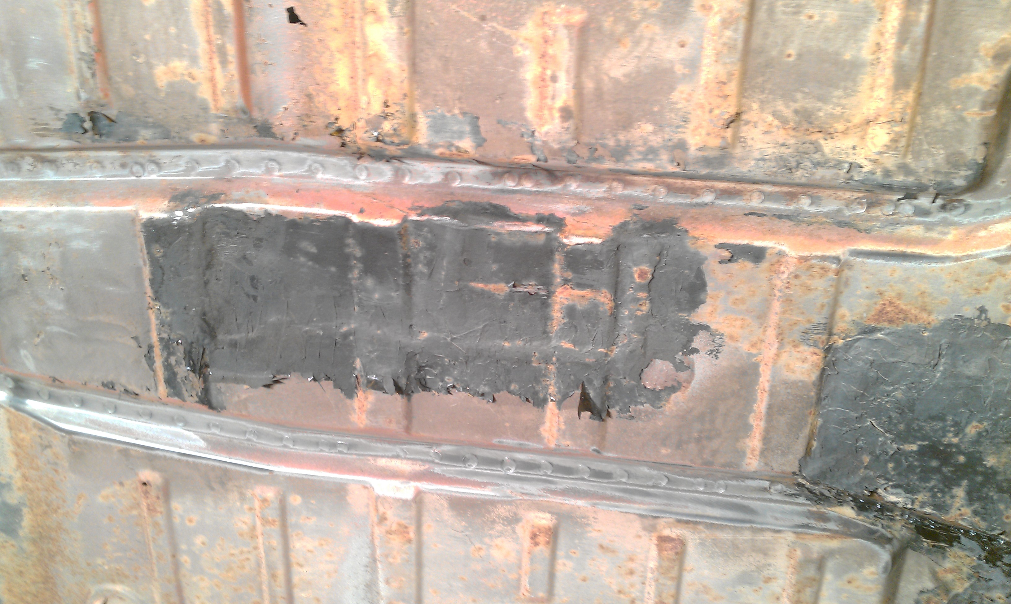

So on to the floor pan removal.

cary   So on to the floor pan removal.   Nov 18 2012, 08:55 PM

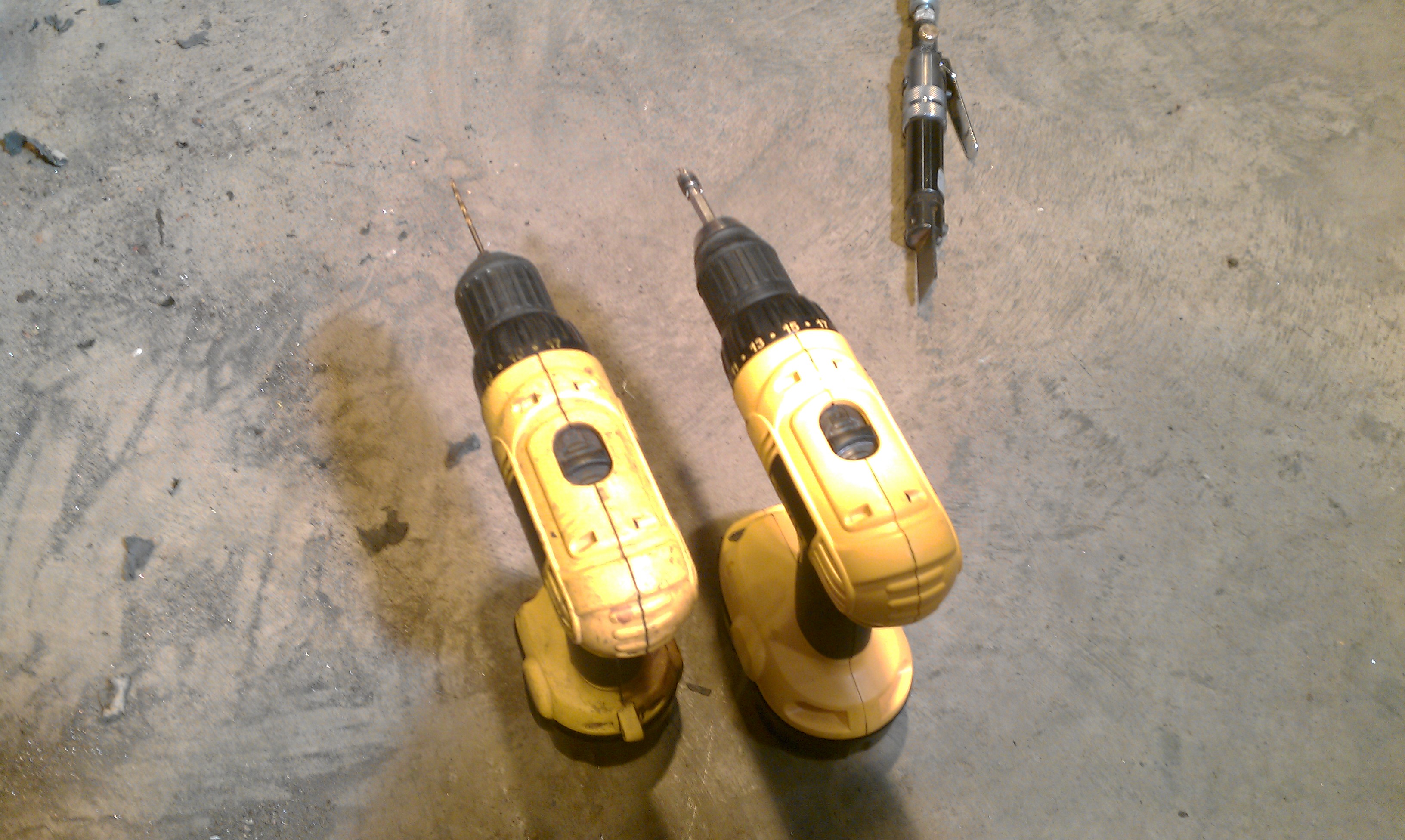

wingnut86   Cary, Who did you buy your spot weld drill bits f...   Nov 19 2012, 05:41 AM
cary   HF...................... http://www.harborfreight....   Nov 19 2012, 08:47 AM
