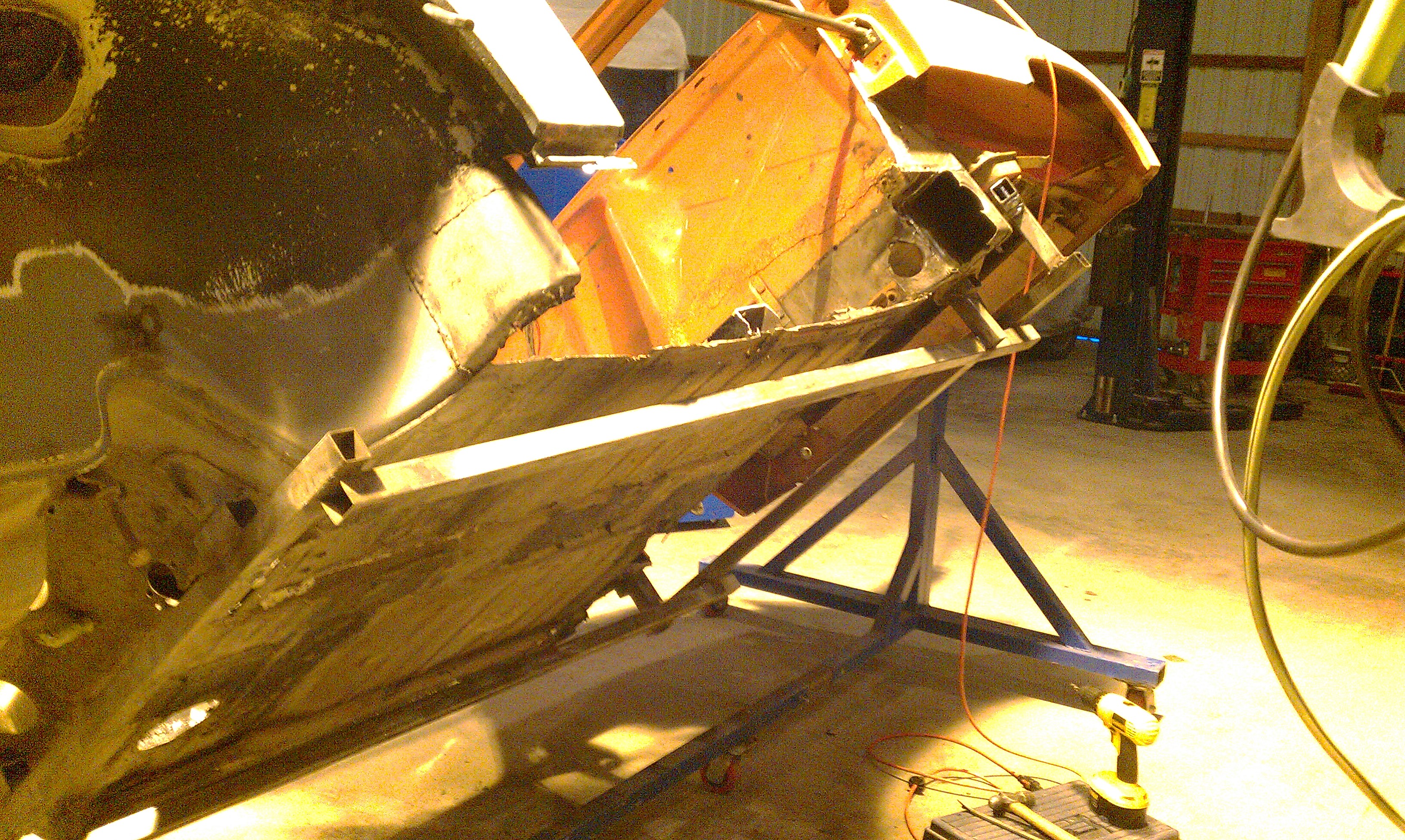

cary   Here's the floor pan on the rotisserie.   Jun 6 2012, 10:45 PM

cary   So on to the floor pan removal.   Nov 18 2012, 08:55 PM
