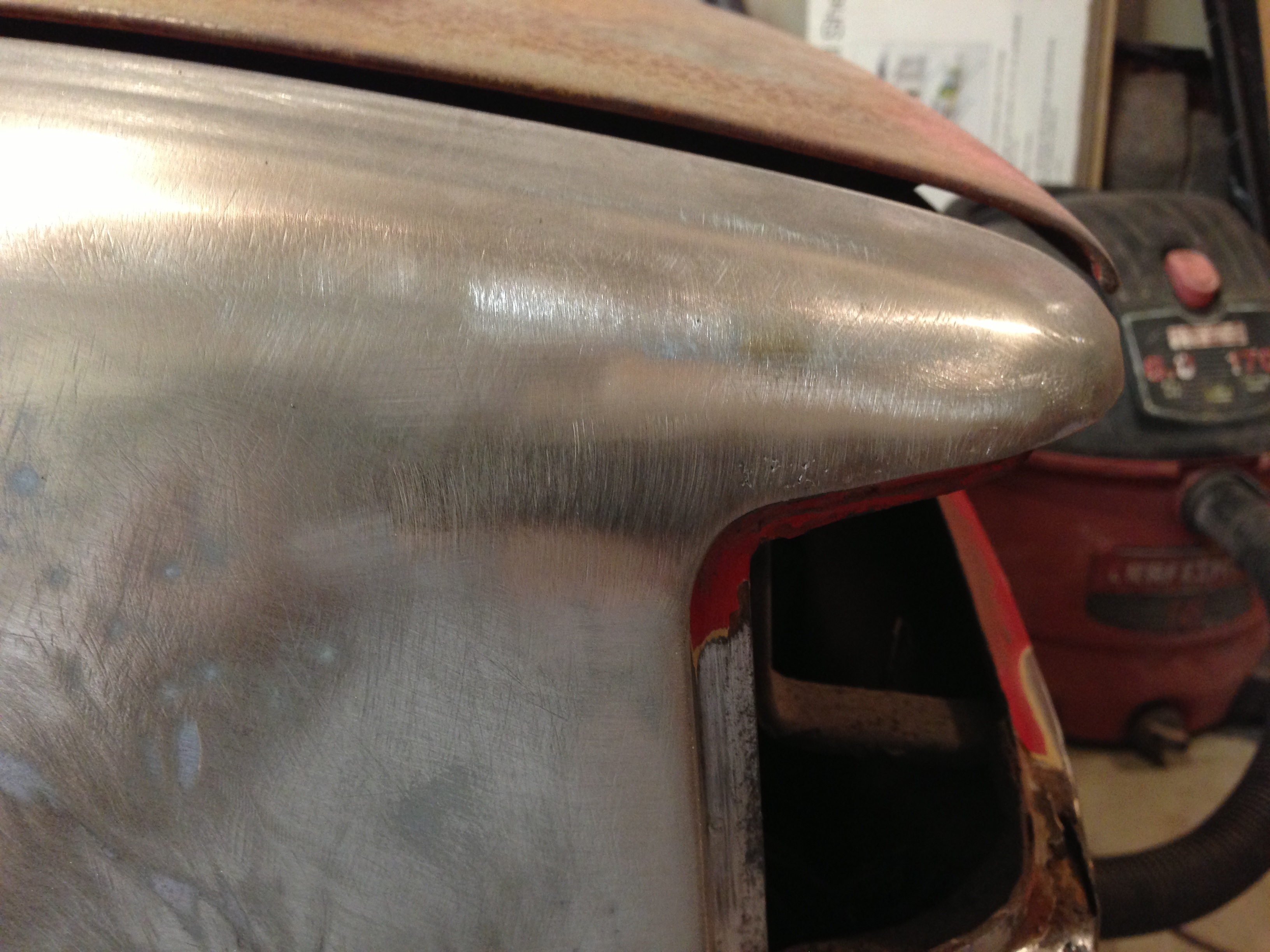

Going to widen the rear flare and repaint looks like a little more work then expected

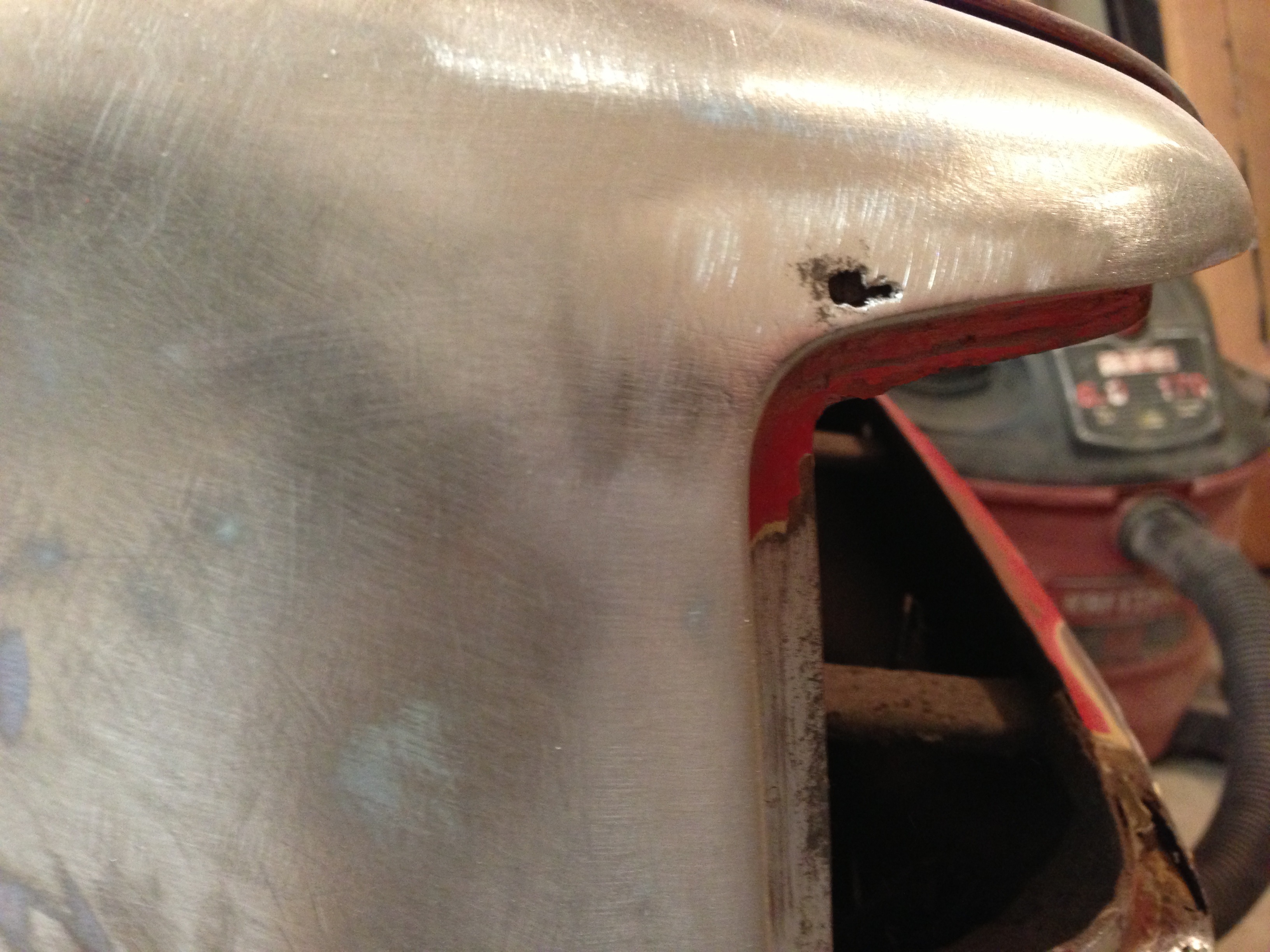

Little rust repair

ONTHEGRIND   so i got a little lazy and only did about an h...   Nov 18 2012, 07:25 PM
ONTHEGRIND   this is the ugly part looks like the p/o hamme...   Nov 18 2012, 07:30 PM

ONTHEGRIND   Little rust repair   Nov 19 2012, 09:28 AM
