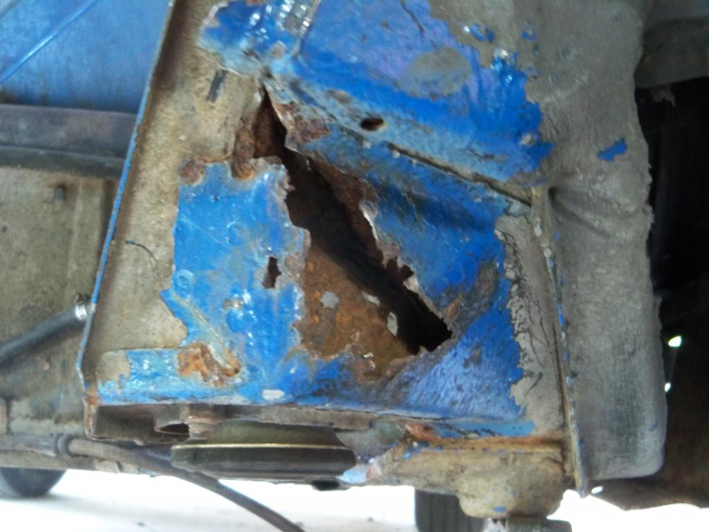

So I dropped the motor and what do I see?:
(IMG:http://www.914world.com/bbs2/uploads_offsite/i366.photobucket.com-10819-1290372313.1.jpg)
Can I just re-weld this, or do I need to remove the whole piece and put in a new one?
I suppose I should do both sides while I am at it?
Any suggestions?
Stu

Looks like Im a bit late to this party, but having done a few of these myself, Id renew the caution that the rust is most likely from inside out & you might want to poke around a bit more before respraying it.
this looked solid prior to smacking it with a hammer a couple times.

Travis Neff   I wouldn't weld it back up, replace it. Troub...   Nov 21 2010, 03:07 PM

stugray   OK replace then. I have a plasma cutter & MIG...   Nov 21 2010, 04:56 PM
